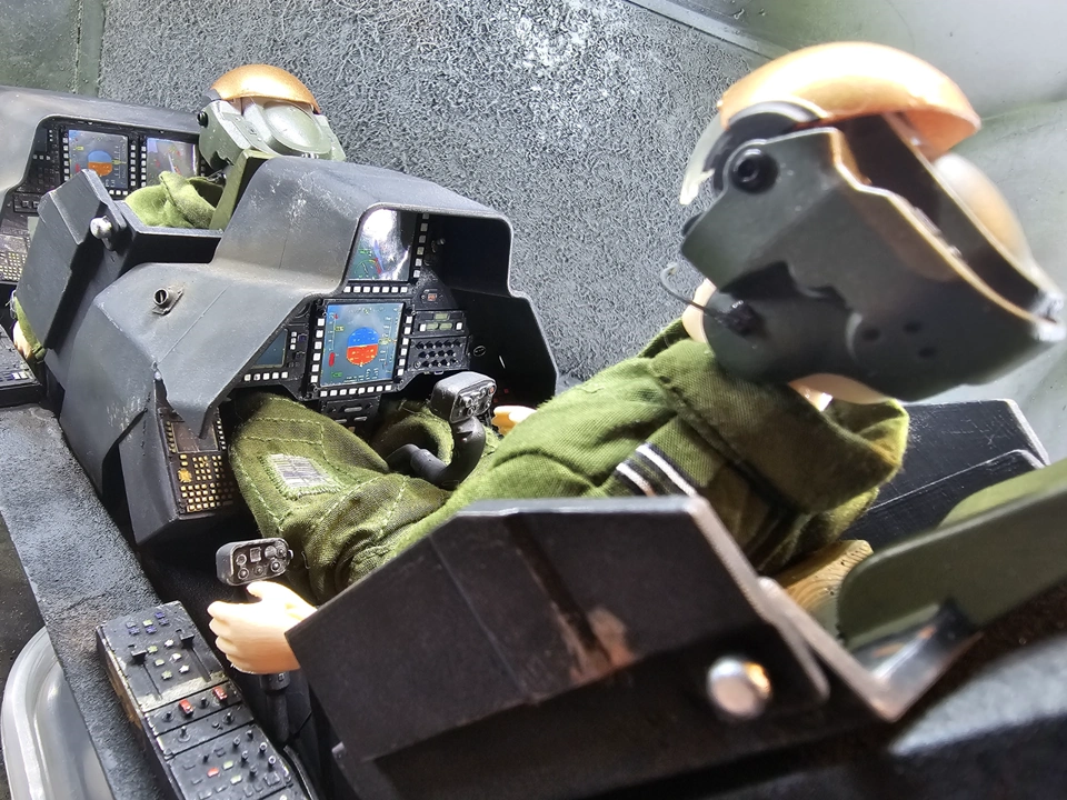

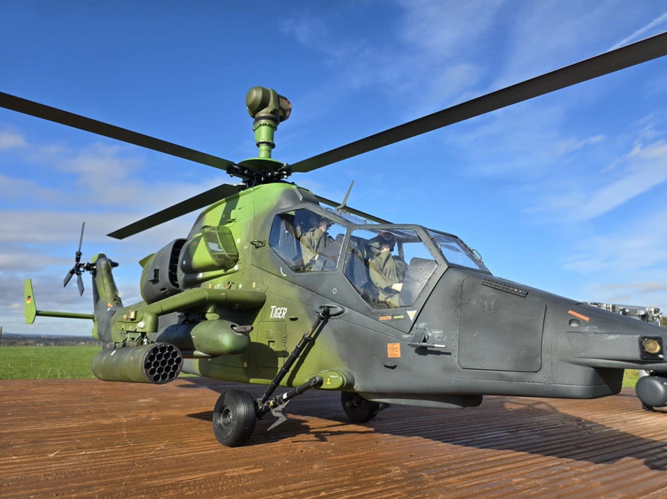

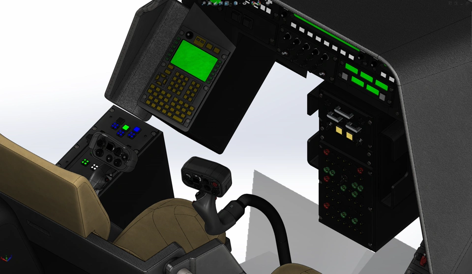

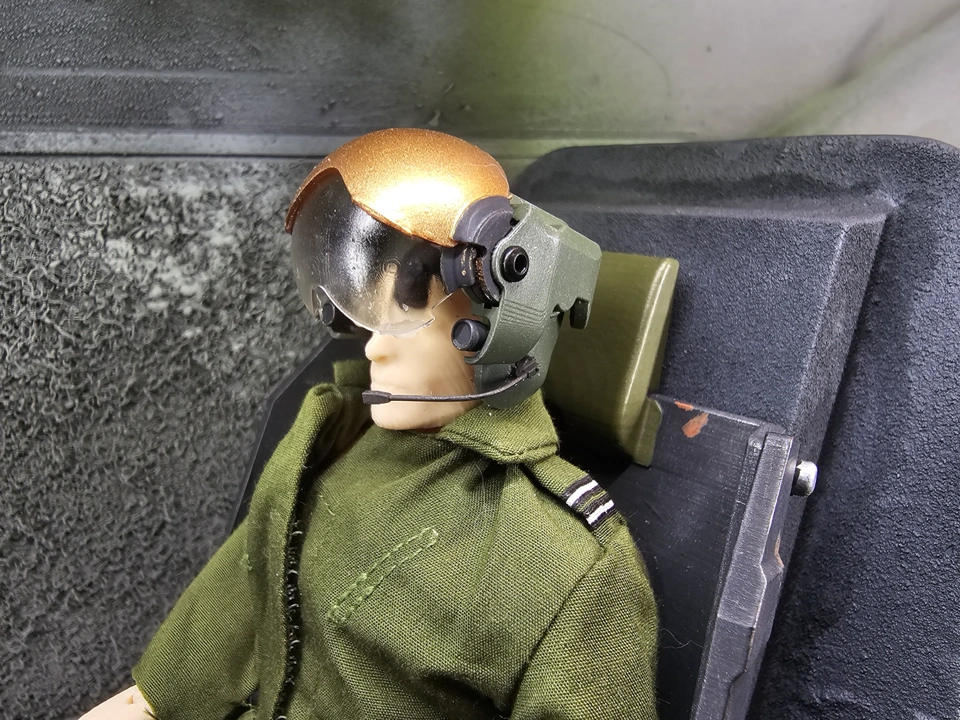

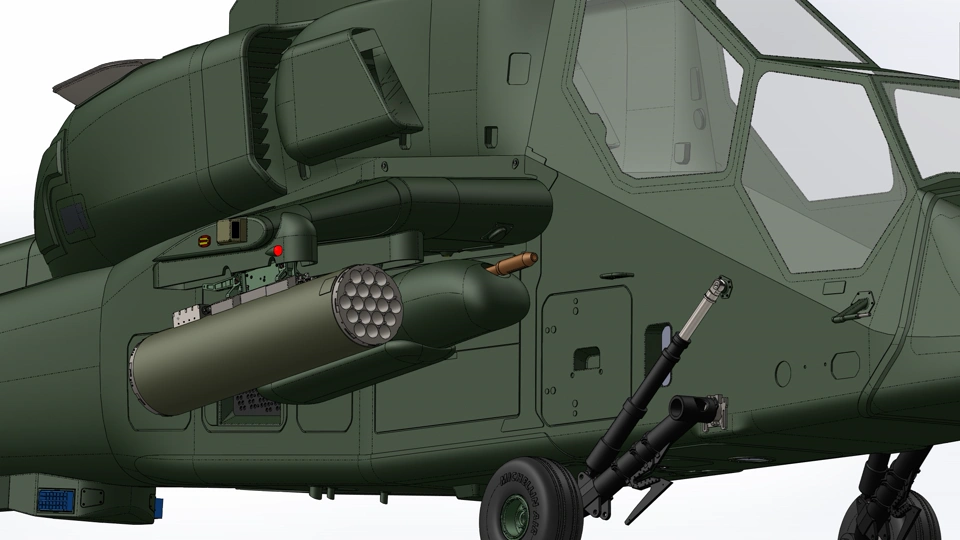

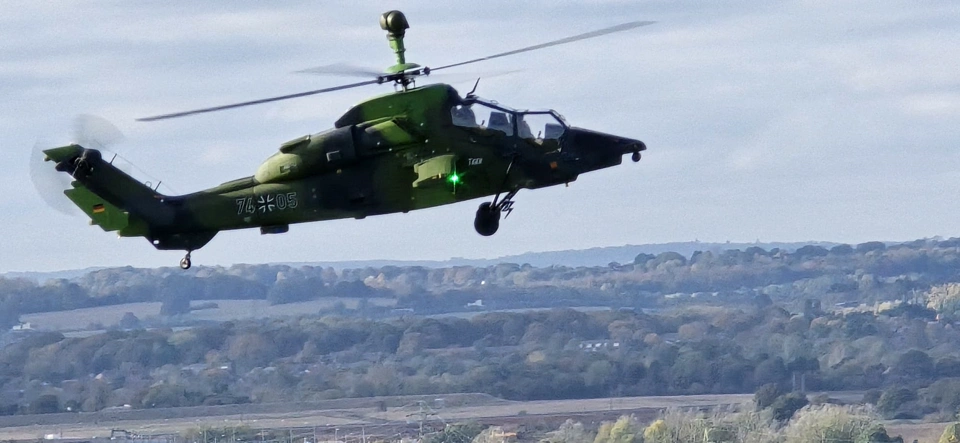

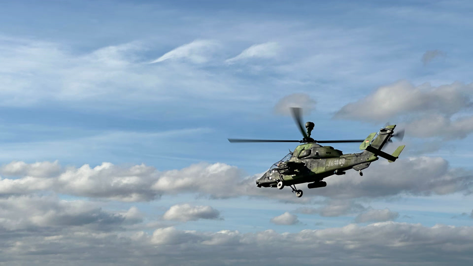

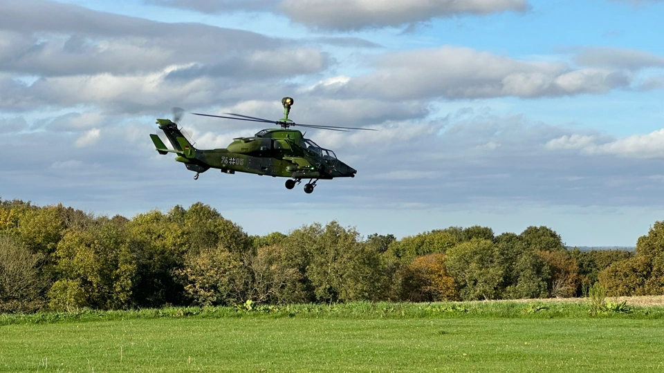

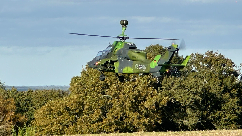

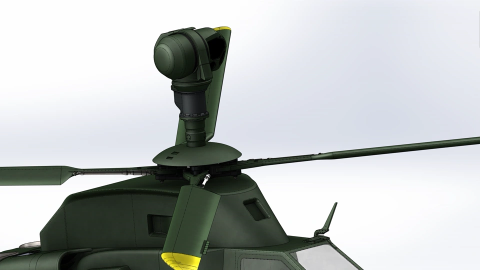

1/8 model of Eurocopter Tiger - 4 year on-and-off project (more off) done in SolidWorks Maker Edition,

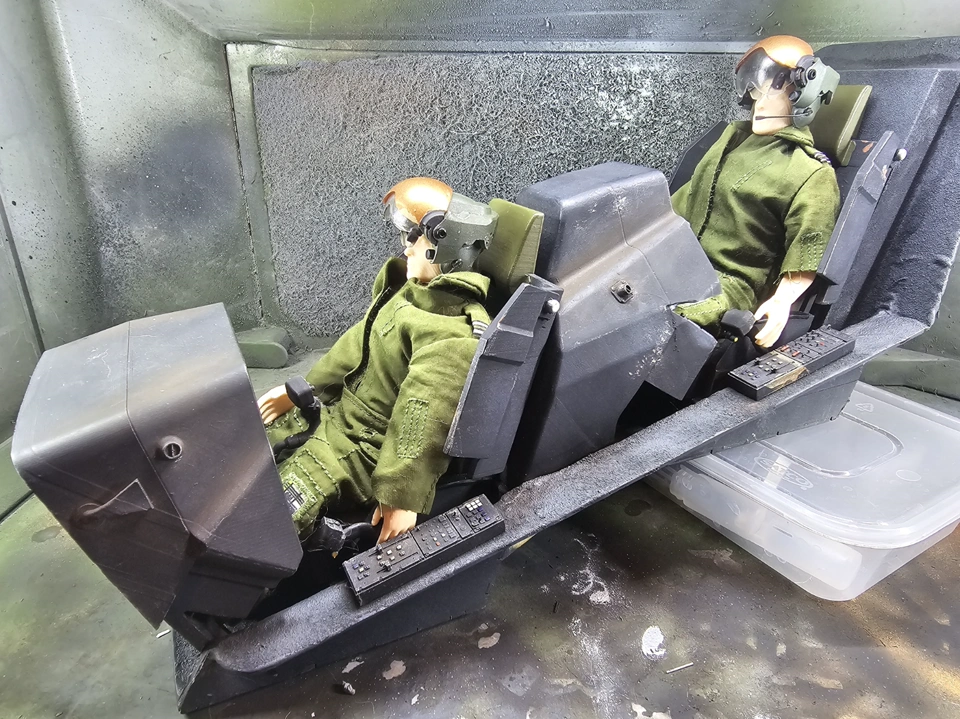

The fuselage sections were 3D printed in Glass Fibre enhanced ABS and ASA (BambuLab X1C and custom build Voron 2.4)
The small scale parts in resin (Elegoo Mars 3)
The helicopter runs on 4kW electric motor @ 44V 140A peak (Kontronik Pyro motor and Kolibri ESC)
Mechanics are from German and Swiss vendors (PSG Dynamics, Helicopter Baumann, Vario Helicopters)
Custom Aluminium blades were provided by M-Blades
More photos and renders of the projects bellow:

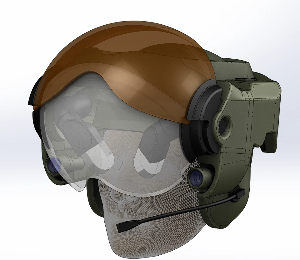

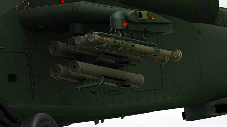

And the renders
