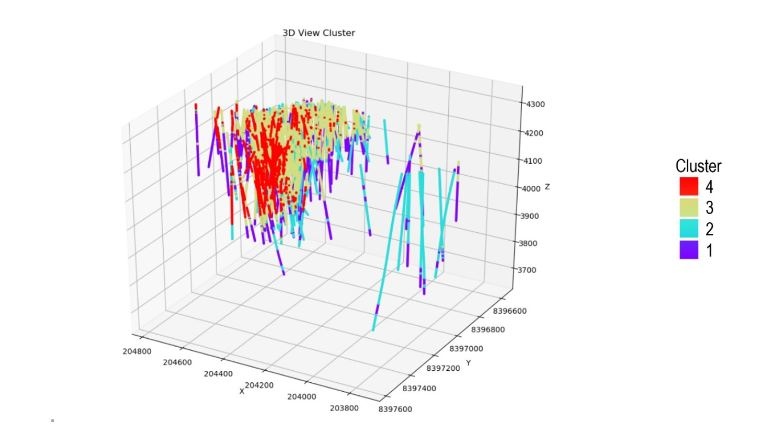

We devised a test case for a porphyry-skarn deposit (copper, gold, silver, etc) in Peru to illustrate how ML can work in domain separation. The datasets consisted of 32,711 composites comprising 35 variables derived from 273 drill holes, including minerals grade, lithology, alteration, and various geochemical factors.
The main challenge for estimation at this mine was the potential for economic loss caused by improper domain, which could lead to underestimating high-grade minerals. To address this challenge, we employed a clustering algorithm. This algorithm incorporated the geostatistical Mahalanobis distance function instead of Euclidean distance, which meant that it not only considered variograms of key properties, it also factored-in cross variograms among copper, gold, silver and geochemical variables.
Figure 1 shows the results of applying this approach: four separate domains, each represented by a different colour.
Figure 1. Display of clusters of copper domain considering coordinates, drillhole data of all variables, and lithology.
Note that, unlike traditional domaining methods, this approach identified some transition layers (part of domain 4 in domain 3) within the skarn (domain 3 and domain 4). You can also see here that, by recognising the pattern and relation between geochemical properties and copper grade, the ML model effectively pinpointed the high-grade zone and generated a clear boundary between domain 3 and domain 4.

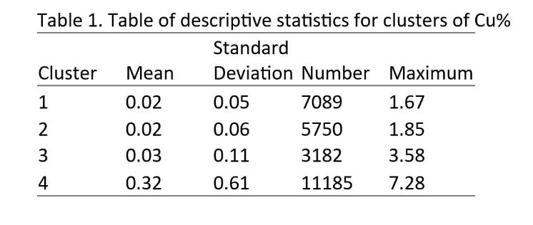

In Table 1, cluster 4 stands out statistically due to its high-average sample grade (0.32) and its maximum sample grade (7.28).

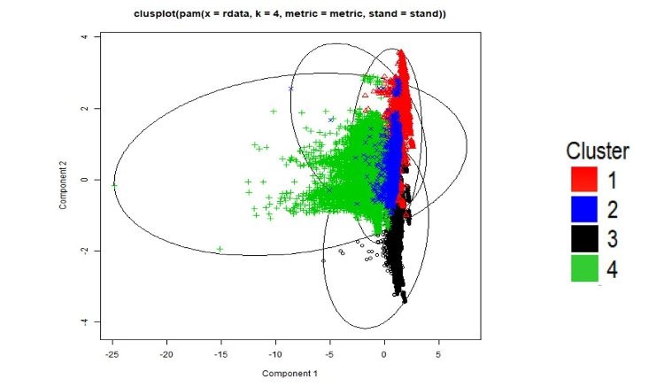

To validate the relevance of the four clusters and identify if there was any redundancy among the domains, we conducted a principal component analysis in two dimensions representing combinations of geochemical properties.
Figure 2. Principle component analysis score of two components from datasets.
The result was that, by increasing confidence in identifying domains, we were able to integrate up to one per cent more economic grade into the main lithology domain. In addition, this streamlined process took mere minutes from start to finish, instead of the weeks required for traditional domaining.

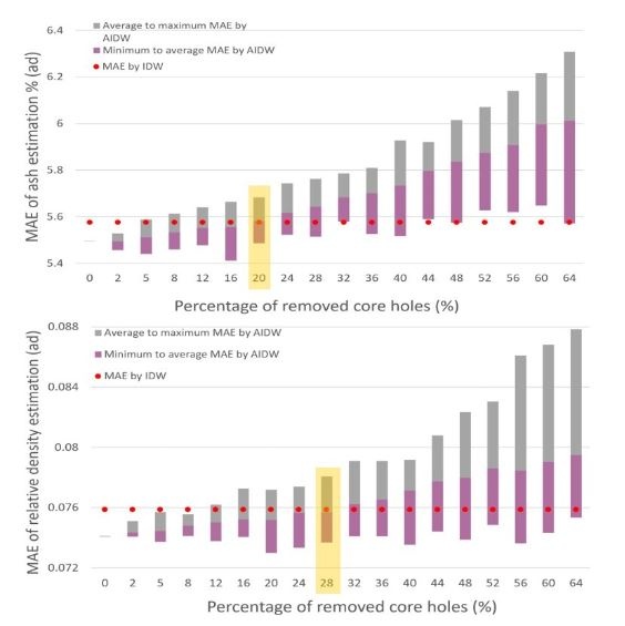

  • Figure 3, below, depicts the percentage of drillhole removal for our baseline resource modeling scenario (using only core samples). At the starting point, with no core holes dropped, you can see that using all assay data and pseudo samples in estimation resulted in a lower MAE than the base case. And for ash content and relative density specifically, our case study showed that a reduction in core hole drilling of approximately 20% (59 holes removed out of 297 core holes) and 28% (83 holes removed out of 296 core holes) respectively could be achieved while maintaining the same MAE as the base case.
Figure 3. MAE of ash (top) and relative density (bottom) estimation with percentage of core hole reduction.The red dots represent a base case that only uses the core hole data. For each reduction percentage, we ran 100 cases with random dropping pattern. This bar covers the range of MAE. And the boundary of two colors is the mean MAE.
