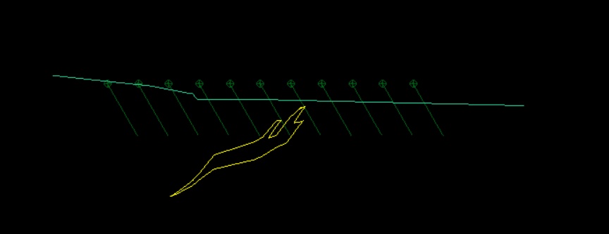

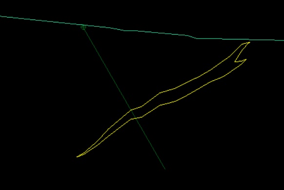

Drillhole Planning on section from the Surface: Create One Drillhole.

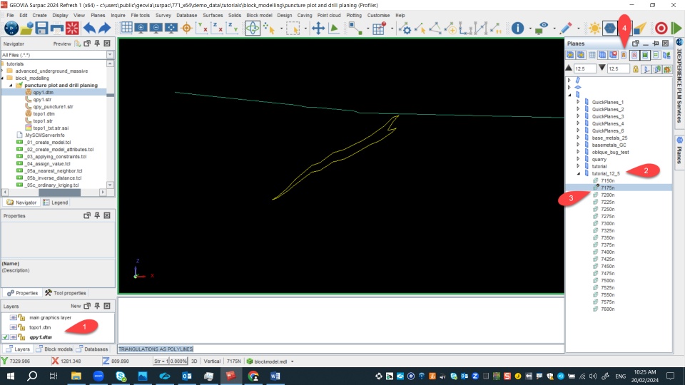

  • Open up the wireframes that are to be used for drillhole planning.
  • Create a set of Planes.
  • Set the plane that drilling is to be planned on.
  • Draw triangles as polylines.

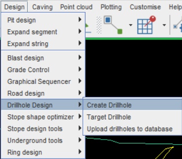

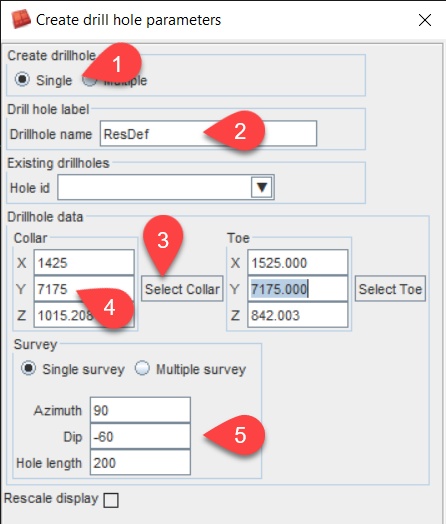

  • Design > Drillhole Design > Create Drillhole.
  • Select the “single” option.
  • Enter the name of the drillhole.
  • Press the “select collar” button and click on the location of the collar.
  • Enter in the northing, azimuth, dip and length of the drillhole.
  • Press the “create” button and close the form.
A single hole will be created in the layer called “Drill Hole Layer.”

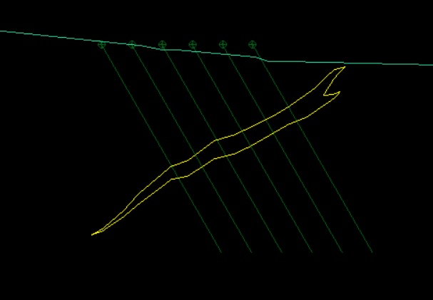

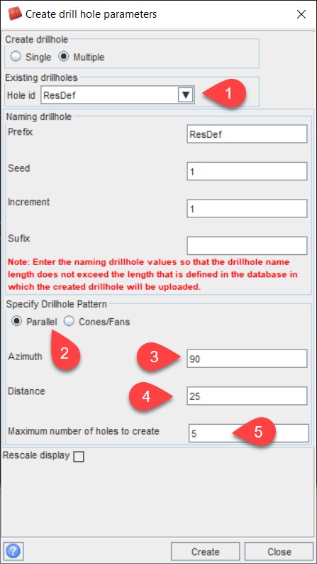

Drillhole Planning on Section from Surface: Create Several Holes at Set Distances
If several holes are to be created on this section, then a single hole must be created first.
  • Then reactivate the function and select “multiple.”
  • Use the drop down arrow and select the Drillhole Name that was previously used. The “Prefex” will automatically be created.
  • Select the Parallel option.
  • Enter in the azimuth, distance between collars and the number of holes to be created. The Dip and Length are copied from the previous hole.
  • Press the “Create button”, then close the form. You will see all the holes have been created.
  • The drillholes will be created in a layer called “Drillhole Layer.”

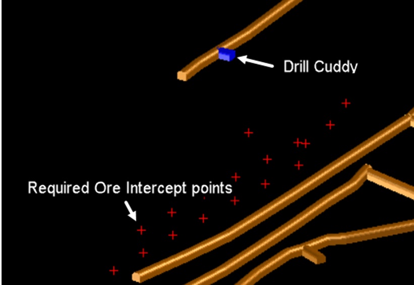

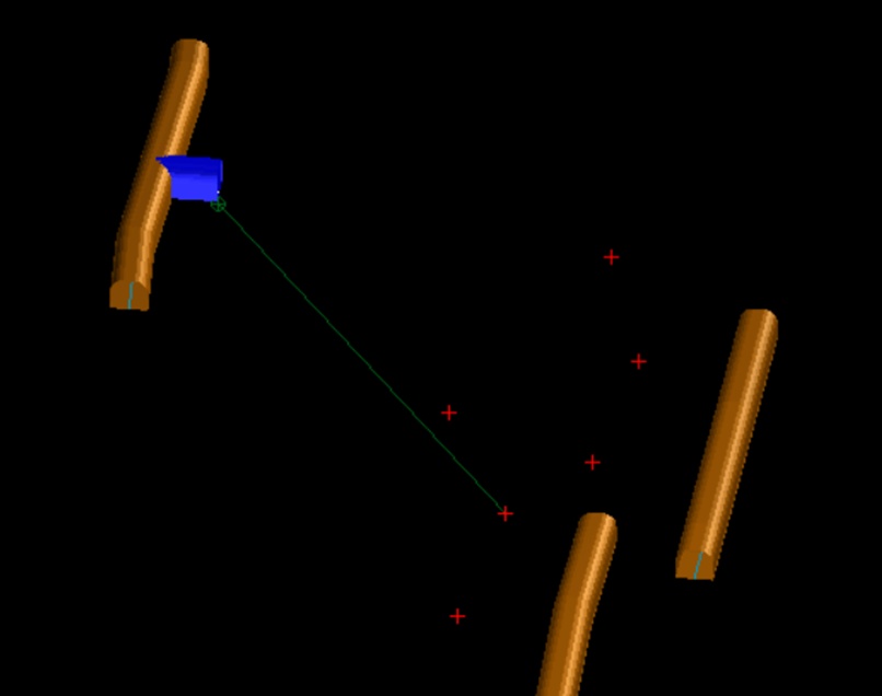

Drillhole Planning on Section from Underground Drill Cuddy: Create One Drillhole
  • Open up the development with the drill cuddy and the string file with the ore intercept points required.
  • Create a Plane for the section where the drill cuddy is.

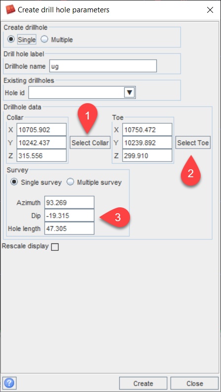

  • Press the “select toe” button and click on the location of the ore intercept.
  • Round off dip, azimuth and length if required.

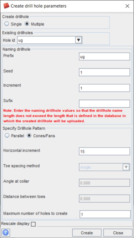

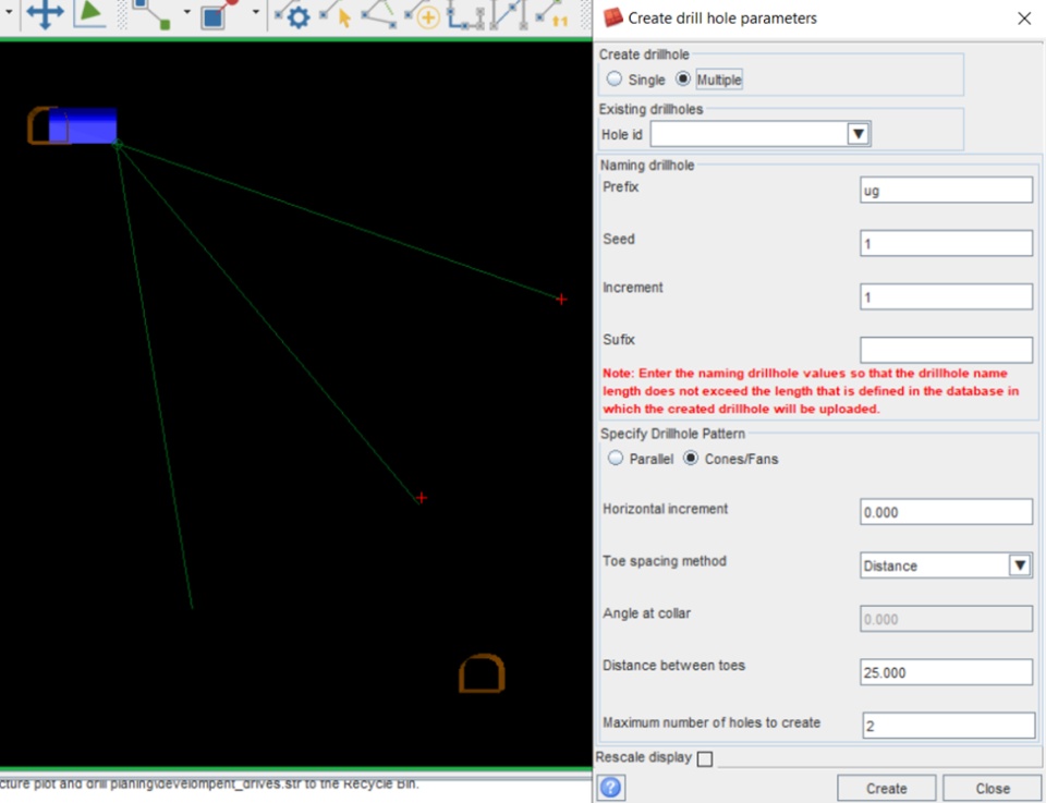

Drillhole Planning on Section from Underground: Create Multiple Drillholes from the Same Collar Co-ordinates as the Single Hole.
There are 3 different methods you can choose.
1/ Cone/fan by Horizontal Increment:
  • Create the first single drillhole following the steps  described in the "Create One Drillhole" section above.
    It needs to be the most northerly hole.
  • Select cone or fan.
  • Enter in the horizontal increment. This is the horizontal angle increment between the holes.
  • Enter in the number of drillholes to be created.
NOTE: The holes are created at a set length. Holes can be extended to the ore which is covered in steps "Extending holes to dtm/solids"
2/ Cone/fan by Toe Distance method:
  • Work out the distance between the toes.
  • Select the distance method, and enter in the toe distance and number of holes to create.

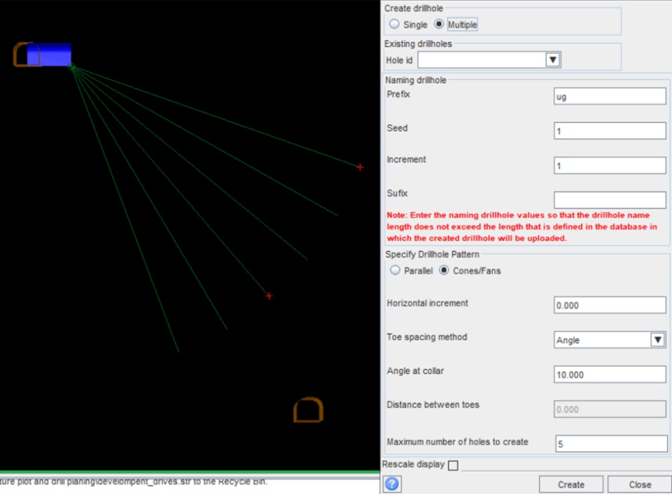

 3/ Cone/fan by Toe Angle method:
  • Enter in the angle increment of the holes.
  • Enter in the number of holes to be created.

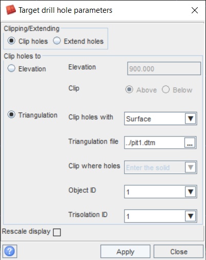

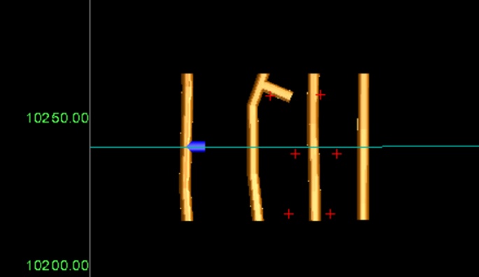

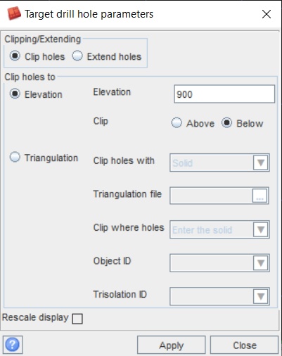

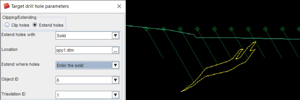

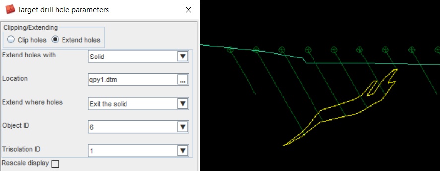

Extending holes to dtm/solids.
When using this function, the planned drillholes MUST be in the layer called “drillhole layer”
You have the ability to extend holes to a dtm/solid.
Clipping holes to dtm/solids/RL
NOTE: this function is to clip toes, NOT collars.
  • Clipping the toes to a set RL.
  • Clipping the toes with a dtm or a solid.

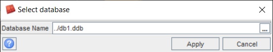

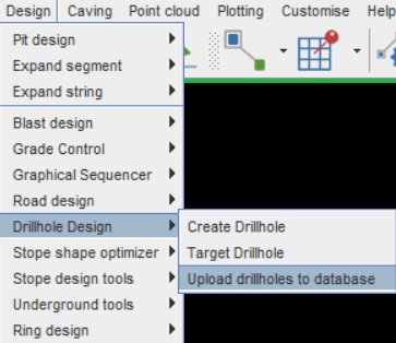

Loading Planned Drillholes into Planning Database
You can then load the drillholes up into a Planning Drillhole Database. Remember, in Geovia Surpac 2024 you can open 2 or more drillhole databases.
  • To load the drillholes into the planning database, make sure the working layer is “drillhole planning”. The holes MUST have been created via the Drillhole Design function.
  • Select the drillhole database and apply.
