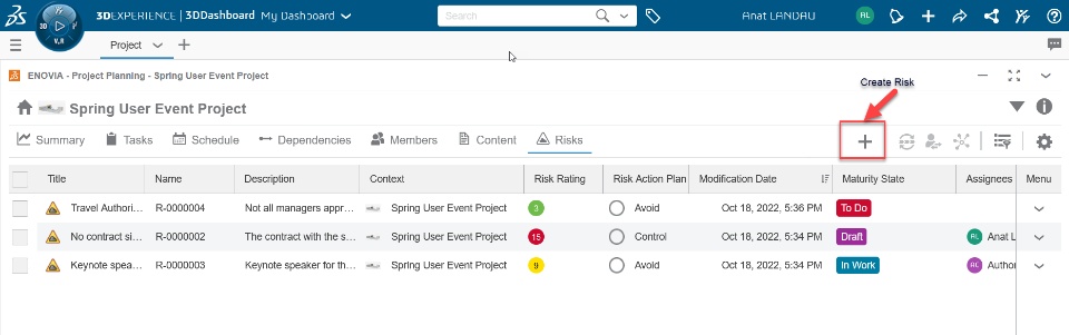

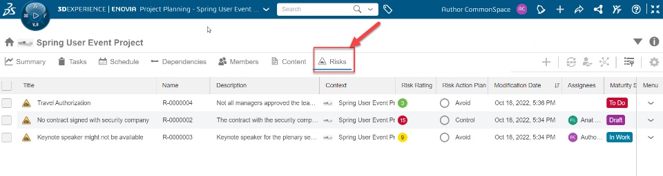

  2. You must be assigned one of two roles to have access to the ‘Risk Management’ application: - ‘Project Manager’ (DPM) and / or ‘Risk Manager’ (RSK).
    When condition #1 and #2 are met, Risks Tab becomes available in the 'Project Planning' application for a selected project
  3. You must be a Project Owner or a Project Leader with Leader access to the Collaborative Space, to create Risks in 'Project Planning' app.
    When condition #3 is also met, then you can also create a Risk associated with the project in ‘Project Planning’ application
