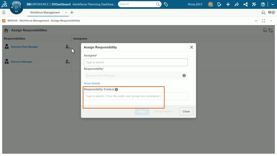

Assigning Business Roles
In many organizations, assigning business roles is typically a responsibility of HR Managers. However, as the workforce grows, managing business roles for hundreds or thousands of users can become a significant administrative workload when handled centrally.
ENOVIA Workforce Management provides a more decentralized and flexible approach: The Business Role Manager responsibility can be assigned to a member of a User Group, enabling designated functional leaders or representatives to assign business roles to users within their group.
This distributes business role management across the organization, reducing the administrative burden on HR while enabling those who are closest to the teams to manage their roles effectively. HR can then focus on broader workforce management and governance.

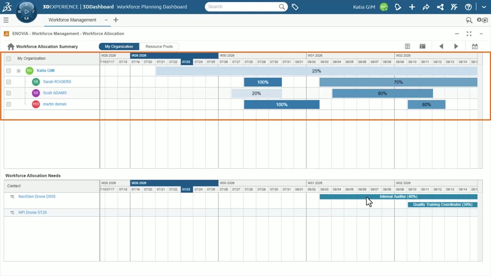

Handling Resource Requests
When projects need additional resources, someone needs to review the request, understand the requirements, and identify suitable people who can fulfill these needs. ENOVIA Workforce Management provides flexibility in how this can be organized, either through the company's formal supervisory structure or through Resource Pools.
A Resource Pool is a group of users brought together based on common skills, roles, functions, or areas of expertise.
With the Supervisory Organization approach, the direct manager can review resource requests and identify suitable resources within their organization. This is a natural approach when resource management follows the company's reporting structure.
Alternatively, organizations can use Resource Pools to organize resources independently of the supervisory hierarchy.
A member of the User Group can be assigned the Resource Manager responsibility for the pool and handle resource requests for the users in that pool.
This provides flexibility to assign resource management responsibilities across organizational boundaries. For example, a functional leader can be responsible for a pool of resources without being their direct manager.
