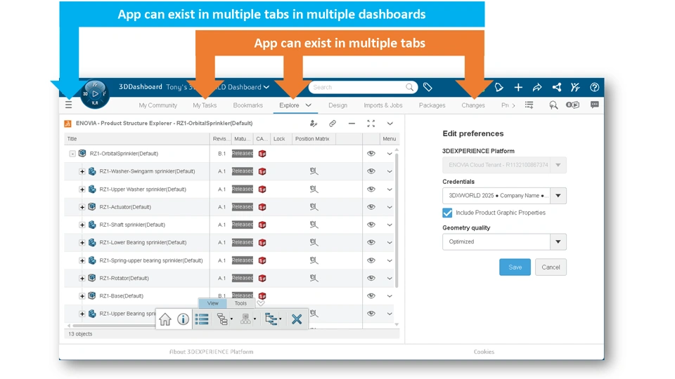

The 3DDashboard provides the platform user an environment in which they organize all their apps into multiple tabs and dashboards. Since an app can be added to more than one tab and dashboard, a single app may be available to the user in many different places in their environment. Subsequently, the ability to control the default settings for any particular app can be challenging, not only for the user but also for the administrator who sets the working standards across all apps for all users.
To address this issue, the 3DEXPERIENCE platform has a multi-tiered system for controlling the default settings using ‘preferences’ available per app on the platform.

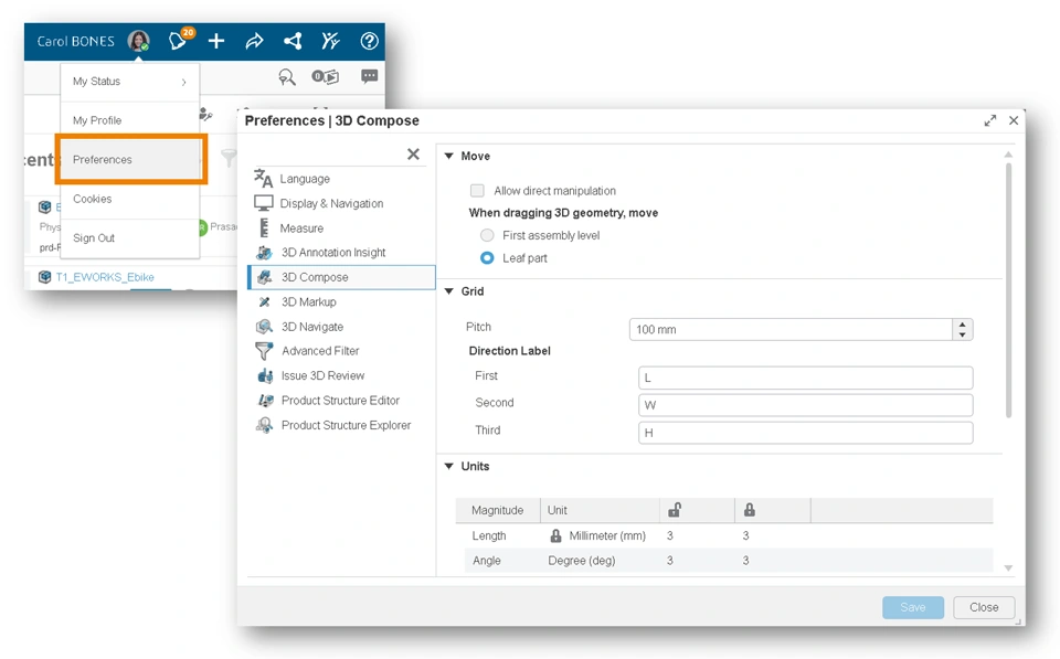

As a user
There are multiple tools available to manage preferences locally. Like the administrator, the user is presented with a similar control application for preferences with the exception of the locks. This allows the user to set and override, where allowed (setting not being ‘locked’), the values of any preference set by the administrator. This app is available within the main menu bar of the app, as illustrated below.

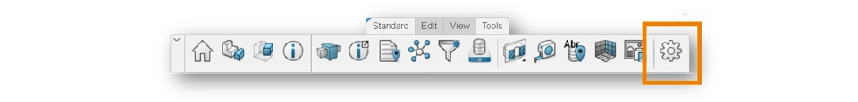

Beyond the user settings above that address all instances of an app, a localized setting panel within  the app allows for the modifiable preferences to be set distinctly in the app instance. This is accessible directly from the Toolbar under the Preferences icon as shown below.
