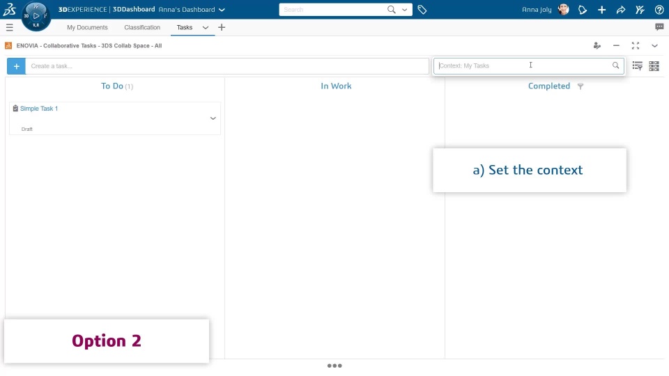

In general, there are two ways to set the task’s context:
  1.  After creating the task, open the task’s information panel and set the context in the task’s properties tab
  2. Set first the context in Collaborative Tasks context area, and then create a task -> the task will be created in that particular context

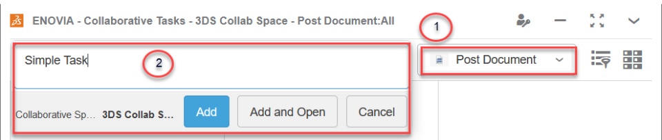

Simple Task
A simple task is a task with or without a context.
The following video illustrates two options for creating a simple task in a context of a document in Collaborative Tasks app:

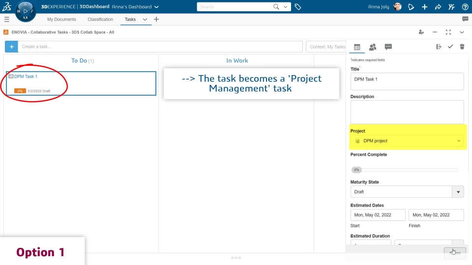

Project Management Task
A Project Management task is associated with a project created in the Project Management app (available in the role Project Manager (DPM)).
Any Project Management task that is created in Collaborative Tasks application, is also available in the Project Management app.
The following video illustrates how to create a Project Management task in Collaborative Tasks app:

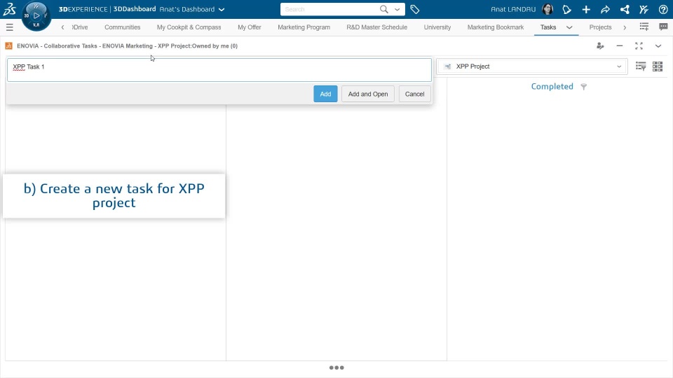

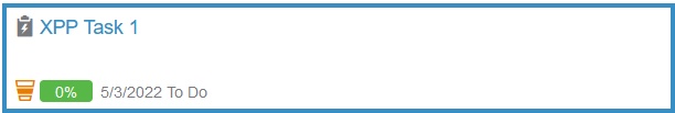

Project Planning Task
A ‘Project Planning’ task is associated with a project created in the ‘Project Planning’ application available in the role “Project Planner (XPP-OC).
‘Project Planning’ tasks are more detailed than simple tasks. Any ‘Project Planning’ task you create in ‘Collaborative Tasks’ app is available to the ‘Project Planning’ app.
The following video illustrates how to create a Project Planning task in ‘Collaborative Tasks’ app

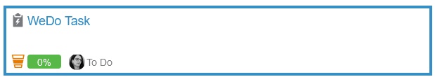

WeDo Task
WeDo tasks created in SWYM appear in Collaborative Tasks application.
You can view only WeDo tasks assigned to you.
Note: WeDo tasks can be created in SWYM on cloud only
