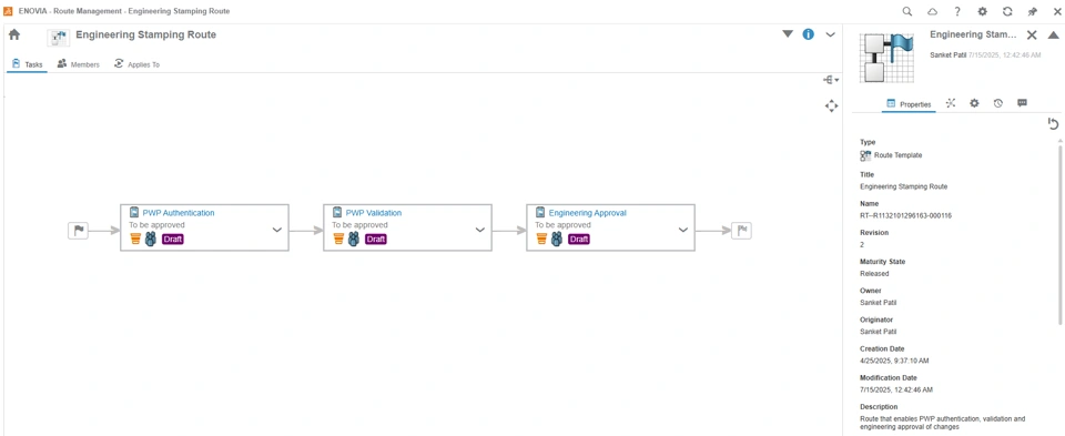

I found the help section on Routing Templates and the tips and tricks video on the same topic very useful while creating automatic routing for approval of change actions.
https://youtu.be/NjX3rvZpViQ
Below is the Routing Template we use for Engineering Approvals of CA. There are 3 steps for approving engineering drawings at Bowhead;
  1. PWP Authentication: This is the stage where Professional Work Products (PWP) or drawings are stamped by a Professional Engineer as per regulatory standards set by APEGA
  2. PWP Validation: This is the stage where PWP are stamped by a Responsible member as per APEGA standards
  3. Engineering Approval: This is the stage where Engineering approves the CA and completes any action item related to it such as sharing the approved drawings with vendors or with the purchasing dept. to obtain quotes
