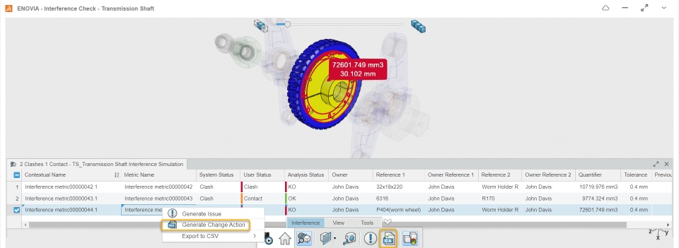

Report Design Issues from the Interference Check App
Reporting Issue

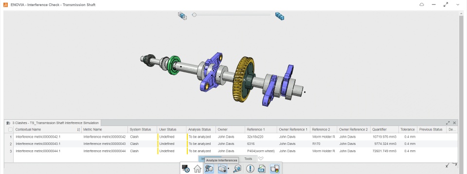

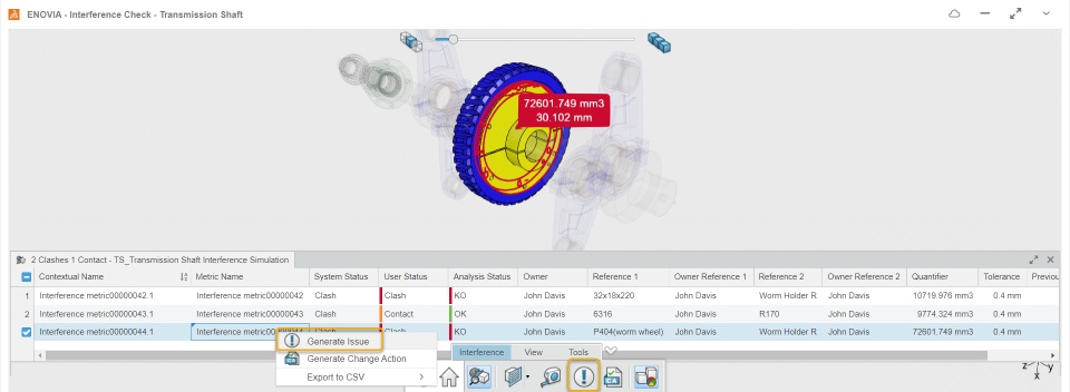

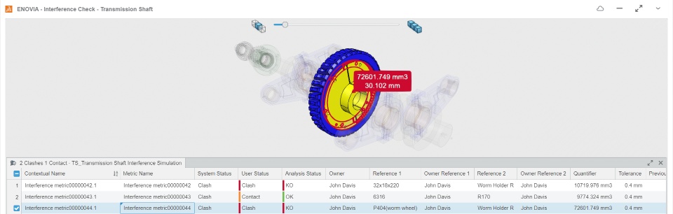

The Interference Check dashboard app lets you open interference simulations, visualize them in 3D, perform quick analysis and seamlessly report design issues. You can click on the Analyze Interference icon to open the list of interference simulations with the colors associated to the User Status and Analysis Status.
When you select any interference from the list, the 3D geometry is reframed to display the interfering geometry for the selected interference. You can analyze interference metrics and update user and analysis status.

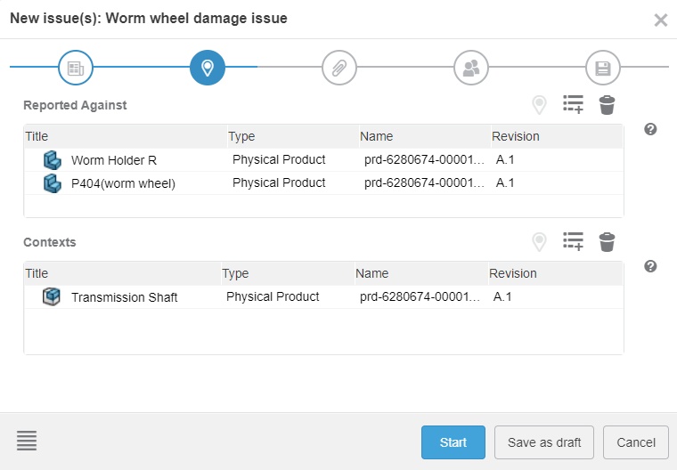

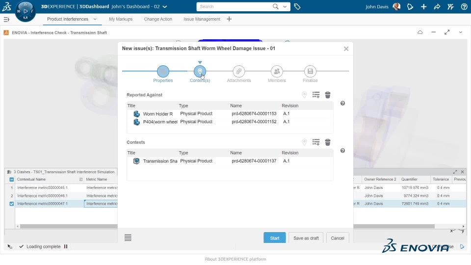

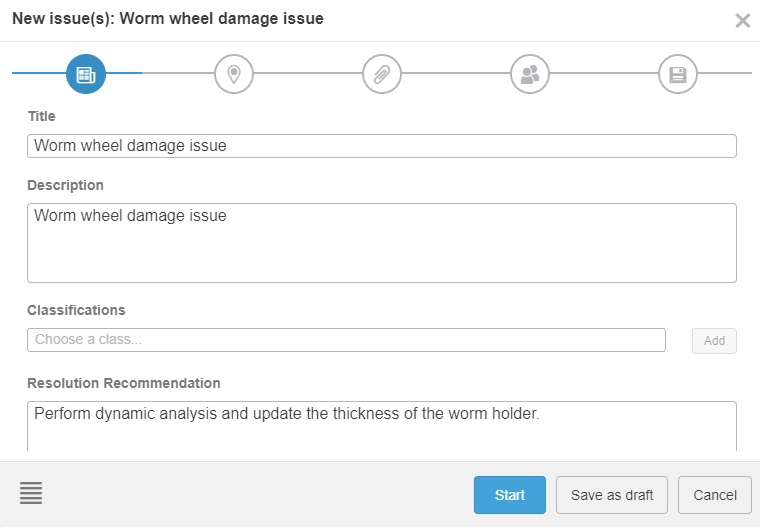

You can perform a quick review by measuring product dimensions, distance between parts or sectioning the items. After a quick analysis, you can report design issues by creating an issue from the same widget. While defining an issue, you can add a detailed description (based on your findings), set severity and mention recommendations to fix it. By default, an issue is assigned to the owner of the interfering parts. You can change the assignee, if required.

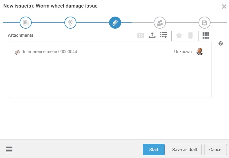

Interfering parts are automatically added in the Reported Against list and the product root is added under the Contexts list. You can add or modify items in these lists.
The interference metric is automatically attached to the issue. You can update the attachments, or attach other relevant 3DEXPERIENCE objects to the issue.

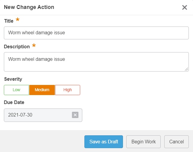

Creating Change Action
For the issues identified during the review, it is important to effectively manage the design change process with full traceability. You can initiate a formal change process to resolve design issues by generating a stand-alone change action from the same widget.
The interfering parts are automatically added in the proposed changes and their root is added as the context. You can update the assignees of the change action from the change action widget app. All the design updates performed by assignees using the change action are captured under the realized changes tab. The change action is added to the “Resolved By” section of the Issue.

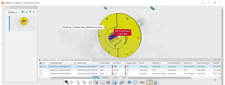

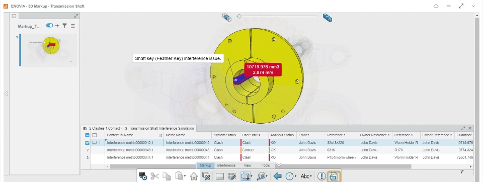

Report Design Issues from the 3D Markup App

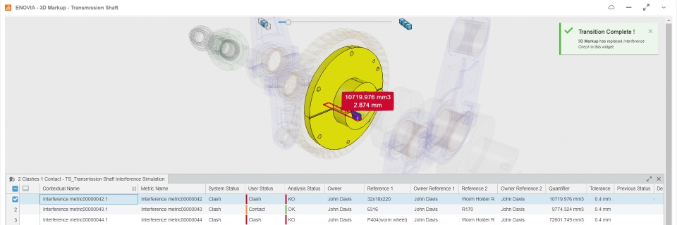

Critical issues often require detailed and comprehensive analysis. It is important to capture and explain such issues using annotations and markups before reporting them. In such cases, you can switch from the Interference Check dashboard app to the 3D Markup dashboard app by selecting the 3D Markup app from the Compass. The “Transition Complete!” message appears after a successful transition.

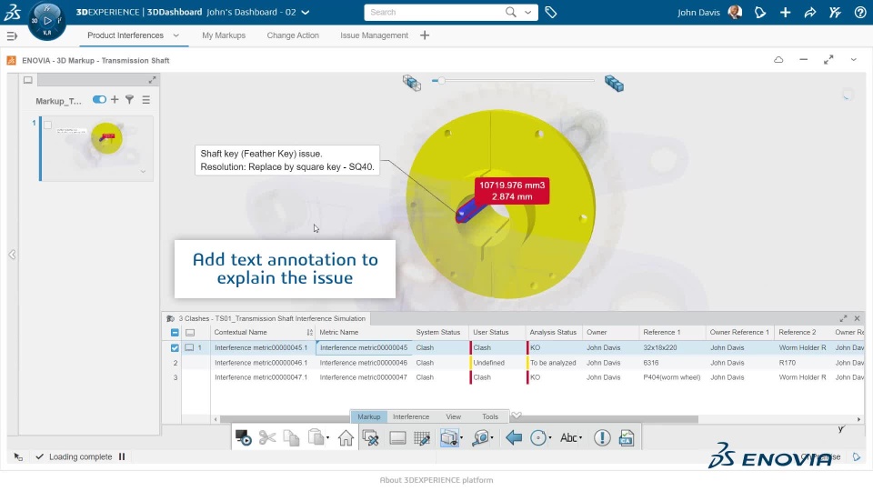

The 3D Markup app is a simple and efficient analysis tool that allows you to perform markups on 2D drawings and 3D products for collaborating and communicating on design issues. Using 3D Markup, you can create slides, perform measurements and add annotations for accurate design analysis.
Reporting Issues
After a detailed analysis you can report critical design issues and assign them to the owner of the interfering parts without leaving the 3D Markup widget.
For the critical issues identified during the detailed design review, it is important to effectively manage the change process with full traceability. You can initiate a formal change process to resolve design issues and also track design changes made during resolution. To do that, you can generate a stand-alone Change Action directly from the 3D Markup widget. The change action is added to the “Resolved By” section of the Issue.
