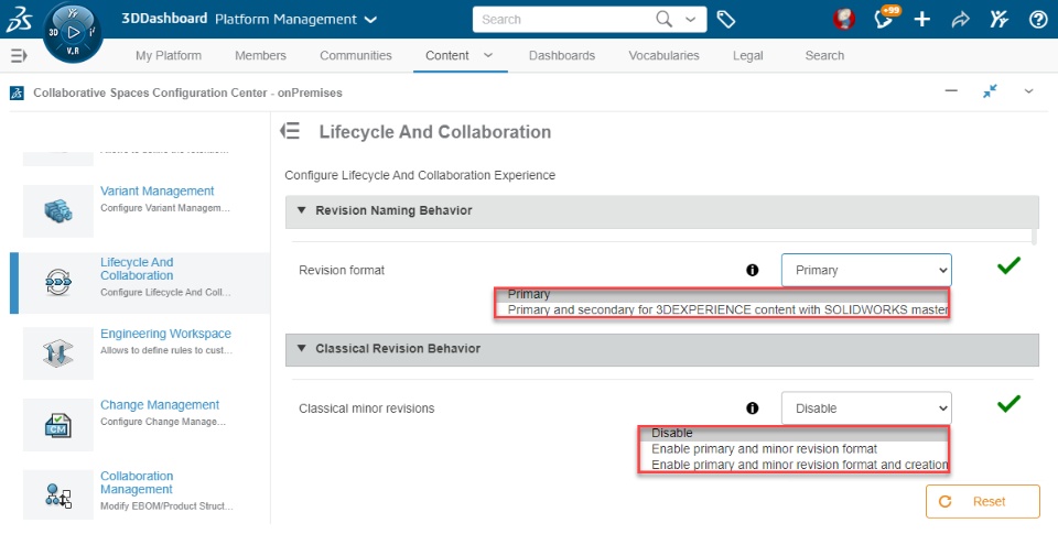

The request from many customers for the removal of Minor Revision has been answered in 3DEXPERIENCE R2021x FD07, and is now available for administrators through the "Collaborative Spaces Configuration Center" widget. Administrators can go to the "Lifecycle and Collaboration" section to set the "Revision format" to be "Primary" and to set "Classical minor revisions" to "Disable." This setting will allow the Engineering Item to be created and shown as "Primary#" revision only (e.g. the setting will show the Engineering Item's revision as "A" - subsequent revision as "B", "C", and so on - rather than "A.1," with the previous default settings of "Primary#.Minor#."
Please see the attached screenshot. I will gladly explain the other settings if there are any additional questions.
