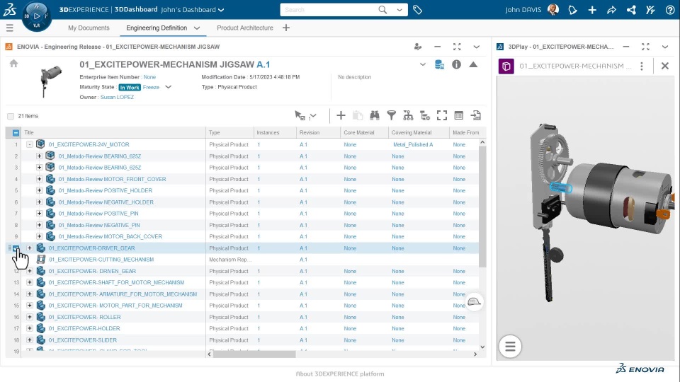

Usage in ENOVIA – Product Release Engineer
Materials
Depending on the need for usage, you can define the required materials in the Engineering definition as follows:
If the need is
Solution (in “Product Release Engineer” role)
  • Define Material that the Engineering Item is “Made of”
  • Quantity definition is not required
Example: Copper
  • Add “Core Material”
  • Add "Covering Material"
Where: tab “Material”
Supported for:
  • Part (Core/Covering Material)
  • Product (Covering Material only)
If the need is
  • Define Material that the Engineering Item consumes, to manufacture it
  • Quantity definition is required
Example: Glue, Oil and so on.
  • Volume/Mass
A new Engineering Item is created and linked to the Core Material
Where: Command “New quantity of material”
Supported for:
  • Product (“Continuous Quantity Material”)
Raw Material
If the need is
  • Define Raw Material that the Engineering Item consumes, to manufacture it
Example: Glue 600-T, Oil ISO-46 and so on.
  • Add “Raw Material
  • Select the Unit of Measure of the Raw Material
  • Raw Material is instantiated
  • No new Engineering Item
Where: Command “Existing Raw Material”
Supported for:
If the need is
  • Define Raw Material that the Engineering Item is “Made Of”
Example: Copper 3X35 wire
  • Add “Raw Material
  • Raw Material is linked to the Engineering Item
  • No new Engineering Item is created
Where: tab “Make From”
Supported for:
  • Part
