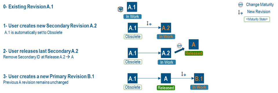

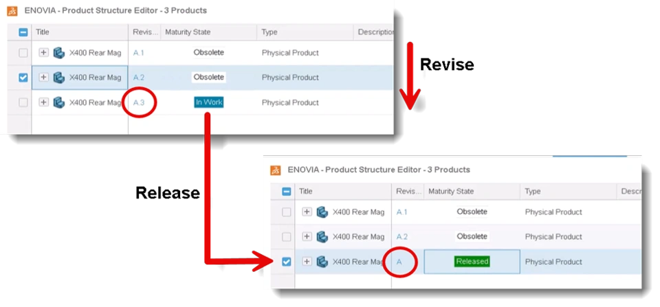

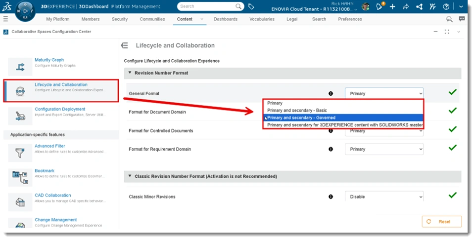

In this release, we introduce a fourth format called “Primary and Secondary -Governed”, available in the Collaborative Spaces Configuration Center app:
To improve the efficiency to better differentiate the informal design evolutions from formal finalized designs the … new option Primary and Secondary - Governed revision format adds a secondary revision ID to the revision number, like the Primary and Secondary – Basic format, but removes the secondary ID when released to identify the formal revision. and changes the maturity of prior revision to Obsolete to identify the valid informal design evolution.
Summary
Companies can continue to employ any of the existing formats. There is no impact on existing capabilities, especially the Primary and Secondary choice for revision format which is renamed as Primary and Secondary - Basic but has an unchanged behavior from prior releases. The new format provides a cleaner release revision and it will only be possible to release the latest secondary revision, since previous intermediate revisions will be automatically set as Obsolete based on two fundamental rules:
  • Released states will be identified by a different revision number format (primary only),
  • It will only be possible to release the latest secondary revision, and previous intermediate revisions will be automatically set as Obsolete.
