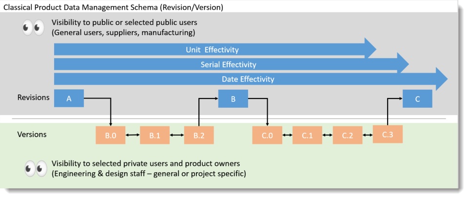

Today, I would like to speak to those of you out there familiar with Product Data Management (PDM) environments and are moving to the platform. Those of you who have worked in a PDM environment are probably familiar with the terms revisions and versions (...or minor revision?). Just to make sure we are on the “same page”, let me take a moment to define them here:
Revisions:
In the engineering world, we revise things so that anyone can understand changes. Once mature, we “release’ these revisions. These “released” revisions take you to the published level where you apply effectivity and produce a product.
Versions:
Versions are not visible to every user. They track incremental changes made by one or more stakeholders during a designs evolution. Generally, a designer creates versions in the context of CAD design. Versioning benefits the development process by allowing designers to capture their design work in such a way that they can move backwards and forwards in changes between two revisions as needed. Many designers called this process a “check in” or “backup” since they see it as a way to protect what they had accomplished during a workday or week.

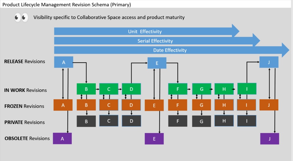

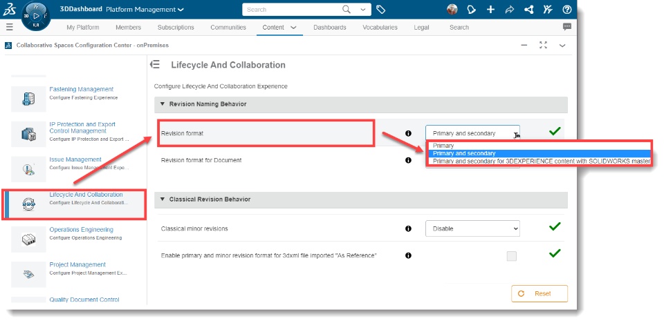

The Collaborative Spaces Configuration Center app in the 3DEXPERIENCE platform, provides you with the tools to control the revision scheme on the platform. Among other capabilities, it offers the ability to set three revisions schemes
- Primary
- Primary and Secondary
- Primary and Secondary for 3DEXPERIENCE content with SOLIDWORKS master

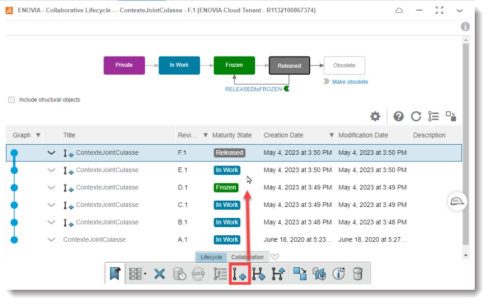

The Primary behavior is the default that addresses the standard revision scheme that meets the needs of most users throughout the product lifecycle from a PLM perspective.

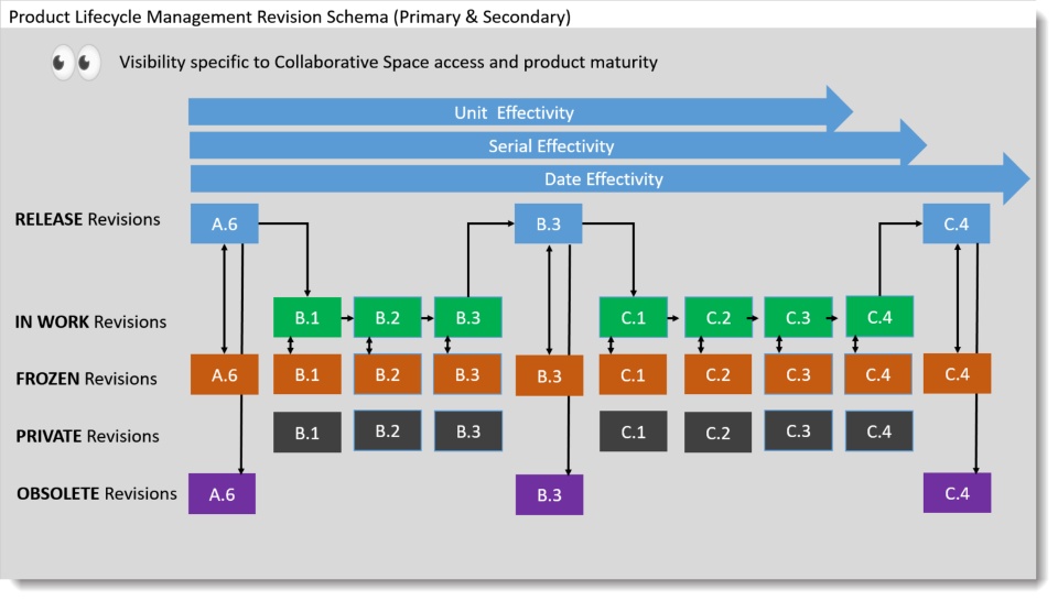

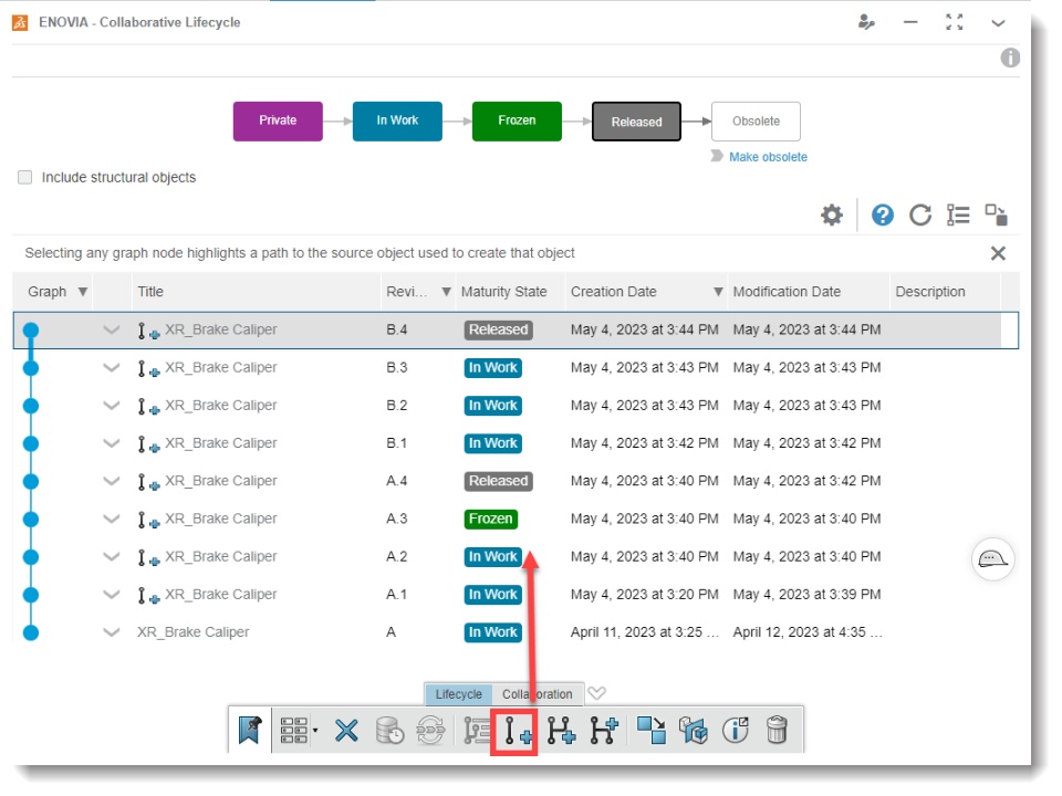

​​​​​​​​​​​​​​The Primary and Secondary option offers you the ability to bring the PLM and PDM world closer together. It maintains the values of the Primary environment mentioned, with the expanded capability to track incremental changes made by one or more stakeholders during a designs evolution. Since all iterations are revisions, filtering and the related access would be through the maturity states of the individual revisions.
The Primary and Secondary for 3DEXPERIENCE content with SOLIDWORKS master was an earlier methodology used by SOLIDWORKS customers. Customers upgrading from 21x FD07 can take advantage of this option but it is not recommended for other customers. For further specifics on this capability, contact your SOLIDWORKS representative.
