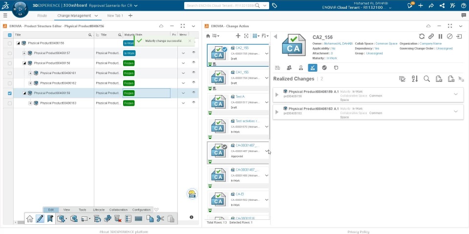

The Change Manager Role (CHG) enables the user to transfer Realized Changes between Change Actions. In the following example, you can see how the user is working under Change Action (CA1-156)   and how the changes are captured under the “Realized Changes”. You can see also how the user can transfer two of the captured Realized Changes from the original CA (CA1-156) to the target CA (CA2-156).
Note that changes (for example geometry changes) can be done on Physical Products in state “In Work”. When the work is finished, the user can promote the Physical Products to “Frozen”.
Through selecting the reason of the transfer “Delayed Completion”, the system is creating a dependency between both CAs, so that the target CA (CA2-156) must be completed after the original CA (CA1-156).
Therefore, the user is delaying the Release of “Physical Product00406159” with its children to a later point of time.
