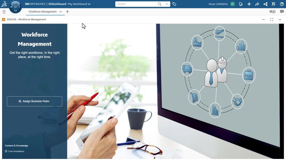

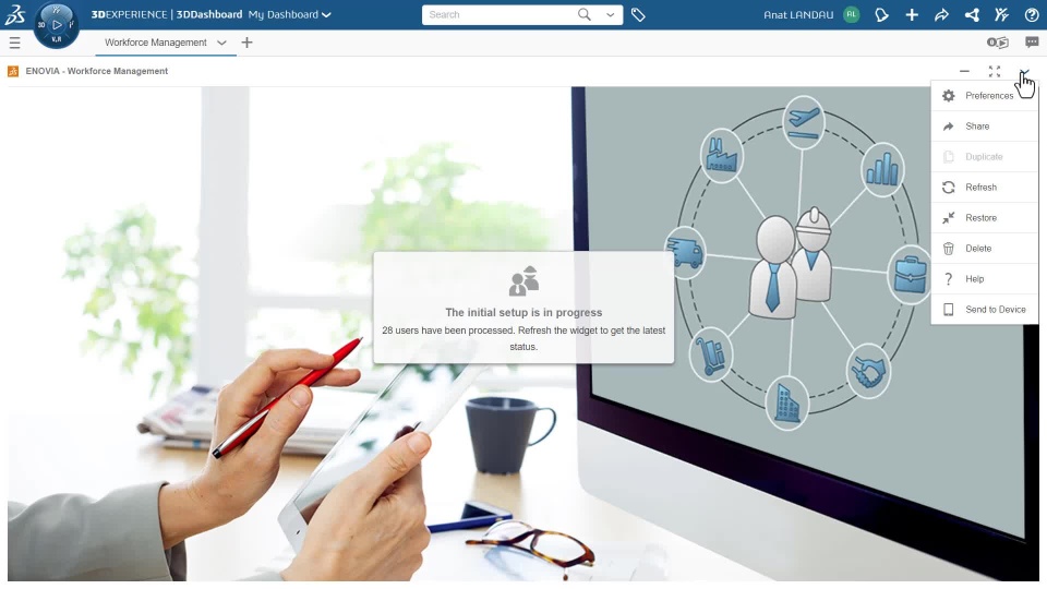

Step 1 - Synchronize users.
What: In this step, the Workforce Management application performs a user synchronization to populate the application with users from your organization.
How: To perform this synchronization, you need to launch 'Workforce Management' application for the first time, as a user with platform administrator permissions that has XWO-OC (Workforce Manager) license.

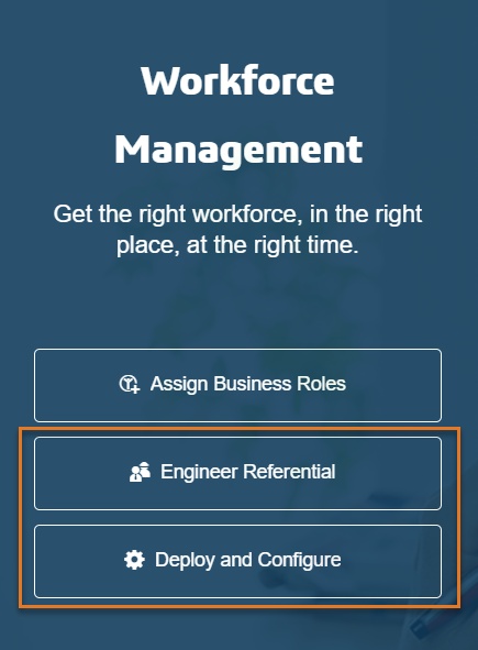

Step 2 -  Assign 'Workforce Referential Engineer' permission
What: 'Workforce Referential Engineer' permission allows you to generate and deploy Workforce Referential.
How: To assign the 'Workforce Referential Engineer' permission, you need to launch the 'Workforce Management Control Center' as a user with platform administrator permission that has XWO-OC (Workforce Manager) license.
As a result of this assignment, the following menus become available to you on the 'Workforce Management' application home page:
  • 'Engineer Referential' – allows you to create a custom workforce referential.
  • 'Deploy and Configure' – allows you to deploy the workforce referential file.

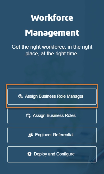

Step 3 - Assign 'Workforce Organizer' permission
What: 'Workforce Organizer' permission allows you to assign the 'Business Role Manager' to users.
How: Similar to the previous step, to assign the 'Workforce Organizer' permission, you need to launch the 'Workforce Management Control Center' as a user with platform administrator permission that has XWO-OC (Workforce Manager) license.
As a result of this assignment, the ''Assign Business Role Manager' ' menu becomes available to you on the 'Workforce Management' application home page.
Step 4 -  Assign a 'Business Role Manager'
What: Business Manager permission allows you to assign ontology-based business roles to people in the organization.
How: To assign the 'Business Role Manager', you need to launch the 'Assign Business Role Manager' option as a 'Workforce Organizer' from the 'Workforce Management' home page.
As a result of this step, you can use the 'Assign Business Roles' page to assign ontology-based business roles to the people in the organization.
