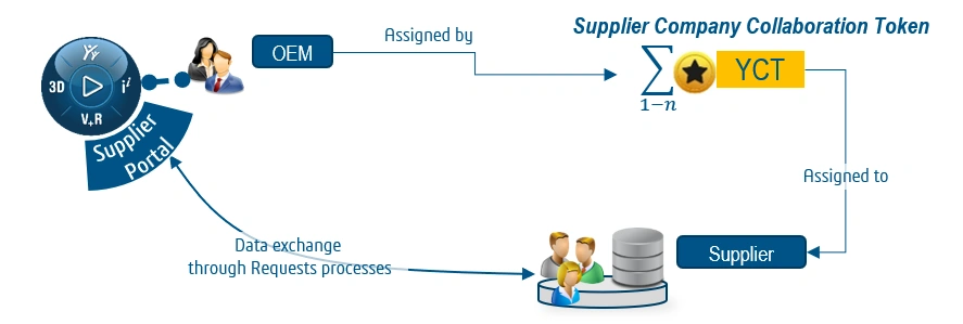

Establishing the Communication Channel
Before collaboration requests can be exchanged, suppliers must be connected through the supplier portal. The portal provides a secure communication channel between OEMs and suppliers, enabling suppliers to receive requests, submit responses, and exchange deliverables.
For a detailed explanation of supplier onboarding, portal access, and communication setup, refer to the following blog:
Establishing Communication Channel with Suppliers

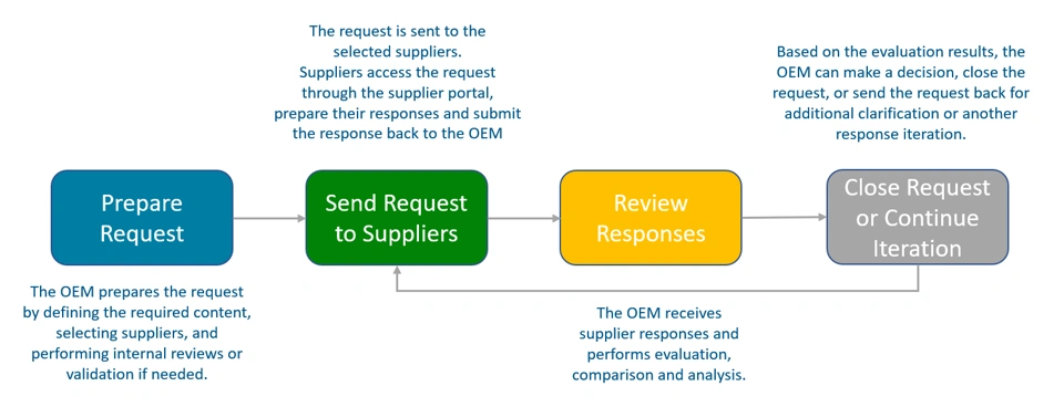

While each collaboration request type may have its own specific lifecycle and business logic, the overall collaboration principle remains similar across all requests. In general, the interaction between OEMs and suppliers follows a structured flow of request preparation, supplier response, evaluation, and closure or iteration.

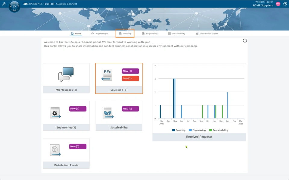

Sourcing Requests:
Sourcing requests are created and managed by sourcing managers using the ENOVIA RFx Manager (RFX-OC) role. These requests support supplier evaluation, quotation collection and proposal management throughout the sourcing process.
The solution supports three main sourcing request types:

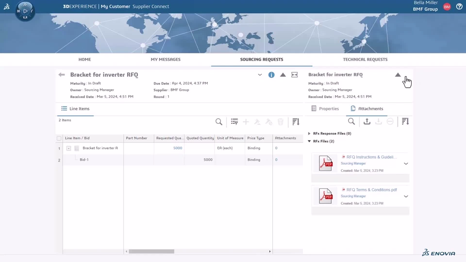

  • RFQ (Request for Quotation):
    Used to collect pricing, lead times and commercial quotations from suppliers for specific products. RFQs typically contain line items representing the requested products and quantities.

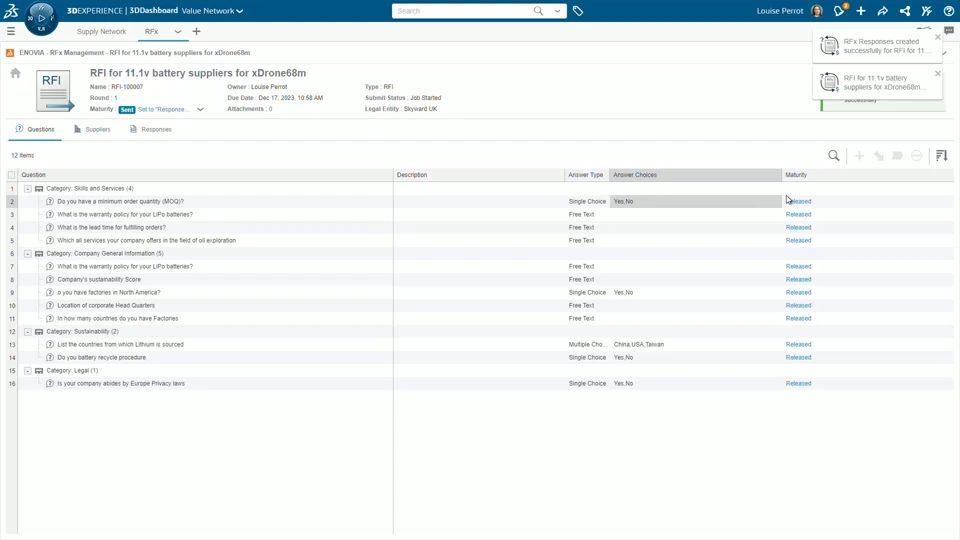

  • RFI (Request for Information):
    Used to collect supplier capabilities, qualifications, and preliminary information before initiating sourcing decision. RFIs typically contain questionnaires that suppliers are requested to complete.

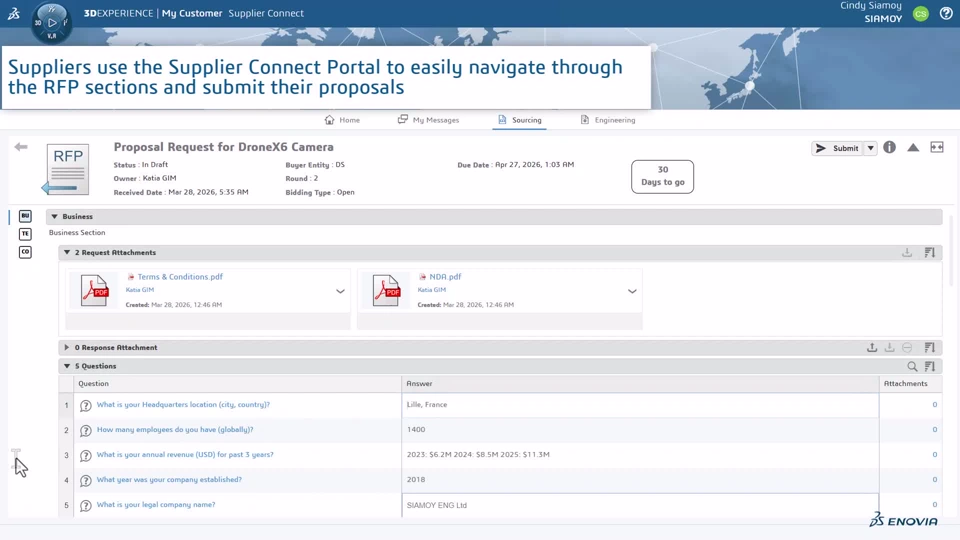

  • RFP (Request for Proposal):
    Used to collect detailed commercial and technical proposals from suppliers. RFPs may include questionnaires, attachments, specifications, and line items to support a comprehensive supplier response.

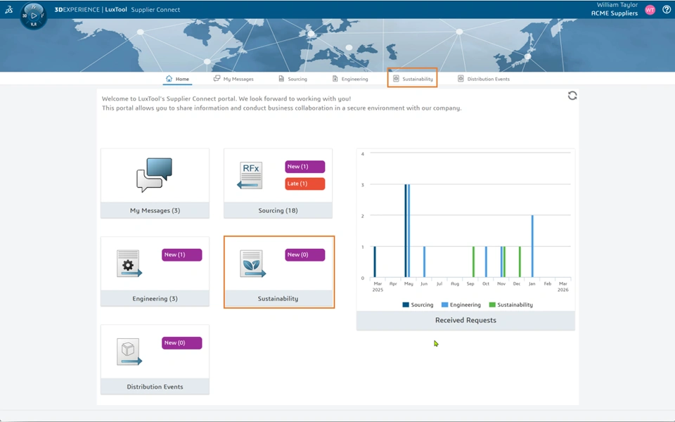

The Sourcing requests are available under the Sourcing section in the supplier connect portal:

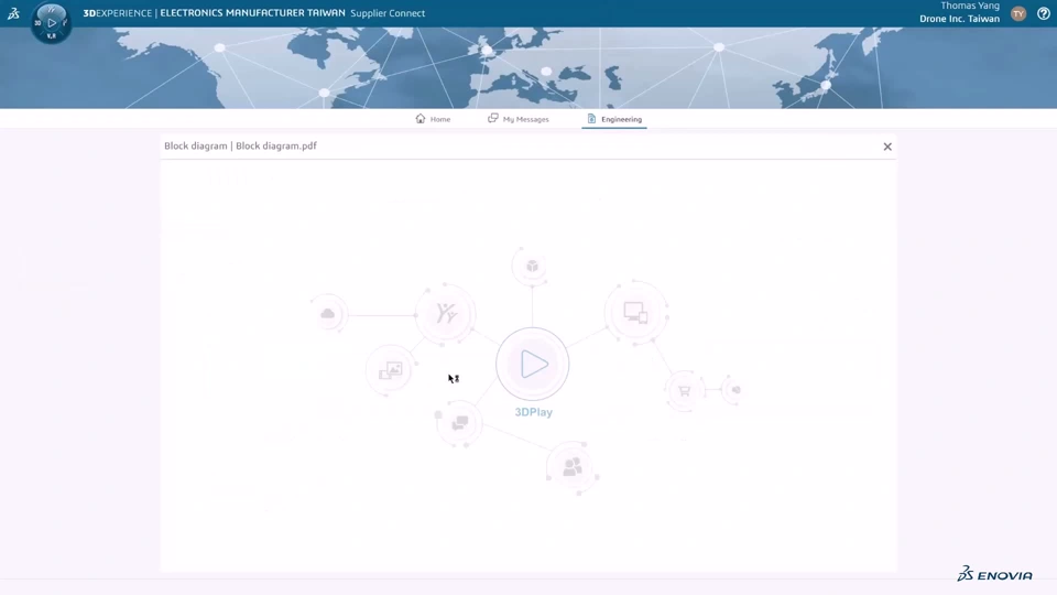

  • Design Request: Used to collaborate with suppliers on product design and development activities, including the exchange of technical specifications, drawings, and engineering deliverables.
  • Design Change: Used to communicate and manage modifications to existing designs, specifications, or engineering definitions in a controlled and traceable manner.
The Technical requests are listed under the Engineering section in the supplier connect portal:

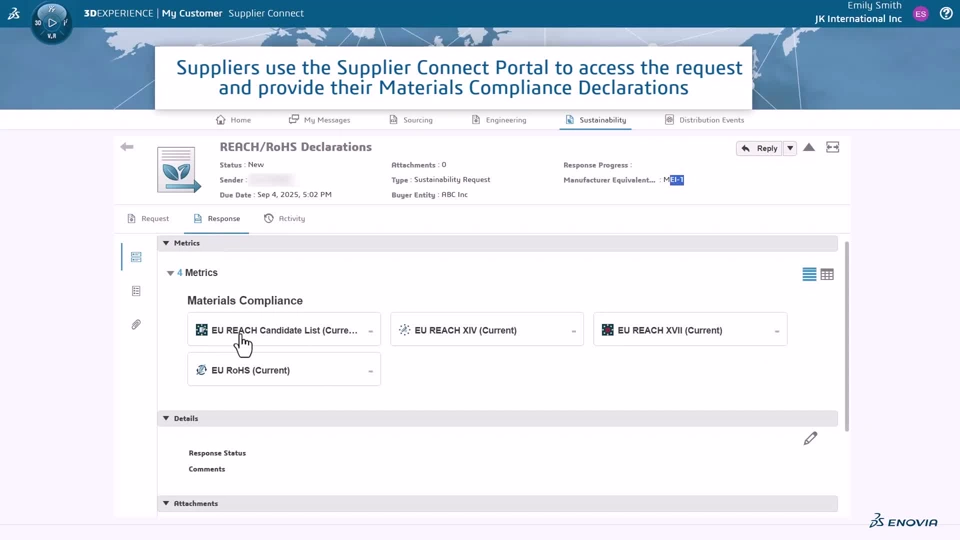

  • Materials Compliance: used to collect suppliers sustainability declarations on materials regulations.
    Creating and managing these requests requires the Material Compliance Engineer (MCV-OC) role.

The Sustainability requests are listed under the Sustainability section in the supplier connect portal:
