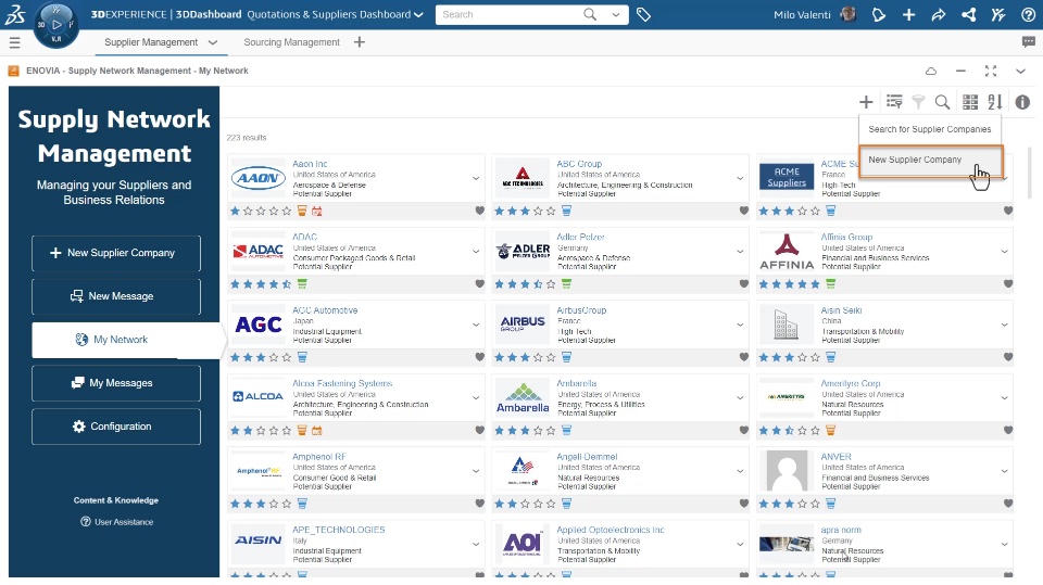

Step #1 – Define the supplier in ENOVIA:
Create the supplier company:
Create the supplier company in ENOVIA, by using the Supply Network Management application, which is available with the Supply Network Manager (PTN-OC) role.

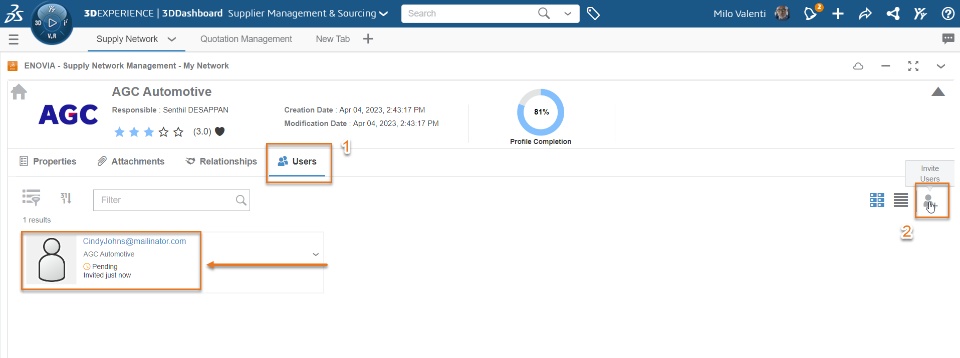

Step#2 – Define the supplier user / representative.
Create the supplier user:
During or after the creation of the supplier company, you can create the supplier user.
The supplier user is the supplier representative, who will be invited to connect to the supplier portal. Therefore, when creating the user, you must enter the email of the user.
At this stage, the user is in Pending State.

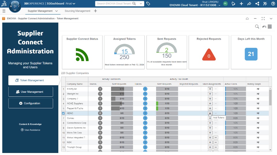

Step#3 – Allocate a token to the supplier company
Each Supplier Company Collaboration Token (YCT-OC) license provides you a single token.
The license must be on the license server and not assigned to any ENOVIA user.
Allocate a token to a supplier company and track the tokens usage, by using the Supplier Connect Administration application, which is available with the Supply Network Manager (PTN-OC) role.
A single token allows you to send up to 10 RFQs and to connect up to 25 supplier users to the Supplier Connect Portal, per month.
You can see the total number of tokens available to your company and the number of assigned tokens in the 'Assigned Tokens' chart.
You also have an indication about how many days left this month.
Every month you can remove the token from one Supplier Company and allocate it to another Supplier Company.

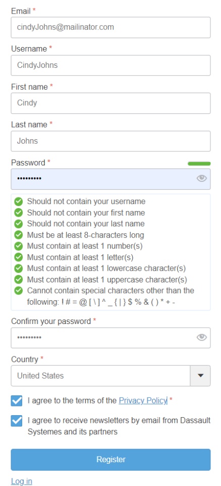

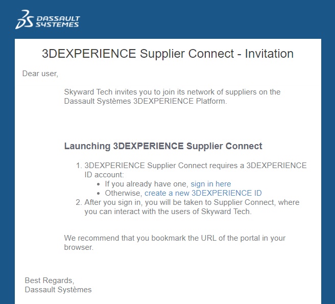

Step#4 – Supplier user creates 3DExperience ID
Once the token is allocated to the supplier company, the supplier user receives an email with an invitation to create a 3DExperience ID.
Create 3DExperience ID:
