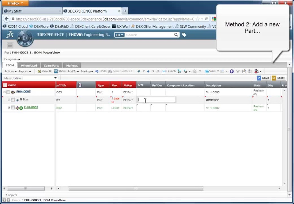

In light of this scenario, there are a number of use-cases that we can explore. Within these use-cases are fundamental functions we should all be comfortable with. I have created a brief video here that touches on the fundamentals of manual BOM structure creation. You will likely note that I created this video in R2014/14x environment but the BOM functionality is essentially the same across the 12x-14x releases.
