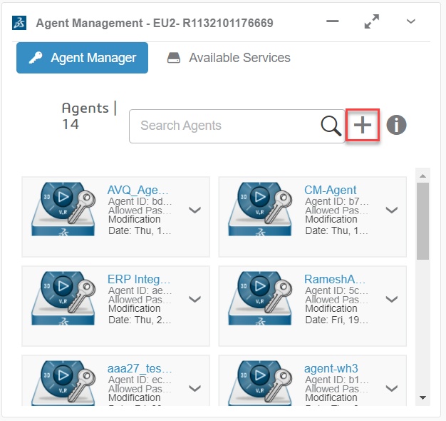

As a user assigned the role PFI open the Agent Management widget and select the '+' to create a new agent.

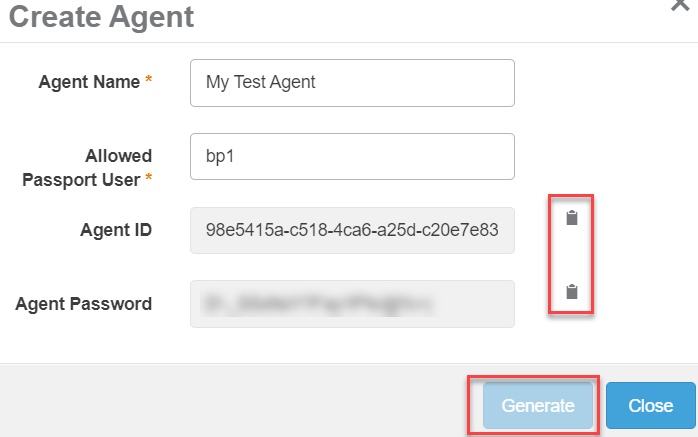

Fill out the Agent Name and Allowed Passport User and click Generate.  After successful generation be sure to copy the Agent ID and Agent Password to secure location.  The Agent Password will not be shown again after this step and can only be regenerated to something new.
Name: Name of the agent (only used to identify the agent in the widget) Allowed Passport User: User credentials of a user to proxy web service calls
       - The user must NOT have an Administrator role
       - The user must have the licenses corresponding to the web services you wish to call
       - There is no credential authentication so ensure username matches the credentials used to login

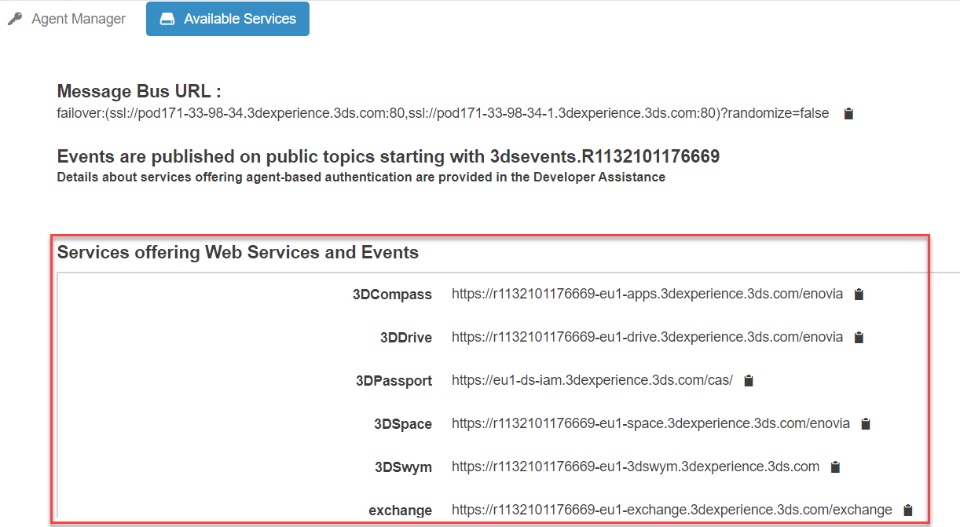

Select the Available Services tab to view the base URLs that can be used to call web services on the cloud instance you have created the Agent.

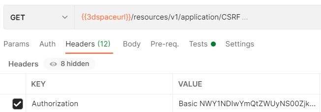

The Agent ID and Agent Password created by the Agent Manager can be used to generate a Base64 encoded Basic Authorization header.
Encode String:   agent_id:agent_password (separated by a colon)
Ex.  5f5420bd-ee25-4f90-9714-1d35053bb0c9:dummy_password = NWY1NDIwYmQtZWUyNS00ZjkwLTk3MTQtMWQzNTA1M2JiMGM5OmR1bW15X3Bhc3N3b3Jk
Authorization Header = Basic NWY1NDIwYmQtZWUyNS00ZjkwLTk3MTQtMWQzNTA1M2JiMGM5OmR1bW15X3Bhc3N3b3Jk
This Authorization header can then be used by any of the 3DEXPERIENCE web service calls to the platform.
