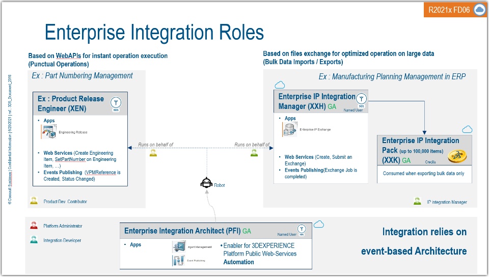

The framework consists of the following roles:
1.    Enterprise Integration Architect
2.    Enterprise IP Integration Manager
3.    Enterprise IP Integration Pack

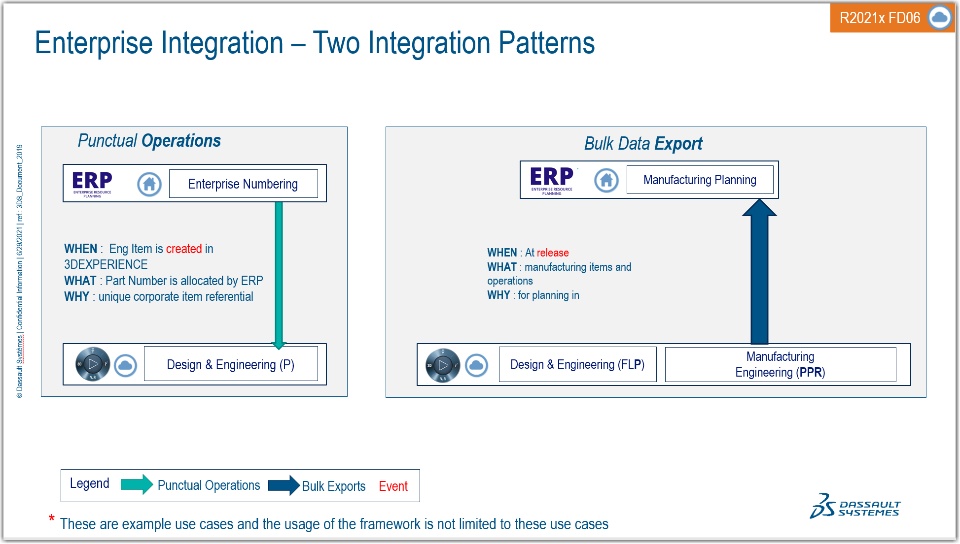

It supports the following integration patterns:
1.    Punctual Operations
  • Mainly used for quick short operations between the external systems and the 3DEXPERIENCE platform
2.    Bulk Data Export
  • Used to export Engineering or Manufacturing structure from the 3DEXPERIENCE platform to an external system -- this is asynchronous and event driven
