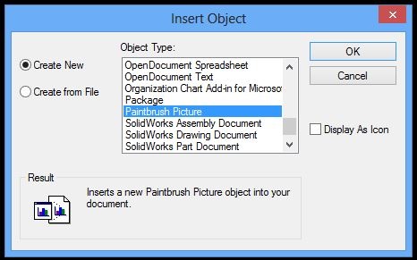

4.Go to Insert > Object.
5.Select 'Create New' option.
6.Select 'Paintbrush Picture' from the list.
  1. Clicking Ok opens Microsoft      Paint application.

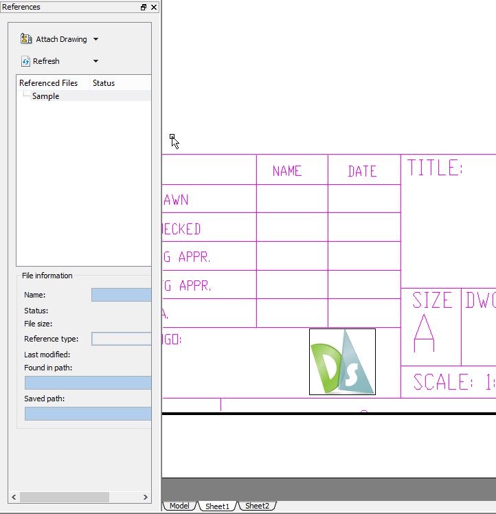

You can confirm that it is not placed as a reference by:
1.Type command: References
2.Notice that the image file is not listed.
