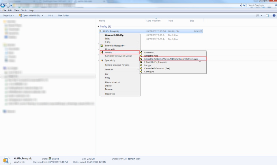

  1. Download  HotFix_Esnap.zip.
  2. Right click on HotFix_Esnap.zip and extract the files to a folder.

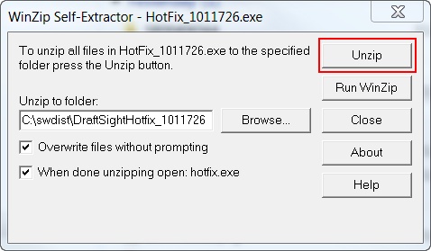

   3. From the extracted folder, double click HotFix_Esnap.exe. Select Unzip.

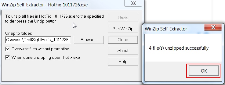

   4. You will see the message "4 files(s) unzipped successfully" . Click OK.

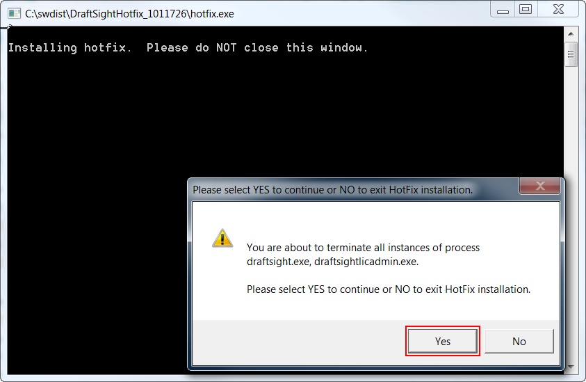

   5. You will see the following message. Click Yes.

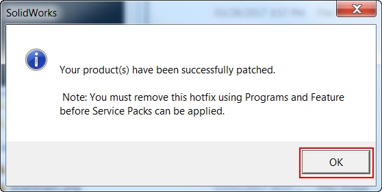

  6. You will see the following message confirming that DraftSight have been successfully patched. Click OK.
The hotfix should be applied at this point resolving the issue for cursor jumping off target while performing Esnap.
