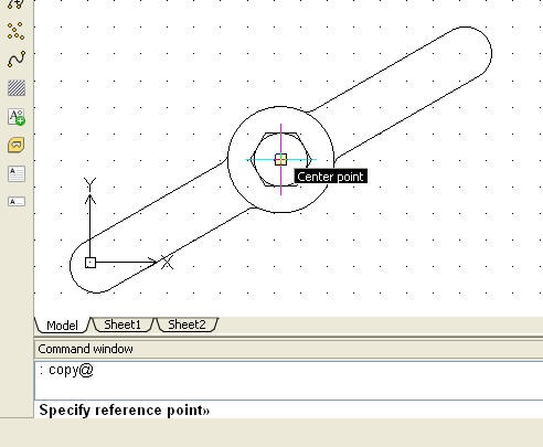

To copy to the clipboard with a reference point:
  1. Click Edit > Copy with Reference Point (or type Copy@).
  2. Specify the reference point.
    The reference point is used as the insertion base point when you later paste the entities.
      3. Select entities to copy.
      4. Press Enter.
The selected entities are added to the clipboard.
