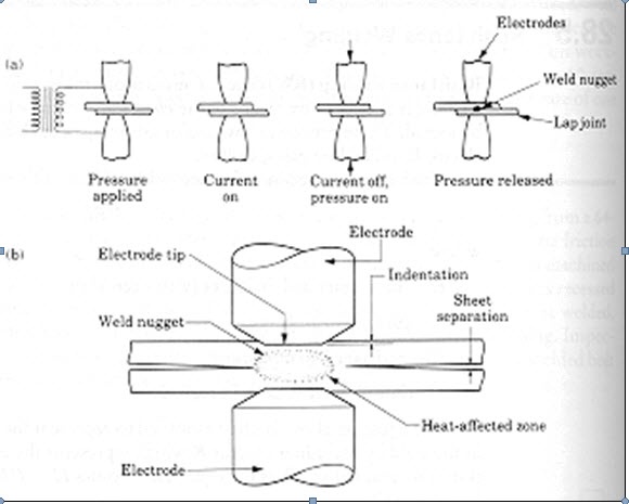

 Resistance Spot Welding (RSW) has the basic parameters of pressure, heat, and time. The spot gun electrodes close and squeeze two or more parts together. High current is passed through the electrodes to create I2R heating which creates the weld nugget. The size of the nugget also depends on how long the current is applied. The squeeze pressure used is critical to keeping the molten weld nugget contained and making a quality weld. The gun must also continue to squeeze the material after the current is removed so the molten nugget can solidify. Achieving a quality weld requires the gun and welding current to be properly sequenced and controlled.

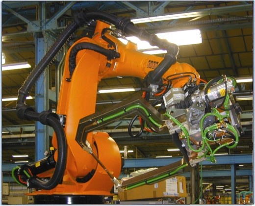

Most spot welding guns are actuated by pneumatic or hydraulic cylinders. The electrodes move the entire range of the cylinder when the gun opens and closes. Clamping force is normally fixed by a pressure regulator, and there is usually no means to provide feed back regarding the actual clamping pressure. The motor-controlled servo gun provides variable electrode openings and programmable regulated pressure. This reduces cycle times and improves weld quality while reducing tip maintenance. Servo motors can be controlled to regulate position or torque. The robot axes are position controlled (for repeatability). A servo gun switches back and forth between a position control loop and a torque control loop.

Pneumatic guns often have two cylinders; one is used for short open and other creates a full open space between electrodes. The servo gun (in position control) provides programmable electrode opening anywhere between the full stroke of the gun. The electrode opening can be programmed to move simultaneously with other axes of the robot. The servo-gun’s ability to open the electrodes only a short distance or a larger amount to provided the exact clearance needed around tooling or parts provides application flexibility and can also save cycle time. During the weld, the servo motor switches to torque control and provides a uniform calibrated clamping force. This is easily programmed in the robot control and is expressed as a unit of force. The force can be stepped during an individual weld cycle or varied from weld to weld for different material thickness stack-ups. Pneumatic guns close at full clamping force, which creates high impact on the tips.

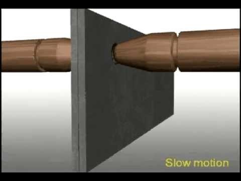

The servo gun controls the rate at which the electrodes close and ramps up to the clamping force. This controlled process extends the life of tips and is a major reason auto manufacturers have been using them. The controlled clamp force also improves quality and cosmetics, allowing welds to be made on Class A surfaces. Where can you get a servo gun? Most major spot gun manufacturers have servo guns in their product line up. They are typically available in C and X type configurations. Since robot manufacturers need to control the motors, gun manufacturers will adapt motors from various robot companies to their drives. Servo guns can provide clamping forces in the 400-600 kgf range.
