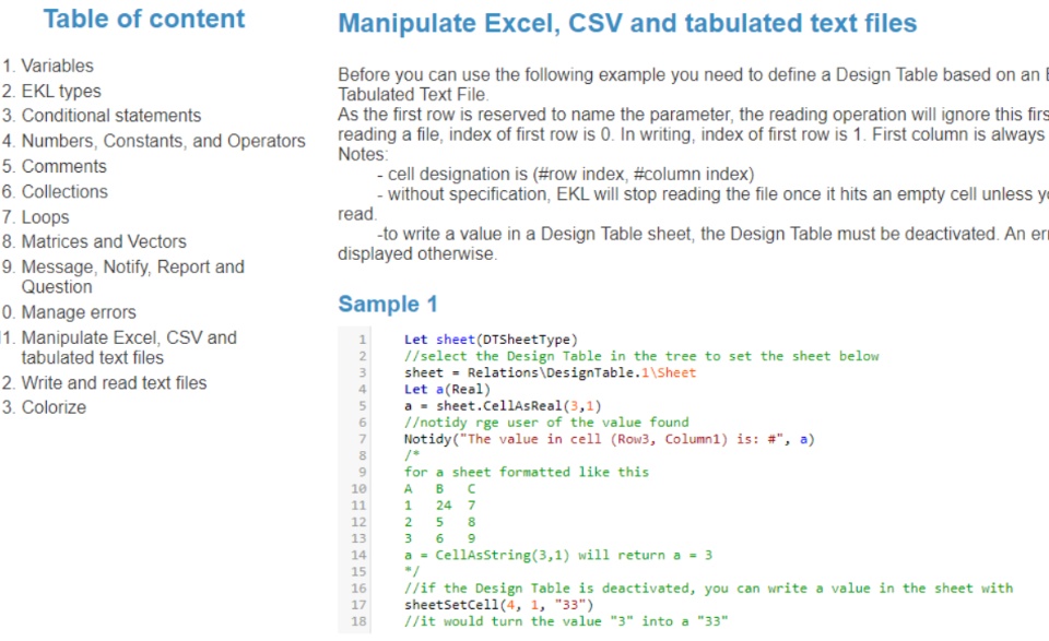

I am trying to create user logic to manipulate a excel sheet. The help getting start of formula & parameter editor has some mistakes.
 the sample1 bellow do not possible to execute. after correct line 3 to "createsheet" and line 7 to "notify", I tried to execute but because the line 17 (missed a dot) the FFS crash and close the app without report information of what cause the crash.
