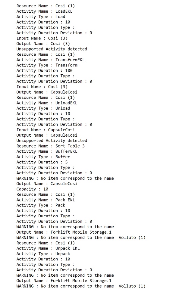

I am wondering if the Generate Model with EKL command is intended to support Load and Unload Activities out of the box.

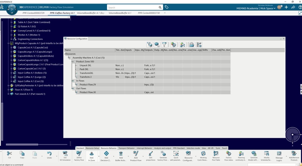

I'm able to get it to populate Transform, Buffer, Pack and Unpack Activities.
I checked the CatKnowledgeTrace logs and got the error message "Unsupported Activity detected''.
I'm not able to locate the script the command is executing (DELSLABehaviorCustomRuleForModel.CATRule) in my installation files to check if Load and Unload are supported.
See attached video and screenshot.
