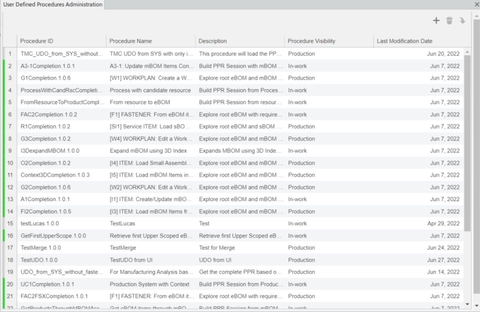

The function is accessible from the PPR Navigation toolbar:
You will see the list of all existing Procedures (in green are the OOTB one, you won’t be able to edit them).
On the top right you will have 3 functions: create, delete, edit

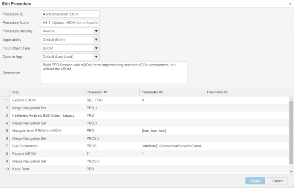

The Procedure screen is divided in 2 parts:
1. The properties
  • ID: please respect the format ... (i.e: myProcedure.1.0.0)
  • Procedure Name: the name that will be visible and selectable in the list of Procedures
  • Procedure Visibility: will impact hide/show in the list depending on the user preferences
  • Applicability: UDO or UDE or both
  • Input Object Type: it is advised to select a input type so the procedure will appear only when the object with same type will be selected. It will help to avoid confusion
  • Open in App: it is possible to specify by default which app to open after execution
  • Description: will be visible in the UI when the procedure will be selected. It can help the user to understand what is it for.
2. The steps
  • One line per step
  • Each output will be in the variable of the number of the same line.
    • Example: in the picture below, the output of "Expand EBOM" primitive will be stored in the variable 1 (because line 1). Then, the second primitive Merge refer to the expanded EBOM by using "1" in the input.
  • For each step, depending on the primitive, one or several outputs will be required. A small help pop-up will appear when the cursor is over a parameter cell.
  • Please refer to UDO - 3 - File Structure description, "Parameters used" to understand when and how to use the main input/output variables (i.e: PRD, SEL_PRD, RSC, SEL_RSC...)
To understand each required parameter, please refer to UDO - 4 - Primitives deep-dive
