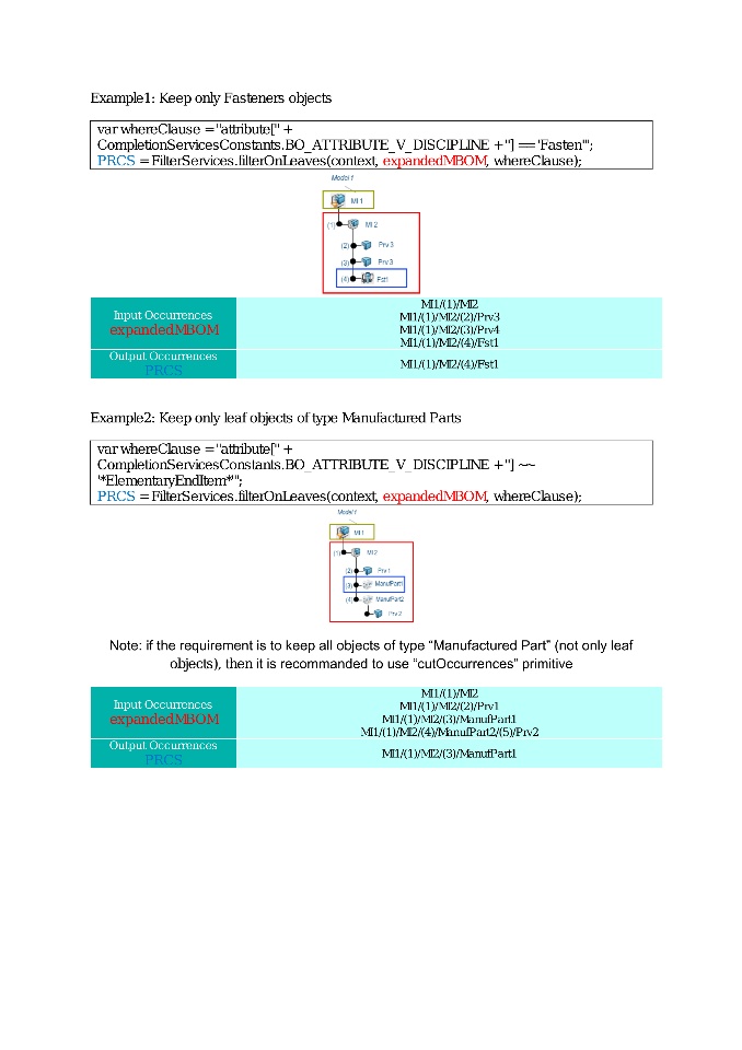

var PrimitiveScope= java.type("com.dassault_systemes.completion.service.ExpandPrimitives");

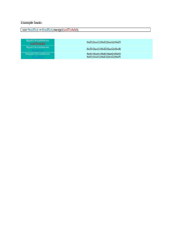

  • Navigation Set Management Primitives
Header: var FilterServices = java.type("com.dassault_systemes.completion.service.FilterServices");
Hereunder are the list of the primitives, their info and a document with some examples/illustrations:

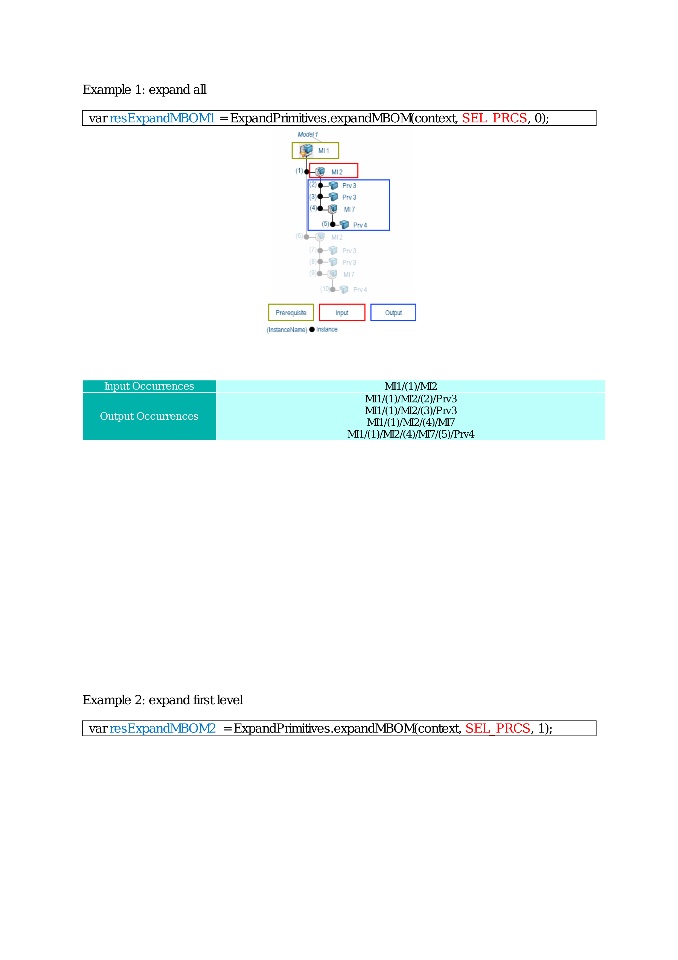

Expand Primitives

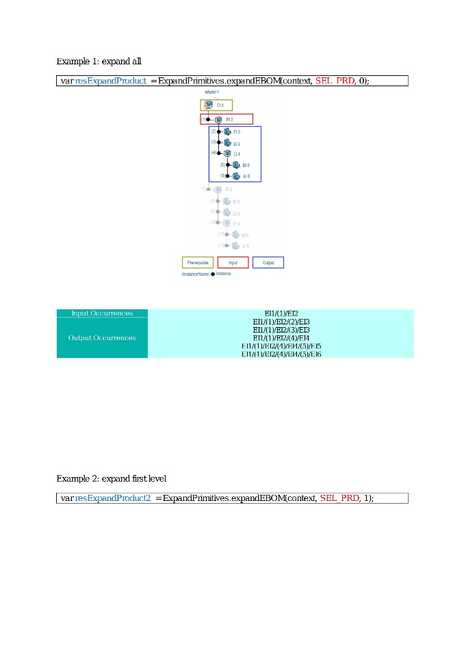

expandEBOM
Expands each Product occurrence in a Navigation Set at the specified level, with a configuration filter if necessary.
Syntax
expandEBOM (CompletionContext ctx, NavigationSet prdInput, int iDepth)
Input
ctx: A Completion Context that contains the configuration filter (declared in the beginning of the CompletionProcedure.
prdInput: A Navigation Set that contains the Product occurrences
iDepth: An integer that defines the expansion depth, that is, the number of levels to expand
Note: If set to 0, all levels are expanded.
Output
A Navigation Set that contains the expanded Product occurrences
expandMBOM
Expands each MBOM occurrence in a Navigation Set at the specified level, with a configuration filter if necessary.
Syntax
expandMBOM (CompletionContext ctx, NavigationSet MBOMInput, int iDepth)
Input
MBOMInput: A Navigation Set that contains the Product occurrences
Output
A Navigation Set that contains the expanded MBOM occurrences

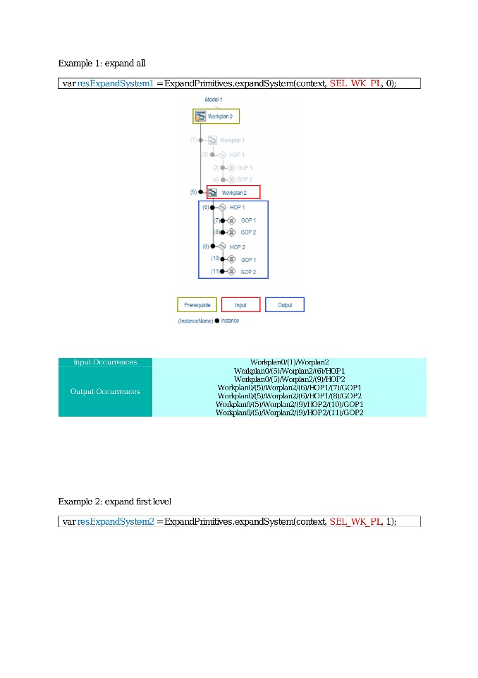

expandSystem
Expands each Workplan or System occurrence in a Navigation Set at the specified level, with a configuration filter if necessary.
Syntax
expandSystem (CompletionContext ctx, NavigationSet systInput, int iDepth)
Input
systInput: A Navigation Set that contains the Workplan or System occurrences
Output
A Navigation Set that contains the expanded Workplan or System occurrences

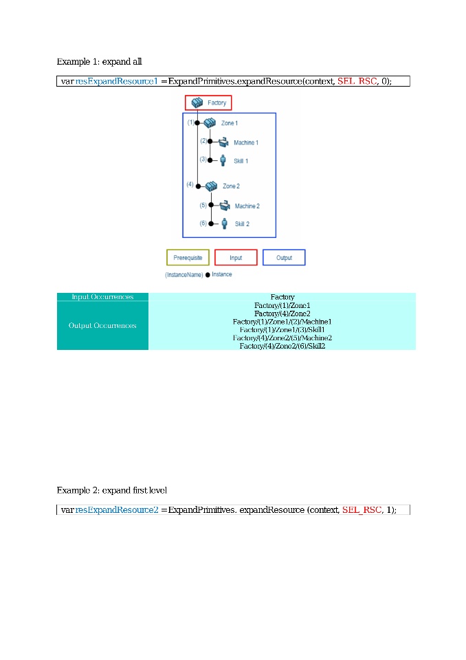

expandResource
Expands each Resource occurrence in a Navigation Set at the specified level, with a configuration filter if necessary.
Syntax
expandResource (CompletionContext ctx, NavigationSet resInput, int iDepth)
Input
resInput: A Navigation Set that contains the Resource occurrences
Output
A Navigation Set that contains the expanded Resource occurrences

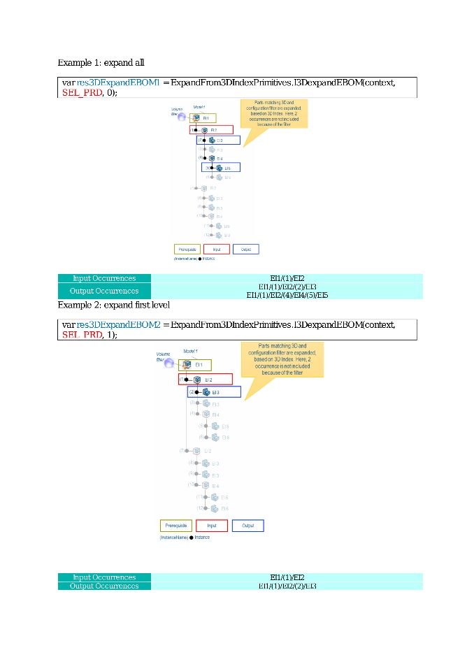

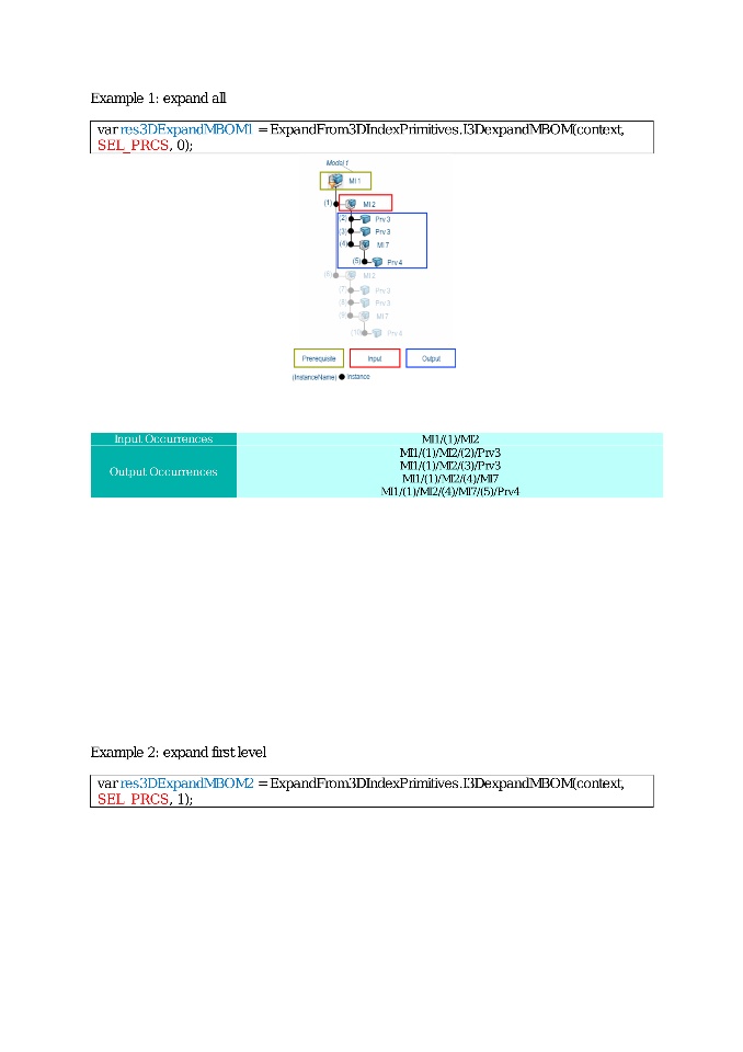

Expand Primitives from 3D Index
I3DexpandEBOM
Expands from 3D Index each EBOM occurrence in an input Navigation Set at the specified level with a configuration or/and volume filter if necessary.
Syntax
I3DexpandEBOM (CompletionContext ctx, NavigationSet EBOMInput, int iDepth)
Input
EBOMInput: A Navigation Set that contains the MBOM occurrences
Output
I3DexpandMBOM
Expands from 3D Index each MBOM occurrence in an input Navigation Set at the specified level with a configuration filter if necessary.
Syntax
I3DexpandMBOM (CompletionContext ctx, NavigationSet MBOMInput, int iDepth)
Input
resInput: A Navigation Set that contains the MBOM occurrences
Output

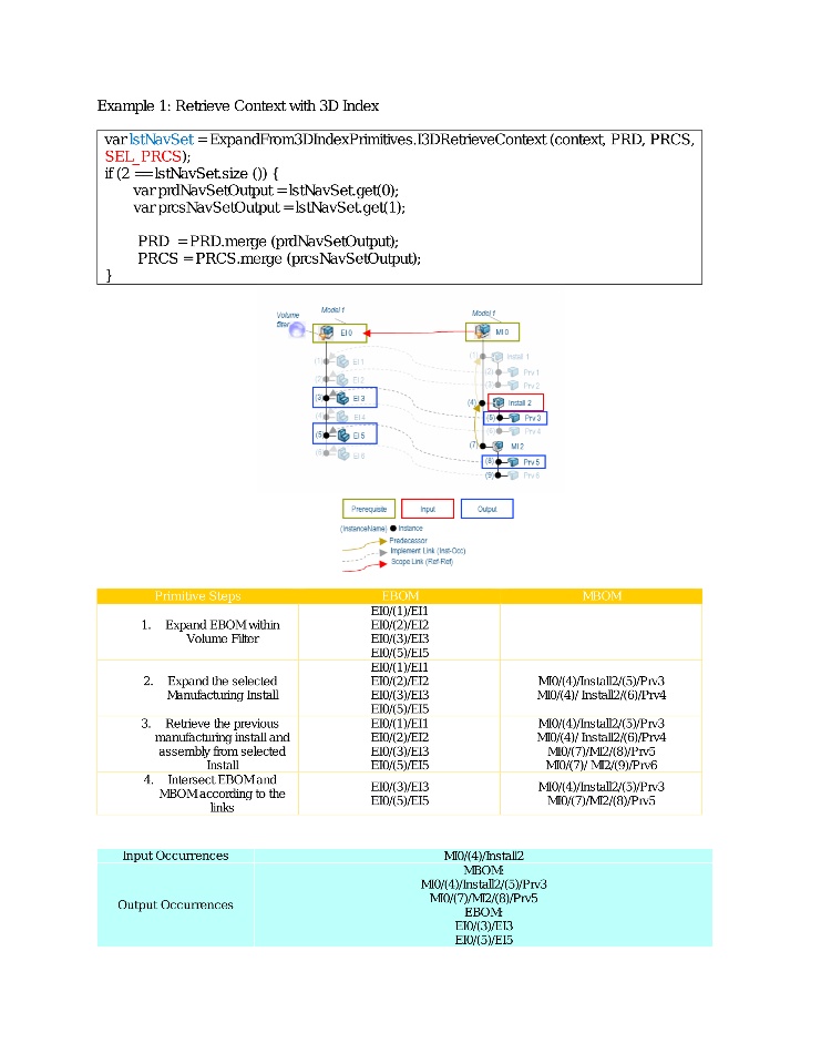

I3DRetrieveContext
Expands from 3D Index all levels, and intersects the EBOM and all the previous MBOM from the selected MBOM input with a configuration or/and volume filter if necessary.
Note: MBOM children from Manufactured Material or Manufactured Part are not retrieved.
Syntax
I3DRetrieveContext (CompletionContext ctx, NavigationSet EBOMInput, NavigationSet MBOMInput, NavigationSet MBOMInputSelected)
Input
EBOMInput: A Navigation Set that contains the EBOM occurrences to expand
MBOMInput: A Navigation Set that contains the MBOM occurrences scoped with an EBOM (usually the root MBOM)
MBOMInputSelected: A Navigation Set that contains the selected MBOM (usually the install MBOM)
Output
A list of Navigation Sets that contains two elements:
  1. The expanded EBOM occurrences
  2. The expanded MBOM occurrences

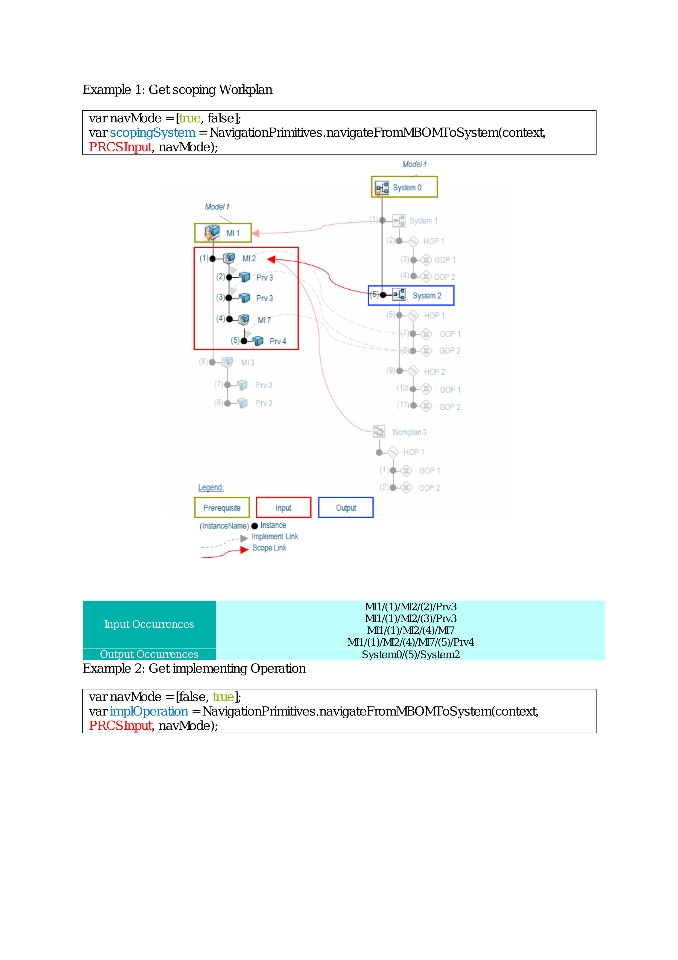

Navigation Primitives

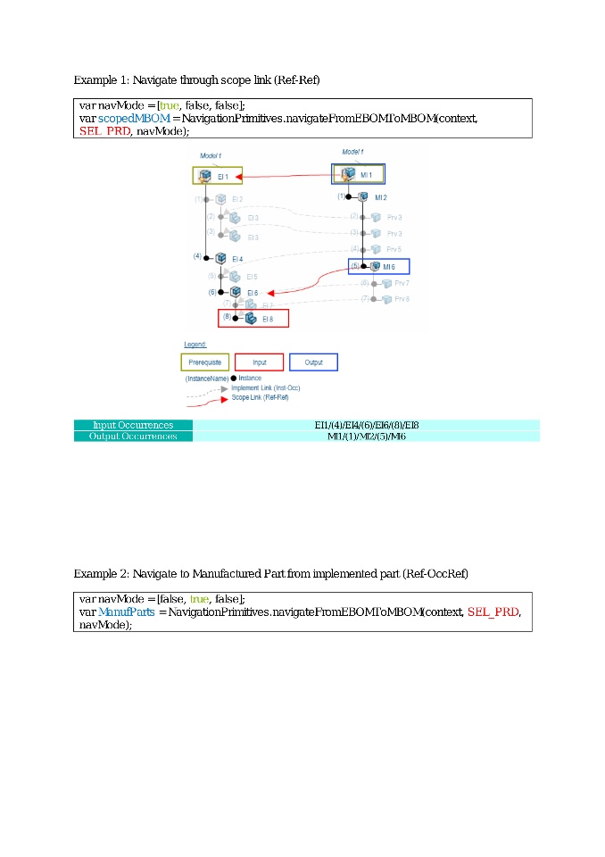

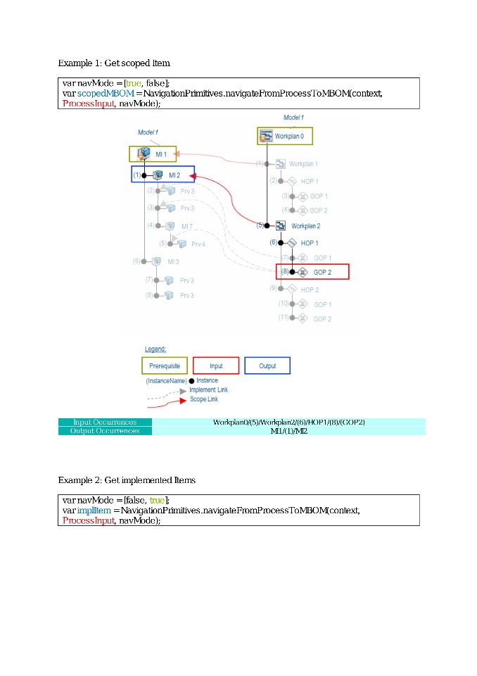

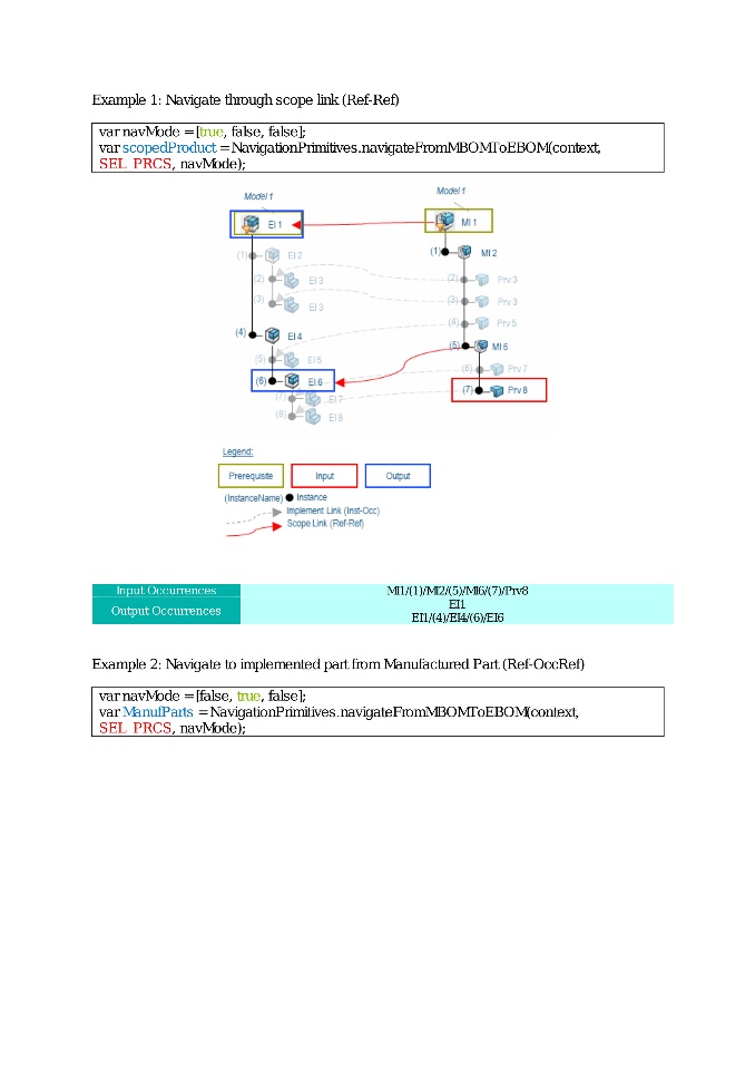

navigateFromMBOMtoEBOM
Navigates from a set of MBOM occurrences to a set of product occurrences through links, with a configuration filter if necessary.
Note: If there is a partial scope linked to the EBOM, then it is ignored.
Syntax
navigateFromMBOMToEBOM (CompletionContext ctx, NavigationSet MBOMInput, Boolean Array navMode)
Input
navMode: A Boolean array that specifies the three navigation modes:
  1. iRef_Ref: If true, navigates on a reference-reference pattern
  2. iRef_OccRef: If true, navigates on a reference-occurrence-reference pattern
  3. iInst_Occ: If true, navigates on an instance-occurence pattern
Output
A Navigation Set that contains the product occurrences
Note:
Known bug: The 2 first parameters in navMode are both merged. This issue is corrected in 20x T15 – FP2203, 21x T12 – FD11 et 22x T1 – FD01

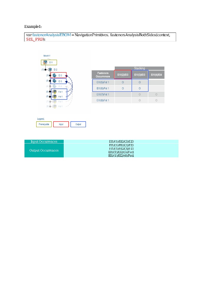

fastenersAnalysisBothSides
Retrieves fasteners occurrences and fastened parts occurrences associated with a product occurrence set through fastener stacking navigation, with a configuration filter if necessary.
Syntax
fastenersAnalysisBothSides (CompletionContext ctx, NavigationSet prdInput)
Input
prdInput: A Navigation Set that contains the product occurrences
Output
A Navigation Set that contains the fasteners occurrences and the fastened parts occurrences

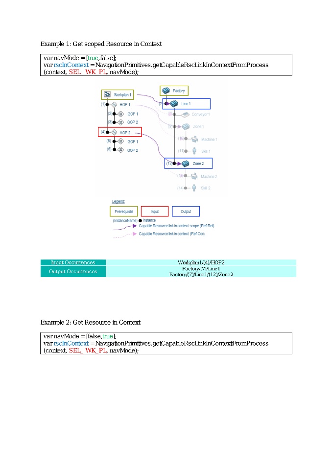

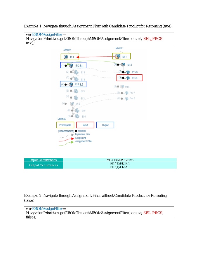

getEBOMThroughMBOMAssignmentFilter
Retrieves the products linked to a set of MBOM occurrences through Assignment Filters links, with a configuration filter if necessary.
Syntax
getEBOMThroughMBOMAssignmentFilter (CompletionContext ctx, NavigationSet MBOMInput, boolean withCandidateProductforRerouting)
Input
MBOMInput: navigation set that contains the MBOM objects
withCandidateProductforRerouting: A Boolean that defines the navigation mode:
If true, navigates through Logical IDs
If false, navigates through Physical IDs
Output
A Navigation Set that contains the Product linked the MBOM occurrences

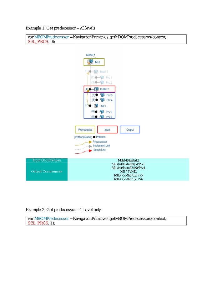

getMBOMPredecessors
Retrieves the predecessors of a set of MBOM occurrences at a specified level, with a configuration filter if necessary
Syntax
getMBOMPredecessors (CompletionContext ctx, NavigationSet resInput, int iDepth)
Input
levelOfPredecessors: An integer that defines the number of levels of predecessors to retrieve
Note: If set to 0, all levels are retrieved.
Output
A Navigation Set that contains the predecessors of the MBOM occurrences
Note: Instance link in the MBOM are considered as Predecessor as well

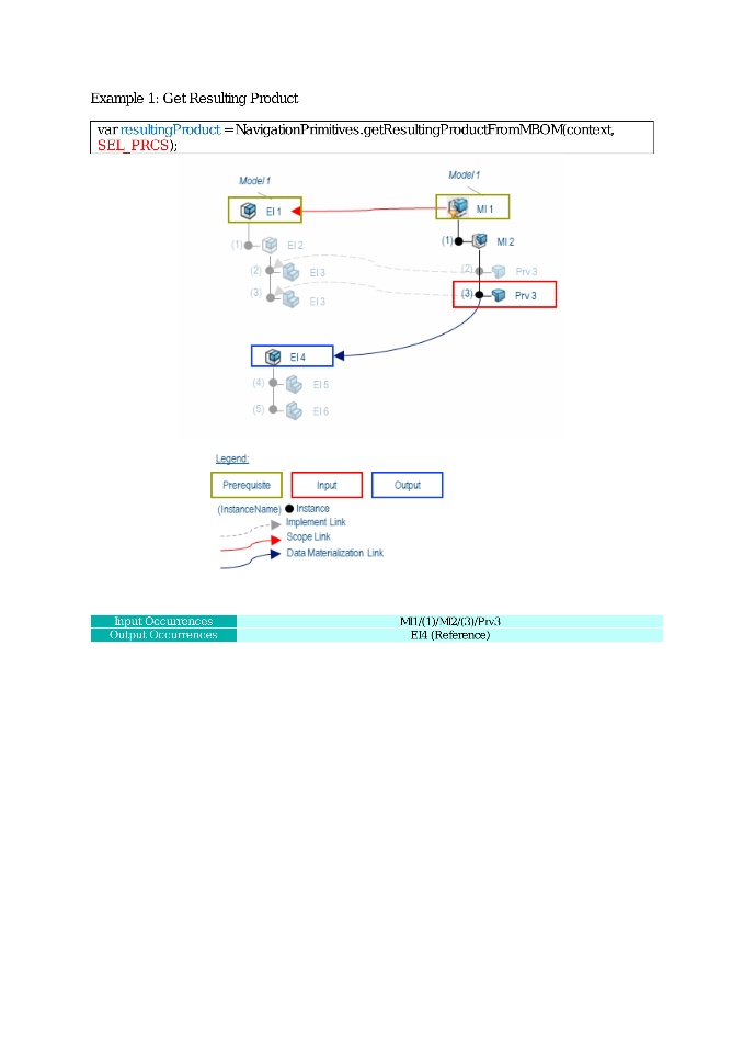

getResultingProductFromMBOM
Navigates from a set of MBOM occurrences to a set of Resulting Product references through data materialization links, with a configuration filter if necessary.
Syntax
getResultingProductFromMBOM (CompletionContext ctx, NavigationSet MBOMInput)
Input
Output
A Navigation Set that contains the product occurrences (containing references only)

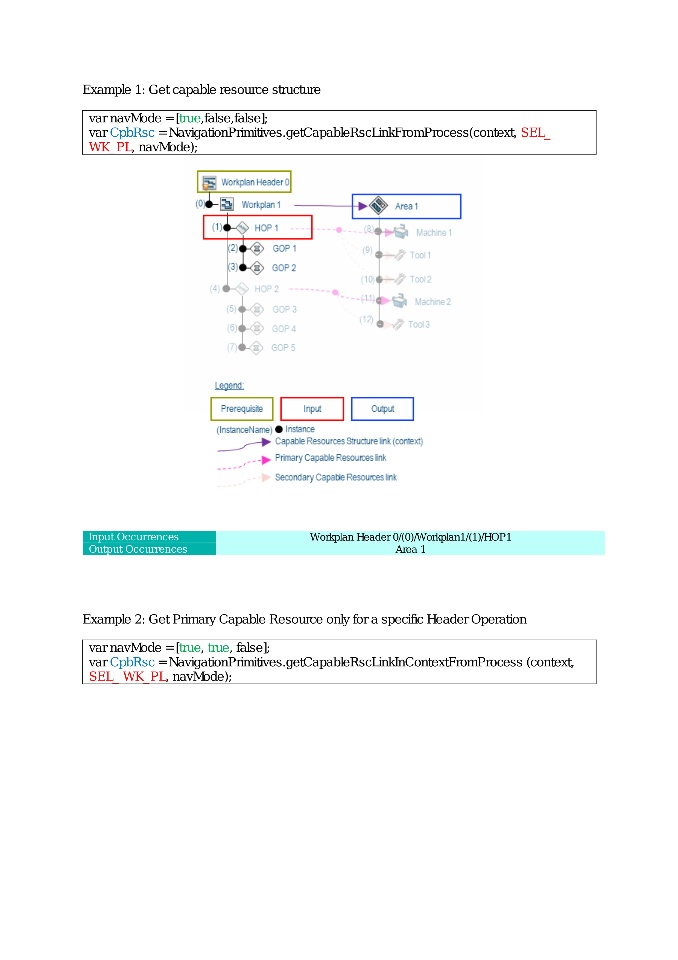

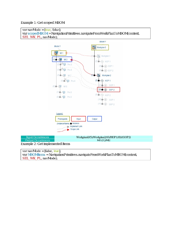

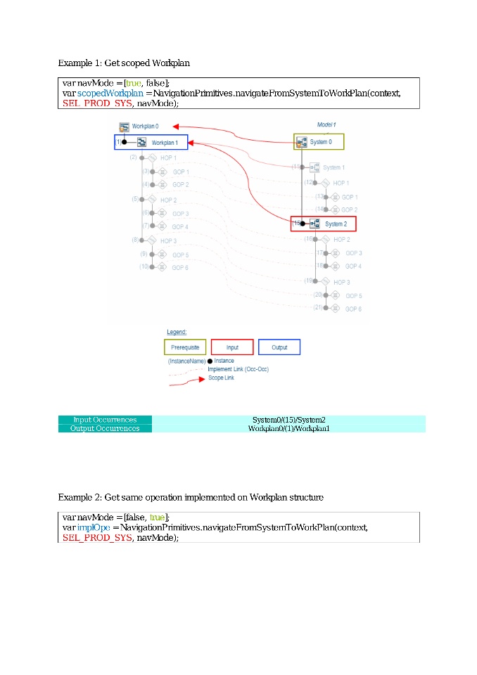

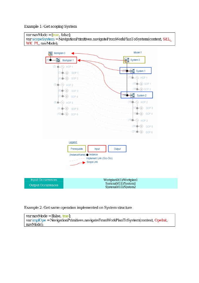

navigateFromWorkPlanToMBOM
Navigates from a set of workplan occurrences to a set of MBOM occurrences through implement links, with a configuration filter if necessary.
Note: this primitives works only for Workplans (and operation under it). It is advised to use navigateFromProcessToMBOM, which works for both Workplan and General System types.
Syntax
navigateFromWorkPlanToMBOM (CompletionContext ctx, NavigationSet wkplInput, Boolean Array navMode)
Input
wkplInput: A Navigation Set that contains the workplan occurrences
navMode: A Boolean array that specifies the two navigation modes:
iOcc_Occ: If true, navigates on an occurrence-occurence pattern
Output

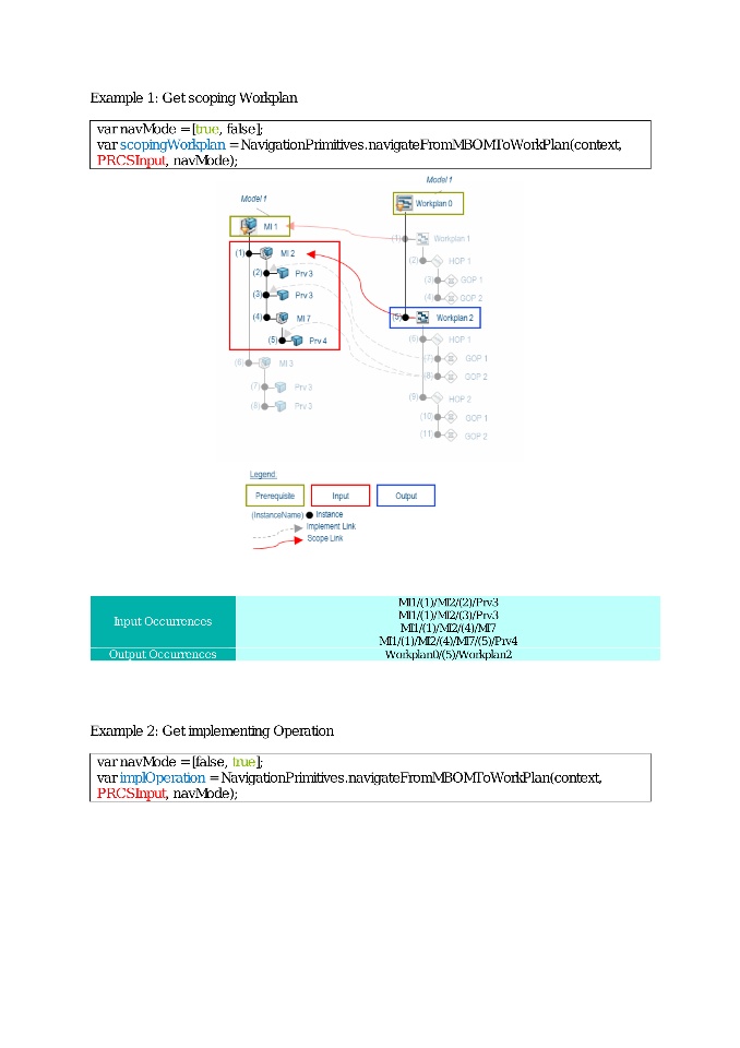

navigateFromMBOMToWorkPlan
Navigates from a set of MBOM occurrences to a set of workplan occurrences through implement links, with a configuration filter if necessary.
Syntax
navigateFromMBOMToWorkPlan (CompletionContext ctx, NavigationSet MBOMInput, Boolean Array navMode)
Input
Navigates from a set of system or workplan occurrences to a set of MBOM occurrences through implement links, with a configuration filter if necessary.
Syntax
navigateFromProcessToMBOM (CompletionContext ctx, NavigationSet systInput, Boolean Array navMode)
Input
systInput: A Navigation Set that contains the system occurrences
Output
navigateFromMBOMToSystem
Navigates from a set of MBOM occurrences to a set of system occurrences through implement links, with a configuration filter if necessary.
Syntax
navigateFromMBOMToSystem (CompletionContext ctx, NavigationSet MBOMInput, Boolean Array navMode)
Input
Output
A Navigation Set that contains the System occurrences
navigateFromSystemToWorkPlan
Navigates from a set of system occurrences to a set of workplan occurrences through implement links, with a configuration filter if necessary.
Syntax
navigateFromSystemToWorkPlan (CompletionContext ctx, NavigationSet systInput, Boolean Array navMode)
Input
Output
A Navigation Set that contains the Workplan occurrences
navigateFromWorkPlanToSystem
Navigates from a set of workplan occurrences to a set of system occurrences through implement links, with a configuration filter if necessary.
Syntax
navigateFromWorkPlanToSystem (CompletionContext ctx, NavigationSet wkplInput, Boolean Array navMode)
Input
wkplInput: A Navigation Set that contains the Workplan occurrences
Output

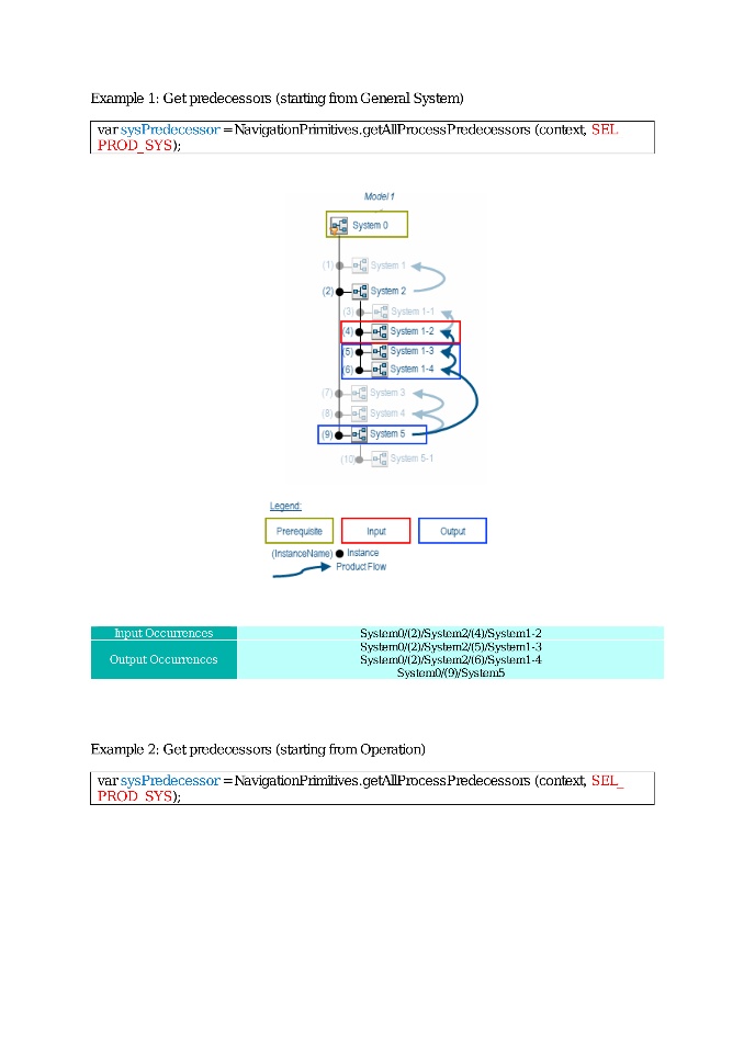

getAllProcessPredecessors
Retrieves all predecessors of a set of system, workplan, or operation occurrences, with a configuration filter if necessary.
Note: only leaf node of each occurrence or branch in the Navigation Set will be navigated
Syntax
getAllProcessPredecessors (CompletionContext ctx, NavigationSet systInput)
Input
systInput: A Navigation Set that contains the system, workplan, or operation occurrences
Output
A Navigation Set that contains the Predecessors of the system, workplan, or operation occurrences
getCapableRscLinkInContextFromProcess
Navigates from a set of process occurrences to a set of capable resources in context, with a configuration filter if necessary.
Syntax
getCapableRscLinkInContextFromProcess (CompletionContext ctx, NavigationSet processInput, Boolean Array navMode)
Input
processInput: A Navigation Set that contains the Process occurrences
iContext: If true, navigates the scope link to retrieve the capable resource in context.
iLink: If true, navigates the link to retrieve the capable resource in context.
Output
A Navigation Set that contains the capable resources in context occurrences
Important: This navigation set can only be merged with a resource navigation set (RSC).
getAssetRscLinkFromWorkplan
Navigates from a set of process to a set of resource asset reference occurrences, with a configuration filter if necessary.
Syntax
getAssetRscLinkFromWorkplan (CompletionContext ctx, NavigationSet processInput, Boolean Array navMode)
Input
iContext: if true, navigates the context link to retrieve the asset structure.
iLink: If true, navigates the link to retrieve the preassigned work center
Output
A Navigation Set that contains the resource asset reference occurrences
getCapableRscLinkFromProcess
Navigates from a set of process occurrences to a set of capable resource references, with a configuration filter if necessary.
Syntax
getCapableRscLinkFromProcess (CompletionContext ctx, NavigationSet processInput, Boolean Array navMode)
Input
iContext: if true, navigates the scope link to retrieve the capable resource structure..
iPrimLink: If true, navigates the link to retrieve the primary capable resource.
iSecLink: If true, navigates the link to retrieve the secondary capable resource.
Output
A Navigation Set that contains the capable resource occurrences (containing references only)
Important: This navigation set can only be merged with a capable resource navigation set (CPBL_RSC)

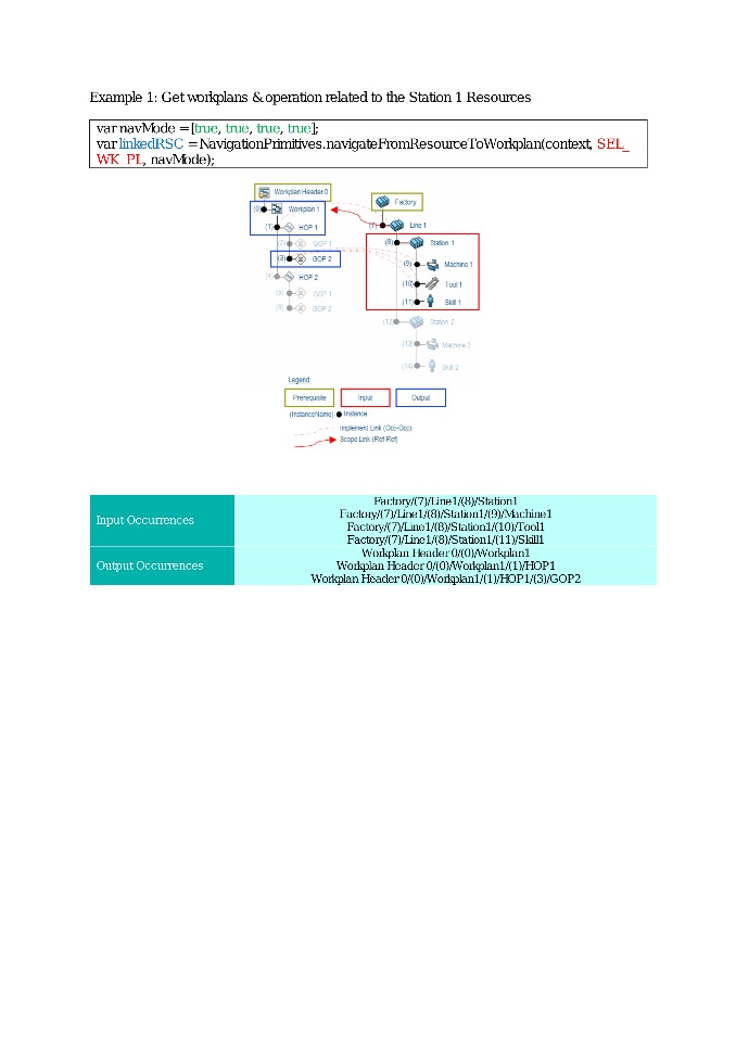

navigateFromResourceToWorkplan
Navigates from a set of resources to a set of workplan occurrences through implement links, with a configuration filter if necessary.
Syntax
navigateFromResourceToWorkplan (CompletionContext ctx, NavigationSet resources, Boolean Array navMode)
Input
resources: A Navigation Set that contains the resource occurrences
navMode: A Boolean array that specifies the four navigation modes:
iRef_Ref: If true, navigates on a reference-reference pattern for the scope
iOcc_Occ_With: If true, navigates on an occurrence-occurence pattern for the "with" resources only
iOcc_Occ_Where: If true, navigates on an occurrence-occurence pattern for the "where" resources only
iOcc_Occ_Who: If true, navigates on an occurrence-port-occurence pattern for the "who" resources only
Output

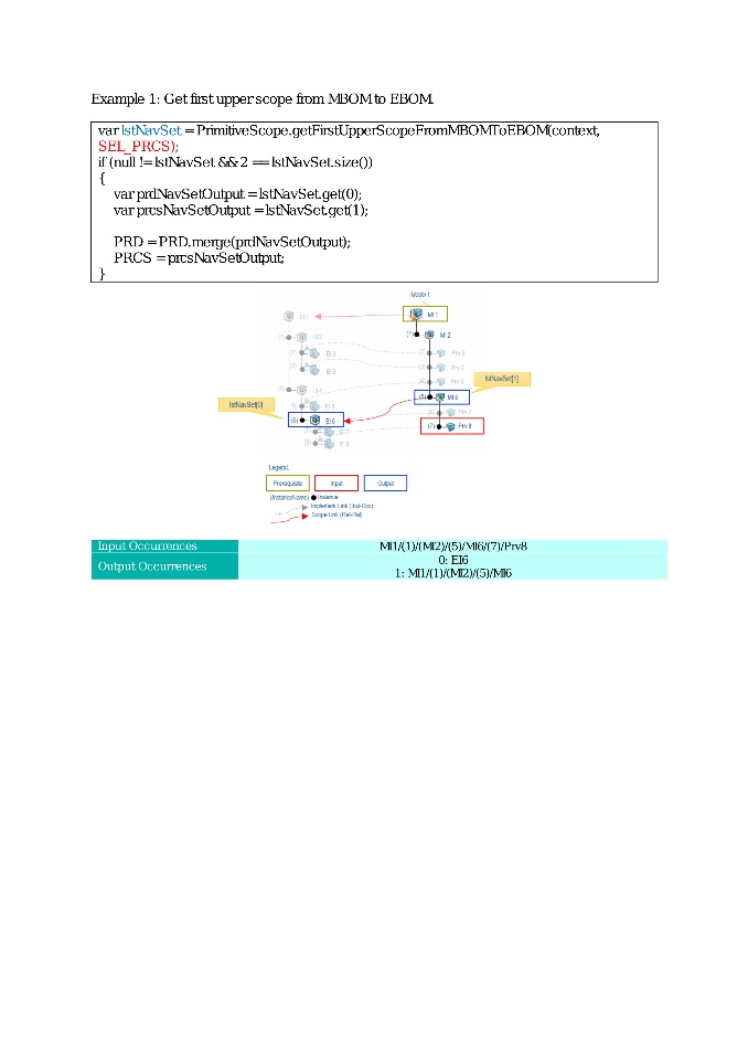

getFirstUpperScopeFromMBOMToEBOM
Navigates from an MBOM occurrence to retrieve the first upper MBOM entity scoped to an EBOM entity, then retrieves the EBOM occurrence.
Recommendation: Use this primitive when the EBOM root is not loaded in the session.
Syntax
getFirstUpperScopeFromMBOMToEBOM (CompletionContext iCompCtx, NavigationSet iNavSetMBOM)
Input
iCompCtx: A Completion Context that contains the configuration filter (declared in the beginning of the CompletionProcedure.
iNavSetMBOM: A Navigation Set that contains MBOM occurrence
Important: This parameter must contain only one MBOM occurrence.
Output
A list of Navigation Sets that contains:
A Navigation Set containing one EBOM occurrence
A Navigation Set containing one MBOM occurrence scoped with the EBOM occurrence
Notes:
  • If several scope links exist, then the primitive stops and raises an exception.
  • The primitive does not check if the MBOM occurrence given as input in iNavSetMBOM has a scope to the EBOM. Upper scope identification starts on the first MBOM parent of this occurrence.

Merge
Inserts a set of occurrences into another.
Note: The type of NavigationSet should be the same to be merged together
(example: if you try to merge an MBOM set with a EBOM set, it will get an error)
Syntax
merge (NavigationSet input)
Input
input: the Navigation Set to be inserted in the one output from the previous primitive
Output
A Navigation Set that contains both Navigation Sets

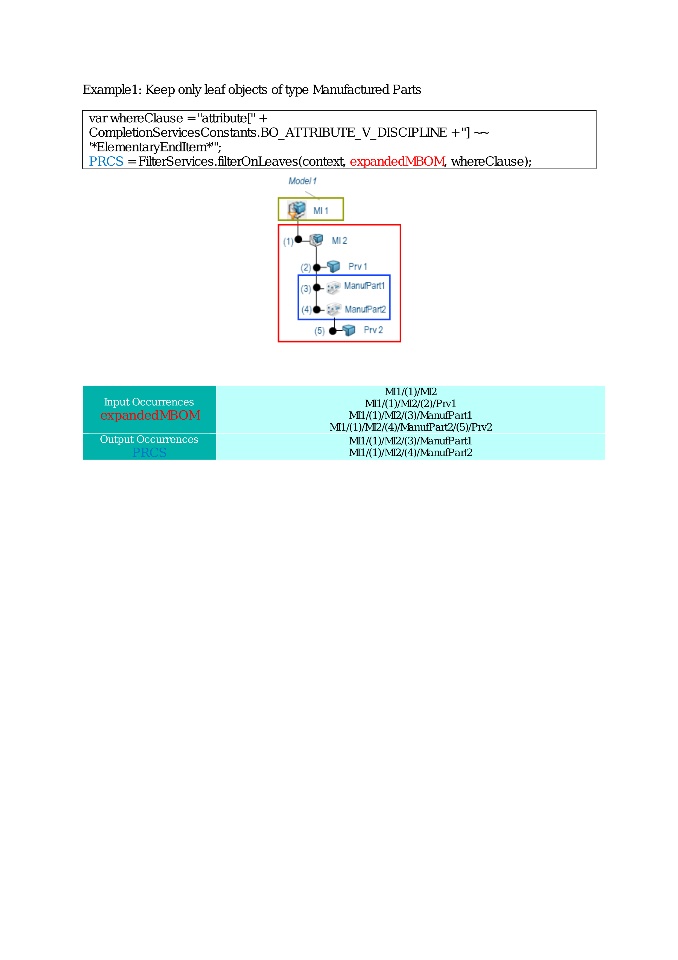

filterOnLeaves
Filters a set of occurrences by applying a WhereClause criteria to their final references (leaves), with a configuration filter if necessary.
Syntax
filterOnLeaves (CompletionContext ctx, NavigationSet inputNavSet, java.lang.String whereClause)
Input
inputNavSet: A Navigation Set that contains the occurrences to filter
whereClause: The WhereClause to apply to the final references (leaves)
To see more example of whereClause, please refer to DSDoc.
Output
A Navigation Set that contains the filtered occurrences
