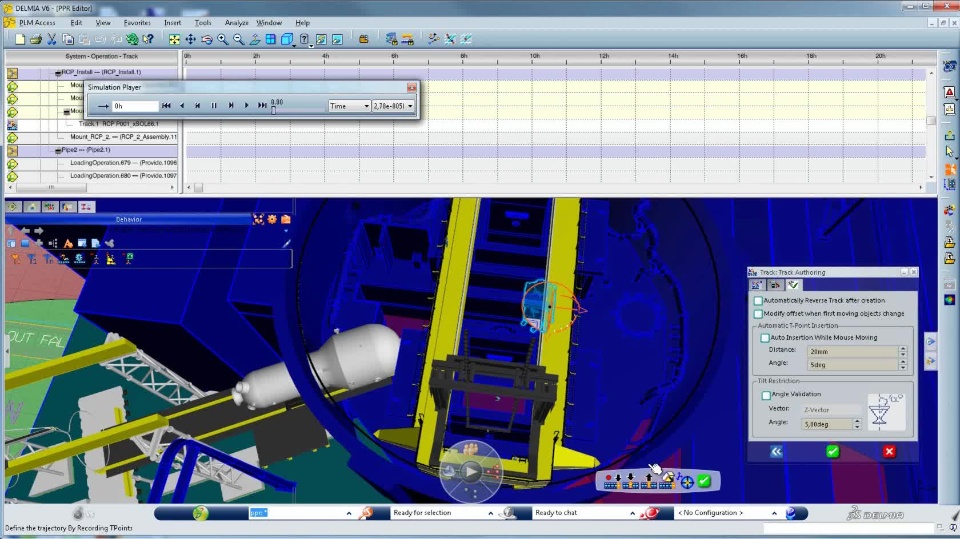

Actually, I'm engaged on Customer PoC which  have heavy 3D Data ( Off shore Platform ), with Complex Planning sequencing; At the beginning  of PoC ( June 2013) , Compile Build Up has taken 25 min,  after selected 1 operation.
Today with HF21, 10s at first time, after 1 or 2sec !!!
And same amazing performance improvement with Dynamic Clash. Before HF21,  when you wanted to create analysis clash, it wasn't impossible to use Dynamic Clash  and particularly with Track process definition in Assembly Path Simulation. The Work around was to create Simulation Object and create Group list of Colliding.
With this improvement, you can  directly create Dynamic Clash ( see video below) in Assembly Path Simulation.
Thanks a lot DELMIA  R&D Manufacturing Planning Team for this great job which deliver incredible performance compare to before.
