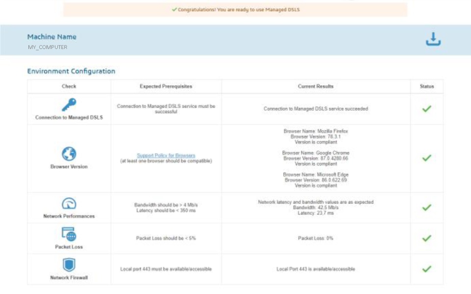

To check them, DS offers Managed DSLS Eligibility Checker tool (available for download here).
That tool is supposed to be launched only from computers running Ortems processes, whatever they are user computers or computers running Interface loop with Ortems (for example in context of Citrix usage, only the Citrix server runs the processes, therefore our Eligibility checker tool requires to be launched only from that computer).
Example of returned result window:
In case of issue
A red flag is displayed on one or several checking), you can refer to this post focusing Eligibility Checker tool

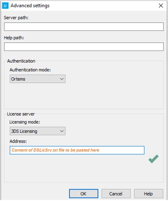

Configuration of DELMIA Ortems to switch on DSLS license keys
  • Open the DELMIA Ortems “Environment management” module
  • Navigate to Administration > Advanced settings

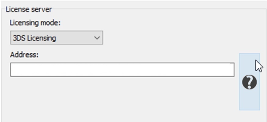

  • Set the “Licensing mode” choice to 3DS Licensing
​​​​​​​At this step, the interesting file is DSLicSrv.txt (reminder: this is the file created by you as explained in the message). Edit it with Notepad.exe, copy its content and paste it to “Address” field.
Click on the test license server button to check the installation:

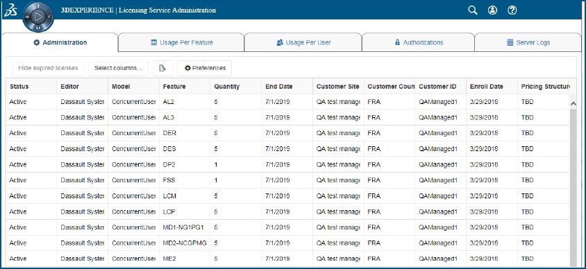

How to know the details of the customer's license keys hosted on DS servers?

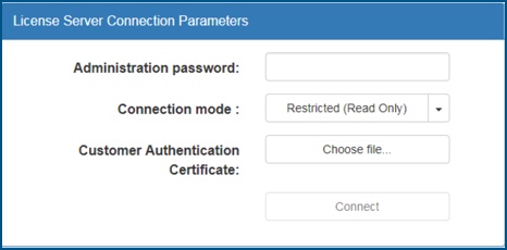

In the message sent to the customer, a link is provided to perform some "Advanced Administration Tasks" .
This Administrative URL is for connecting directly to the license service Administration web user interface.
Note: for security reasons, the URL provided for web administration needs a first connection to Dassault Systèmes' servers through a 3DPassport login.
Via Admin tool, Customer Administrator can:
  • Add authorization rules (User, TCPIP range)
  • Configure license expiration alerts
  • Get currently in-use license information
  • Change passwords
  • Consult logs stored on the license server
