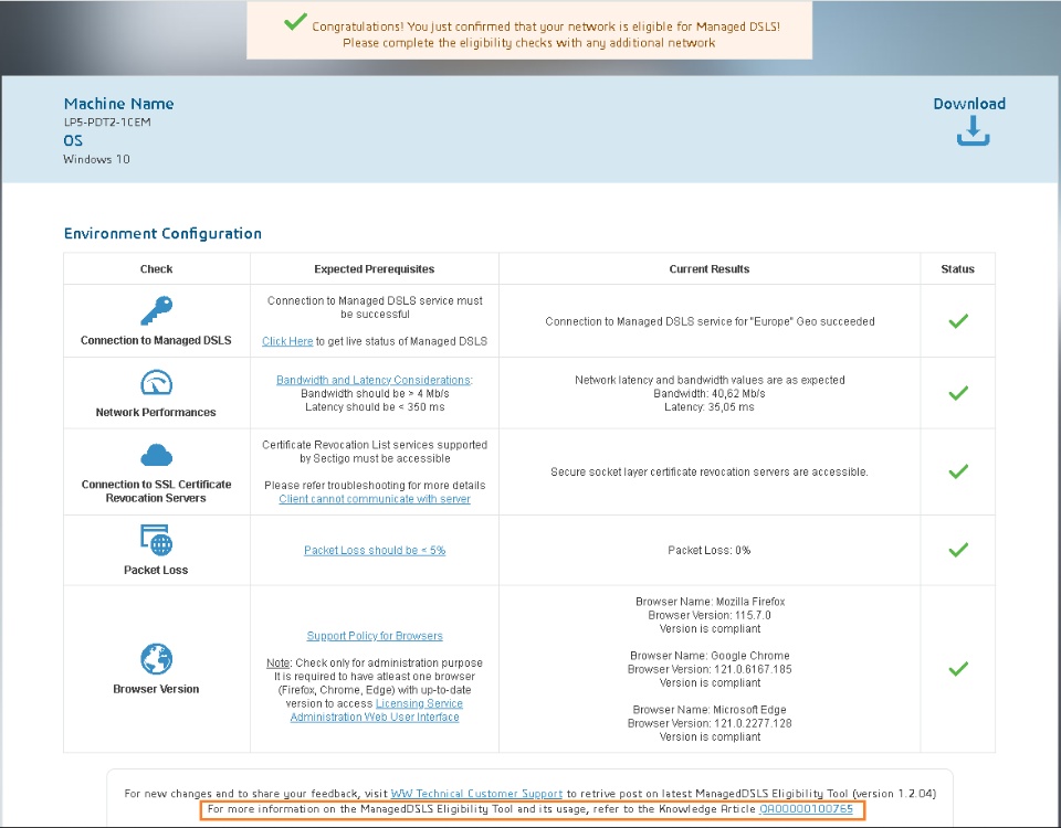

For that our Eligibility Checker tool (downloadable from https://www.3ds.com/support/cloud/eligibility/managed-dsls) makes the job.
Eligibility checker evaluates if a computer (this concerns all the computers that are running Ortems processes) is eligible to Managed DSLS and after analysis, returns a screen similar to the following one:
In case of issue to solve
you will see a red flag in the “Status” column. Of course, some explanation and solution can be found in the “Expected Prerequisites” column that offers a hyperlink for that.
However sometimes it does not allow to solve the issue
. Then it is possible to follow the link “QA00000100765” at the bottom of the screen: that Question&Answer (QA) offers a full presentation of our Eligibility Checker tool (Why - When - What - How). At the end, you will find the ‘ASSISTANCE’ chapter that contains the instructions for further assistance:
