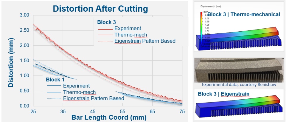

Take a look below at the residual stress comparison between the Eigenstrain results with the standard Thermo-mechanical manual set-up results. They are almost coinciding in the graph, thus proving the Eigenstrain method of analyzing a print is as good as doing it the elaborate Thermo-mechanical way. The block experimental test data provided by Renishaw compares these 2 methods.
