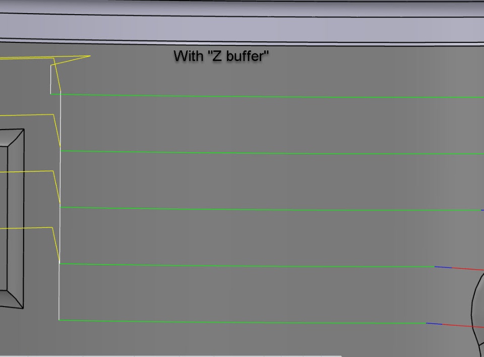

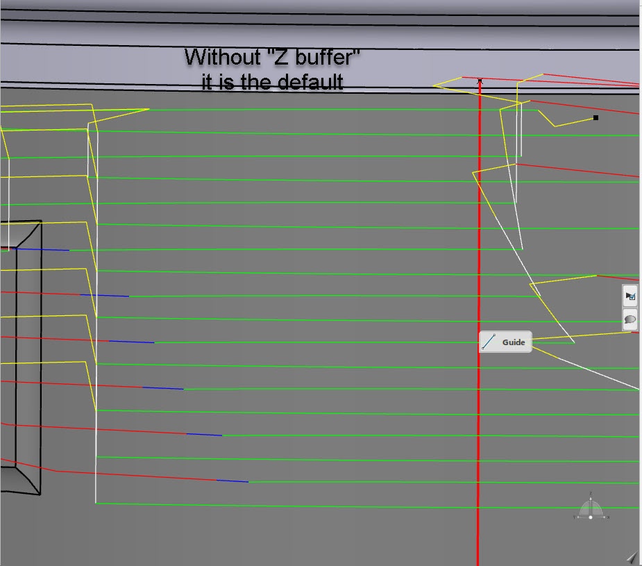

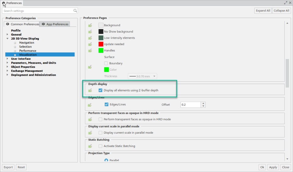

Do you know the display using “Z- buffer” depth ?
With this option you are able to display only the “visible’ toolpath according the part orientation.
This option can be very usefull in Roughing, Zlevel, tube machining, 4 axis pocketing ... to have a better understand the toolpath before any removal material simulation
