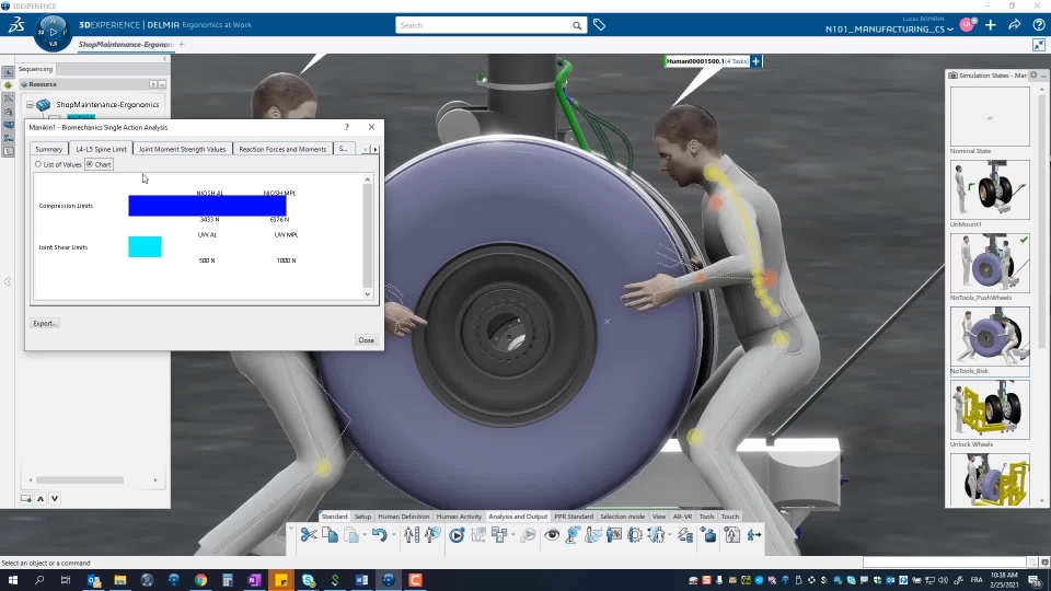

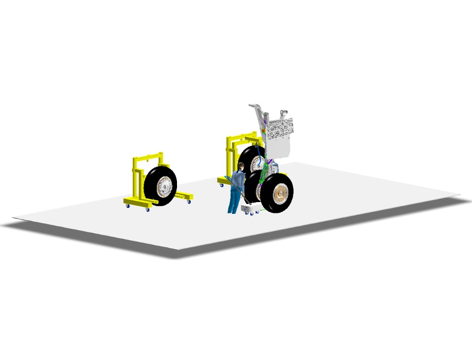

I would like to share with you an example where a manufacturing uses ergonomics application to validate a maintenance activity.
With the following video, I am using the 3DEXPERIENCE platform to highlight potential risk for the operator when performing a maintenance task. The risk is usually assessed through an effort and a postural analysis. Then, I am using 3D simulation to find a better way to perform the same task using dedicated tooling.
