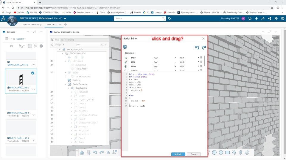

It would be great if I could move and resize the script editor dialog box. Possibly even run the script without closing the dialog box itself.

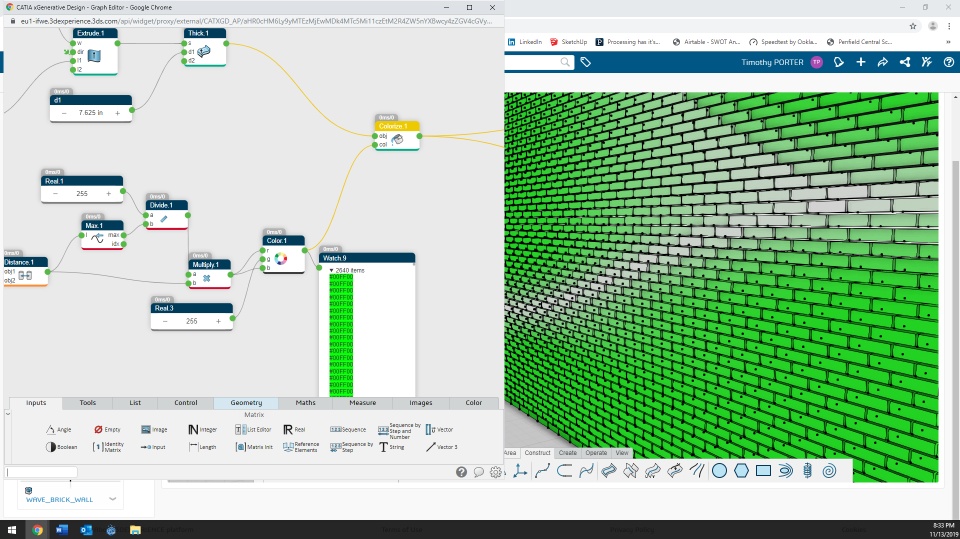

The coloring features are nice but could be a bit more intuitive. It would be great to have more nodes to simply select a gradient and apply to a field of values. This particular example i was attempting to get the wall to transition from green to red but settled on the simpler gradient.

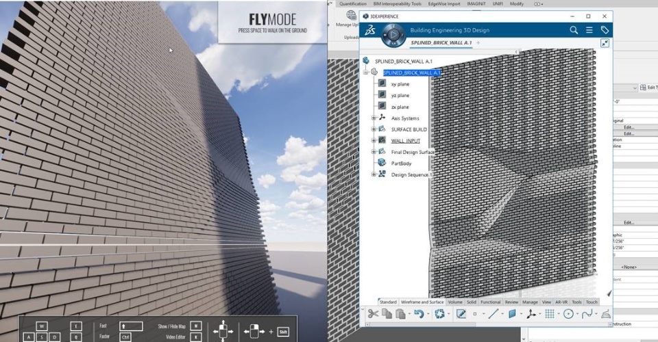

In this sample, I’ve developed a spline like brick pattern from which I need to extract individual brick corbel values that can be sent to a robotic brick laying machine. In order to extract the corbel value, I had to develop a UDF that was noting more then a point and a measure back to the wall plane with a published parameter that I can link to a spreadsheet in the rich application. It would have been great to have a node that simply exports the list to the first column of a spreadsheet.
