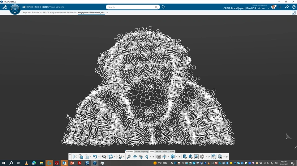

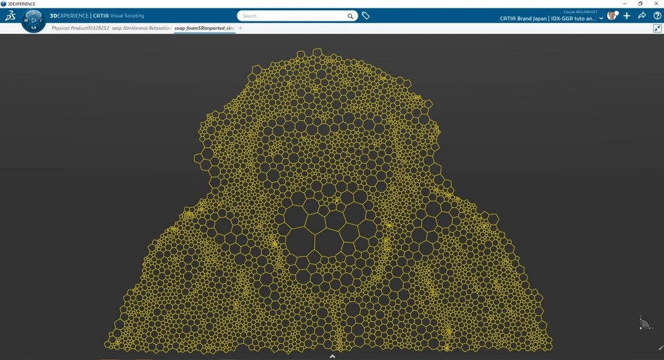

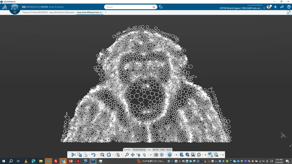

my starting mesh is this one
But the incircles of this mesh are not at all tangent to each others,
  1. Optimize the mesh to get a triangular mesh with tangent incircles.
to make it tangent use Circle Packing from mesh. Then you get entire Circle packging from mesh.
Now you need to get rid of the circles that are not INCircles.

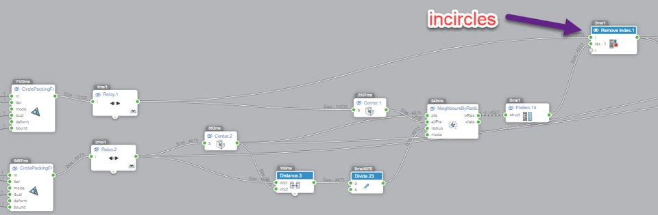

To do that,
  1. create dual circle packing of the initial "Circle packing from mesh"
  2. get all the centers of the dual circle packing
  3. get all the centers of initial "Circle packing from mesh" that are close to a center of the dual circle packing
  4. and get rid of their circles in the initial "Circle packing from mesh"
    then you only get the circles that are INcircles of deformed mesh.
    I hope that in future we can also output the deformed mesh to easily retrieve the incircles only.
    only the incricles of a triangular mesh - they are all tangent!!!!

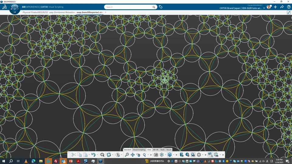

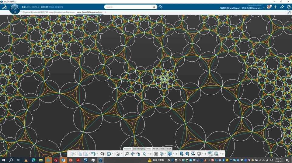

2.create the pedal triangles of the incenters

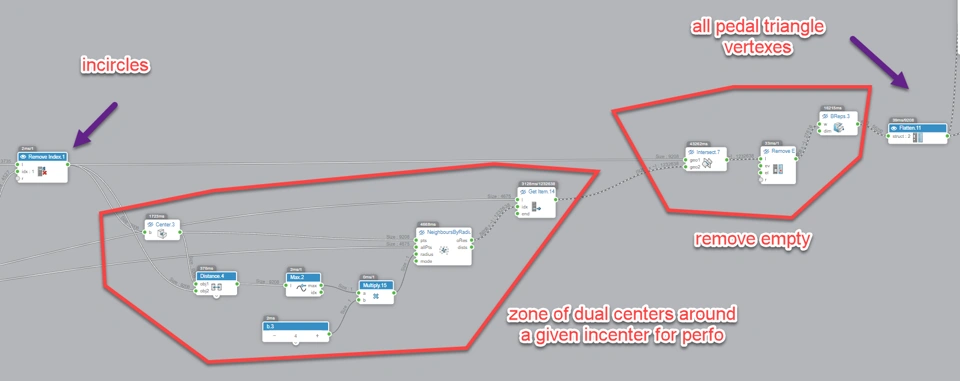

  1. For Each INCircles, get all its intersections to the Dual circles
because of performance, I do it only for a limited zone around each INCircles,to limit the number of Intersection to calculate

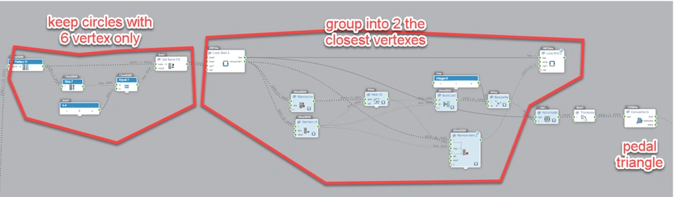

the intersections correpond to the vertexes of the pedal triangle of the INCenter.
I keep only the circles with 6 intersections and I group the intersections by 2 closest points and keep only 1 point per group.
then in the end, I get 3 points, the vertexes of all the pedal triangles.
comment: Cluster function could used, but it is not so easy to set the tolerance, so I made a loop to group the points.
in white, INCIRCLES - in yellow, DUAL CIRCLES
Pedal triangles in green

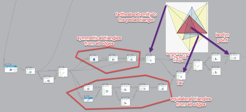

3. create the isodynamic points of the pedal triangles
I follow the method indicated in Wikipedia
Go to Construction Section
there are other methods, but this one gave best result
in RED, the isodynaic points

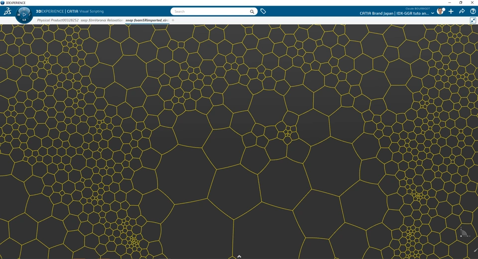

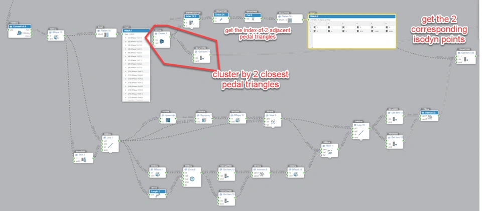

4. Create an arc circle of the adjacent incenters and pedal triangle vertex in between
I have to cluster all the pedal triangle vertexes into 2 closest points.
from these points I get the index of their respective pedal triangle and then of their respective isodynamic points.
In the end, I have grouped 3 points: 2 neighbouring isodynaic point and the pedal triangle vertex in the middle
those points are used to create the arcs.
I also removed by hand the arcs not connected to the mesh. (4 arcs in this case)
ORANGE: arc circles - all 120deg!!!
