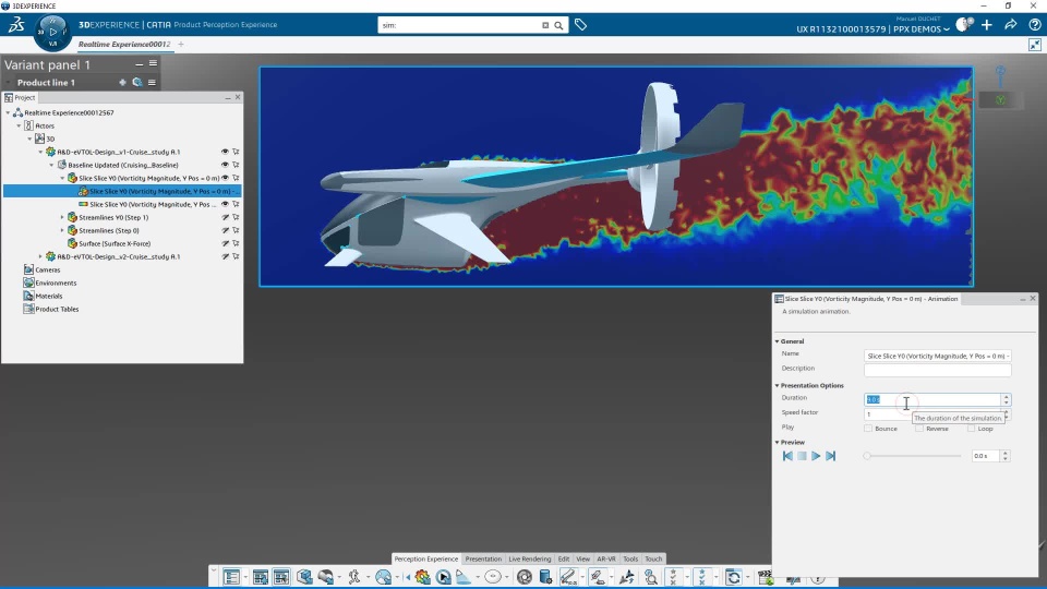

Here is now a tutorial video showing the basic steps to create this new type of variant, Simulation Result Variant, enabling to:
  • Easily show one set of results or another, or both for comparison purposes
  • Set the result animation parameters (duration, loop...)
  • Create a simulation result variant from 1 or more results
  • Explore the results in presentation mode while playing the animations
PPX R2022x | How to create Simulation Result Variants
