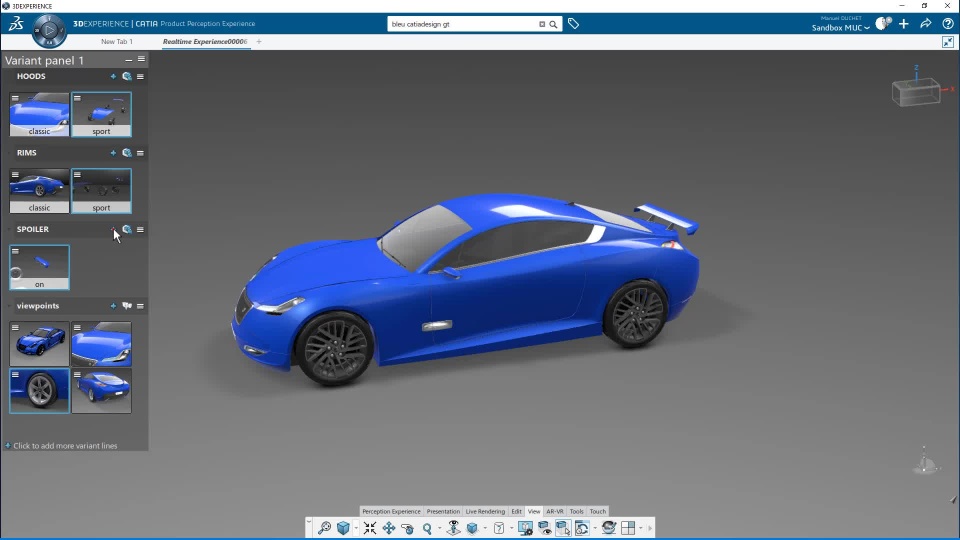

1. How to create variants
The 1st one goes through the authoring basics of creating Product and Viewpoint variants in order to present a design project and explore its alternatives.:

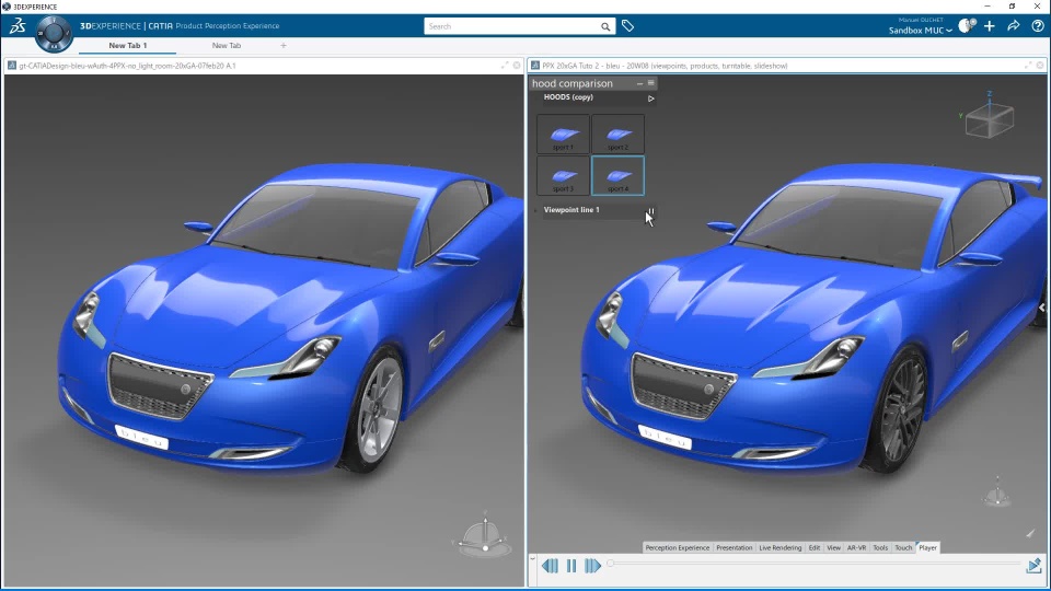

2. How to take decisions. And remember it.
This 2nd video focuses on decision-making functionality:
  • Side-by-side comparison, using the cross-app command Link Dynamic Cameras
  • Validation options, to approve or reject a variant, or simply set it as favorite
On the way it shows how to:
  • Copy/paste a variant line from one panel to another
  • Make the variant panels smaller
  • Change the timing of the animations

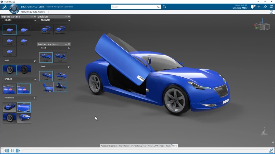

3. How to present concepts of product animation
The 3rd video focuses on presenting design animation concepts, eg. a butterfly door opening, by:
  • Creating Position variants
  • Defining new pivot axis system
  • Setting object as trigger to activate variants and start the animations
The goal of such features is for a creative designer to create several animation concepts in a couple of hours, which, even if not physically correct, still look good enough for an audience to get the idea and decide for the most relevant alternatives.
