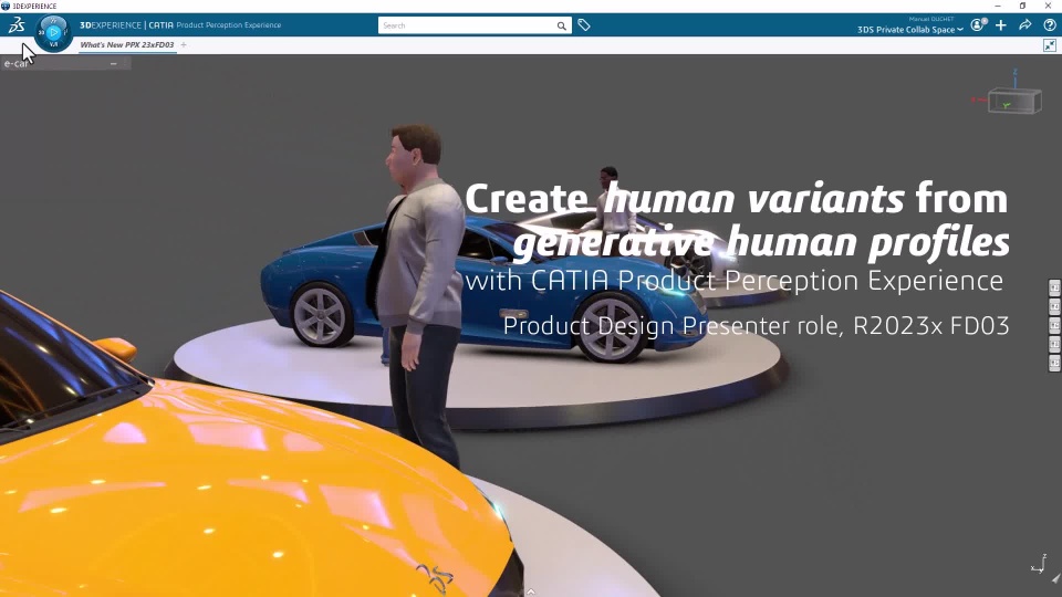

The first video shows in 7 steps how one can easily create human variants from the profiles of a generative human, along with creating another set of human variants from its animations. It is fairly similar to the video in the wiki, but with a few more detailed steps and tips & tricks.

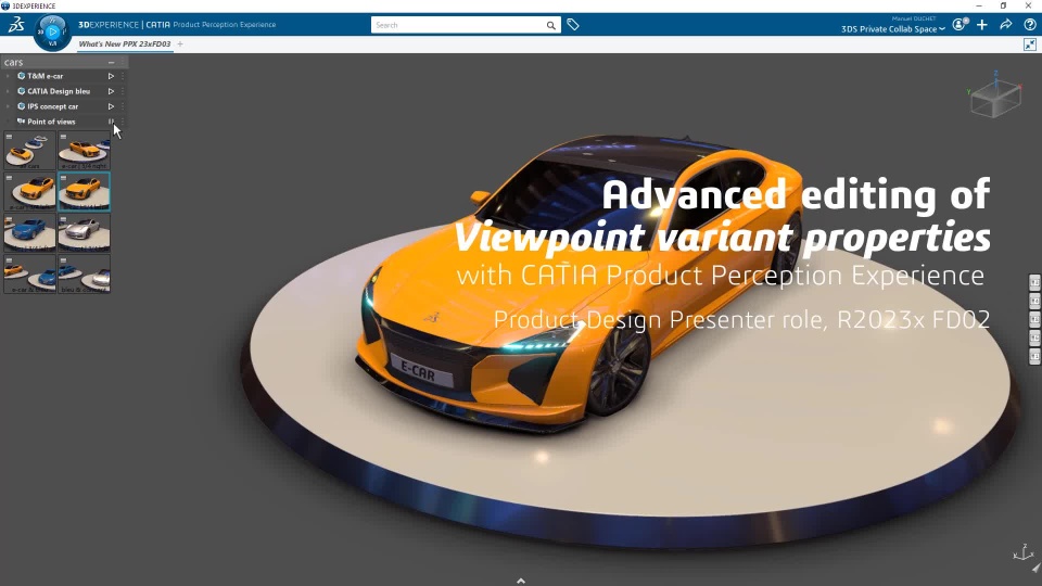

The second video is about an important feature released in R2023x FD02: the editing of the Viewpoint variant properties. The video covers some important aspects of the functionality which are key to understand, for examples:
  • The use of the Properties panel to access the detailed definition of Viewpoint variants
  • How to exit the workflow of editing Viewpoint variants, and go back to editing actor's properties
  • The live update of the viewpoint variant definition while navigating or using the view voodoo

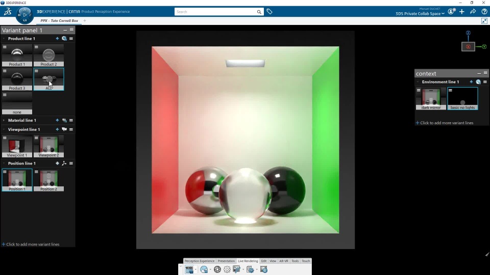

Here is a 14' step-by-step video showing pretty much in real-time how I used a basic Cornell box to get mesmerized by interactive Stellar global illumination, not only in authoring mode, but also in presentation mode with object and light animations 🤓
NB: I can also provide the 3DXML file of the Cornell box if you'd like to give it a try by yourself. Just go to the Conversation tab and start one with me :)
