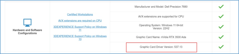

New Graphics card:
New driver version “537.13” is validated for all NVIDIA certified workstations. Tool does take this change into account, as you can see in below screenshot.
Please refer the certified HW/SW link for more details.

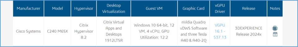

Changes in Certified Configuration for VDI
As per the Certified Configuration for VDI, New vGPU driver version 16.1- 537.13 is validated for most of the VDI configurations. Please refer the Certified Configuration for VDI for more details.

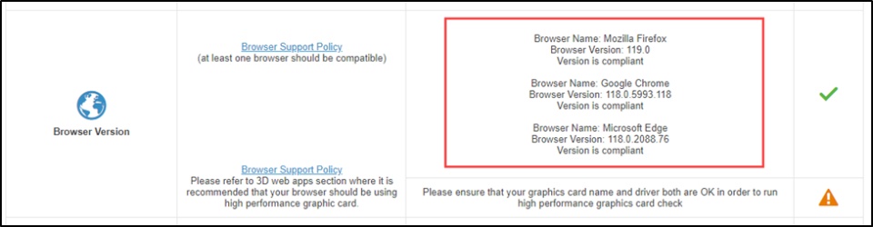

Changes in Browser Version:
As per the Platform Support Policy, for 3DEXPERIENECE Platform on cloud, the most current stable channel release of the Google Chrome and Microsoft Edge Chromium, is a Compatible Platform. For Mozilla Firefox 102esr is a validated and compatible platform. Please upgrade your browsers to the channel releases as per below:
Google Chrome:
The most current stable channel release of the Google Chrome is Version 118.0.5993.118 Official Build for both 64-bit and for 32-bit. Hence your browser version should be greater than or equal to above mentioned channel release to be compatible with platform.
Microsoft Edge Chromium:
The most current stable channel release of the Microsoft Edge Chromium is Version 118.0.2088.69 (Official build) (64-bit). Hence your browser version should be greater than or equal to above mentioned channel release to be compatible with platform.
Mozilla Firefox:
For both 64-bit Mozilla Firefox and 32-bit Mozilla Firefox 102esr is a Validated Platform. Hence your browser version should be greater than or equal to above mentioned channel release to be compatible with platform.
Cloud Eligibility Checker Tool does take these changes into account, as per below:

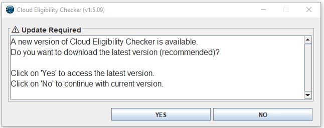

Version Update Warning:
This is a new enhancement added into the Cloud Eligibility Checker Tool (v1.6.01), which will show a warning pop-up message to the user if they are using the outdated version of Cloud Eligibility Checker Tool. It will make sure that user is using latest version of the tool to check eligibility for 3DEXPERIENCE Platform on Cloud.
Workflow:
When user is using outdated or older version of tool,
A pop-up message (refer the image 1.1) will be displayed asking user to choose the options as per below,
- Click on “YES” to access the latest version of Cloud Eligibility Checker Tool.
- Click on “NO” to continue with the current version of Cloud Eligibility Checker Tool.
It is recommended to use the latest version of tool.
(image 1.1)

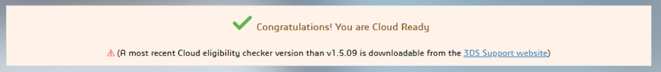

In case user continues with the older version of tool, a warning message would be displayed in final HTML report (refer image 1.2)
                         (image 1.2)

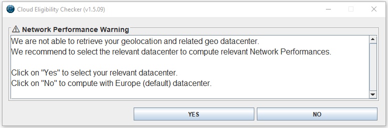

Default Datacenter Selection Warning:
            For the Network Performances Check, The Cloud Eligibility Checker Tool is using geolocation URL: https://geolocation-db.com to retrieve the user location.
In case the user do not have access to the geolocation URL due to some proxy, firewall, VPN, etc. issues, then tool is configured to select Europe (default) datacenter and compute the relevant Network Performances.
Now with this enhancement, the user will be asked to select the relevant data center when the geolocation URL is not accessible.
Workflow:
When users do not have access to the geolocation URL https://geolocation-db.com
A pop message will be displayed (refer to image 2.1), asking the user to choose the options below,
- Click on “YES” to select the relevant datacenter
- Click on “NO” to continue with the Europe (default) datacenter
     (image 2.1)

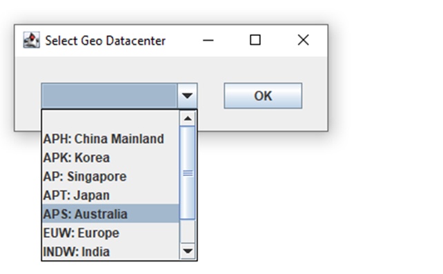

If the user clicks on “YES”, then a separate dialogue box will appear (refer to image 2.2) which will ask the user to select the relevant datacenter:
 (image 2.2)
Based on the user selection of the datacenter, the Cloud Eligibility Checker Tool will continue with its execution and compute the result.

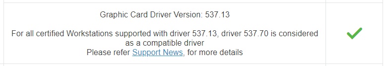

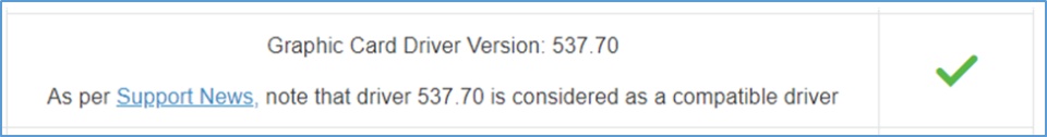

Graphics card driver version change:
For all certified Workstations supported with driver 537.13 driver, driver 537.70 is considered a compatible driver.
For all certified Configurations for VDI supported with driver VGPU 16.1 (537.13 driver)  driver 16.2 (537.70) is considered as a compatible driver.
New version of Cloud Eligibility Checker Tool (v1.6.01) does take all of these changes into account (refer to image 3.1 and image 3.2)
                                                                   (image 3.1)
                                                                    (image 3.2)
