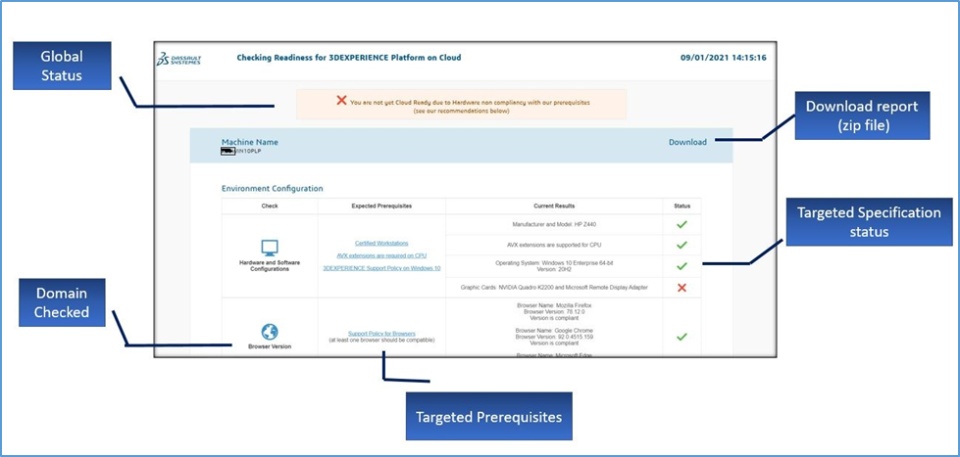

New Version of 3DEXPERIENCE Cloud Eligibility Tool (1.5.09) is available
The 3DEXPERIENCE Cloud Eligibility Tool is a tool to automate Dassault Systèmes prerequisite checks on your machine to optimize your 3DEXPERIENCE platform on Cloud experience.
See this previous article for earlier improvement.
Version 1.5.09 is available for download here.
The upgrade for the 3DEXPERIENCE platform on Cloud to the 3DEXPERIENCE R2023x FD04 level is now complete.
In line with this upgrade, a new version of the 3DEXPERIENCE Cloud Eligibility Tool is also released to take into account the changes pertaining to this level.
This new and updated version of the tool includes a couple of improvements as well as a few changes. A brief summary of all the important changes done during this upgrade is highlighted below:

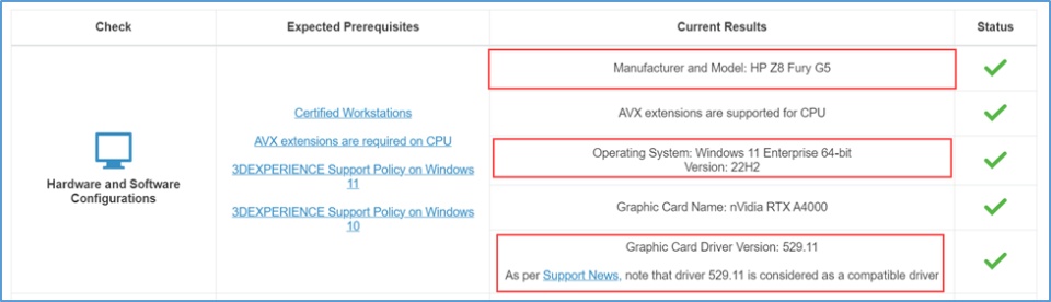

Changes in Hardware and Software Configurations:
Graphics cards:
>> For all certified Workstations supported with driver 528.24 driver, driver 529.11 is considered as a compatible driver. Please refer to Support News, for more details.
>> For all certified Configurations for VDI supported with driver VGPU 15.2 (528.89 driver) driver 15.3 (529.11) is considered as a compatible driver. Please refer to Support News, for more details.
List of all those certified workstations are available on Certified Workstations Webpage and list of all certified VDI are available on Certified Configurations for VDI Webpage.
Operating Systems:
>> For 3DEXPERIENCE platform on Cloud, Windows version 22H2 (x64) is now certified for both Windows 11 and Windows 10. All the details about certified versions are as per the below:
  1. Windows 11
    Windows 11 Enterprise, Version 22H2 (x64): Validated
    Windows 11 Pro, Version 22H2 (x64): Compatible
    Windows 11 Pro for Workstations, Version 22H2 (x64): Compatible
    Please refer support policy on Windows 11 here.
  2. Windows 10
    Windows 10 Enterprise, Version 22H2 (x64): Validated
    Windows 10 Pro, Version 22H2 (x64): Compatible
    Windows 10 Pro for Workstations, Version 22H2 (x64): Compatible
    Please refer support policy on Windows 10 here.
Certified Workstations:
>>There are some new workstations, which has been certified for supporting the 3DEXPERIENCE Platform on Cloud. These workstations are updated into the Certified Workstations List. An easy access to the same has been provided in the Cloud Eligibility Tool itself by hyperlinking it in the Expected Prerequisites column for the Hardware and Software Configurations check.
For all the above changes done into HW & SW configuration, Cloud Eligibility Checker tool does take them into account, as per below:

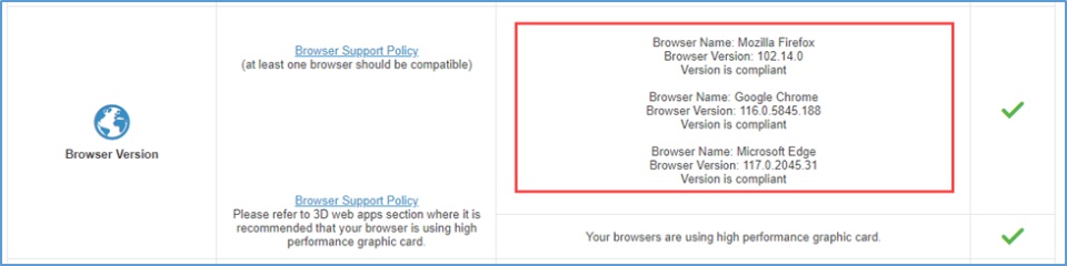

Changes in Browser Version:
As per the Platform Support Policy, The most current stable channel release of the Google Chrome and Microsoft Edge Chromium, is a Compatible Platform. For Mozilla Firefox 102esr is a validated and compatible platform. Please upgrade your browsers to the channel releases as per below:
Google Chrome:
The most current stable channel release of the Google Chrome is Version 116.0.5845.141 (Official Build) (64-bit). Your browser version should be greater than or equal to above mentioned channel release to be compatible with platform.
Microsoft Edge Chromium:
The most current stable channel release of the Microsoft Edge Chromium is Version 116.0.1938.69 (Official build) (64-bit). Your browser version should be greater than or equal to above mentioned channel release to be compatible with platform.
Mozilla Firefox:
For 64-bit Mozilla Firefox 102esr is a Validated Platform and For 32-bit Mozilla Firefox 102esr is a Compatible Platform.
Cloud Eligibility Checker Tool does take these changes into account, as per below:
Moreover, the usual changes related to the Upgrade have also been done in the tool. To name a few, the support for browser versions is streamlined as per the current stable release, the list of supported levels for 3DEXPERIENCE Open Software has been accordingly revised as per the newly introduced levels and so on… and also some improvements are done in the messages shown in Network Performance Change for better understandings of the check.
