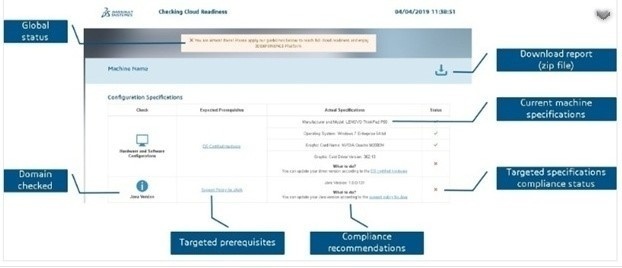

The Cloud Eligibility Tool is capable of generating an output file (in the form of .csv) alongside the html report each time it is executed.
By default, these files can be retrieved from %Temp%\\cloud directory (C:\\Users\\<>\\AppData\\Local\\Temp\\cloud)
This new version of the Cloud Eligibility Tool includes an enhancement allowing users to retrieve these files from a user-defined location. The same has been made possible by using the command line option “–p”. This option takes in the folder path as an input parameter.

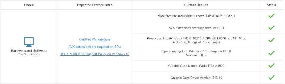

Changes in Hardware and Software Configurations:
The driver version “513.46” is validated for a few workstations. The tool takes into account this driver version.
In addition to this, the “Windows 11” OS has as well made it to the list of certified OS for the current level. You may refer to Dassault Systèmes Hardware and Software page for more information in this regard.
Moreover, the usual changes related to the Upgrade have also been done in the tool. To name a few, the list of certified workstations is updated and the support for browser versions is streamlined as per the current stable release. Along with this, the list of supported levels for 3DEXPERIENCE Open Software has been accordingly revised as per the newly introduced levels.
