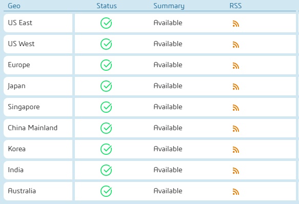

New command-line option -geo “<>”:
The command-line option “-geo” is capable of specifying the "Geo" as a command-line argument.
The apt "Geo" to be entered can be found from the table displaying the 3DEXPERIENCE platform on cloud LIVE status for Customer (example: "China Mainland", "Australia", "US West", etc)
Note that this -geo "Geo" command-line option can be considered to be an extension of the -dc option wherein the capability of selecting the "Geo" from the dropdown menu is required.
The benefit of this newly introduced command-line option over its counterpart is in minimizing the user interaction involved in explicitly selecting the proper "Geo" from the appeared panel. It can also prove advantageous when the user wishes to execute the tool in silent mode.
The Network Performance computation will be based on the location specified as the parameter for this option

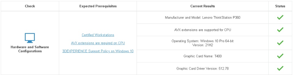

Graphic Card Driver Version "512.78":
The driver version 512.78 is validated for a few workstations. The tool takes into account this driver version:
You may refer to Dassault Systèmes Hardware and Software page for more information in this regard.

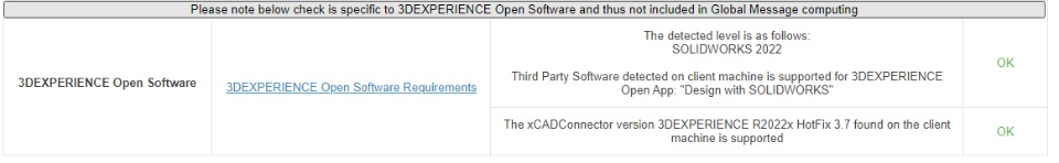

JAVA is no longer a prerequisite for Design with SOLIDWORKS:
Starting from FD04, JAVA is no longer a prerequisite for "Design with SOLIDWORKS".
For more information, you can refer to the 3DEXPERIENCE Open Software Requirements page in the Program Directories
Accordingly, this check has been removed in case SOLIDWORKS is detected on the client's machine
