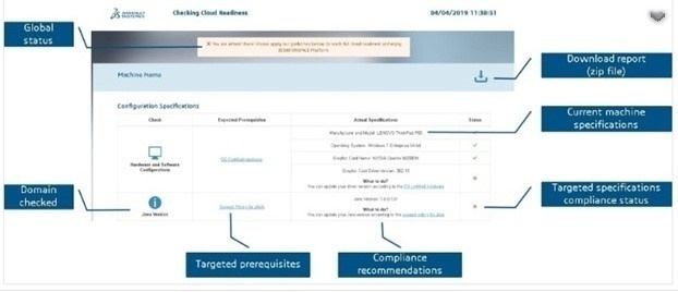

Enhancements:
A couple of enhancements that will help automate the execution of the Cloud Eligibility Checker are promoted during this upgrade. These enhancements will make the tool capable enough to save the result in .csv format as well as be executed in silent mode without any user interaction. The detailed information regarding the same can be found below:
Output in the form of .csv file:
  • ​​​​​​​The Cloud Eligibility Checker Tool is improved such that an output file (in the form of .csv file) will be generated each time it is executed
  • This file will comprise of just 2 columns, viz. the Check and its respective Status. For the ease of processing and analyzing this file, the machine name and global status are also included in it
  • You will be able to retrieve this file from %Temp%\\cloud directory
    (C:\\Users\\<>\\AppData\\Local\\Temp\\cloud)
  • Note that this file will be generated in addition to the HTML report that gets displayed currently when the Cloud Eligibility Checker Tool is executed

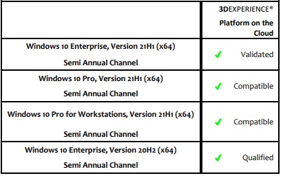

Support Policy for Windows 10:
A few changes have been implied in the Support Policy for Windows 10 for the 3DEXPERIENCE platform On Cloud.
Currently, only two versions i.e. Windows 10 Version 21H1 and Windows 10 Version 20H2 are considered supported. The older version 1909 is no longer supported for the 3DEXPERIENCE platform On Cloud.
The Cloud Eligibility Checker Tool takes into consideration all these changes.
