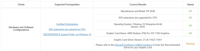

Summary of changes implemented in 3DEXPERIENCE Cloud Eligibility Checker (1.4.64):
The 3DEXPERIENCE platform on Cloud has been upgraded to the 3DEXPERIENCE R2022x FD02 level. To be in line with this upgrade, the Cloud Eligibility Checker Tool is also improved considering multiple aspects. This new and updated version of the tool includes a few new features, enhancements, and bug fixes as well.
A brief summary of all the alterations done during this upgrade can be found below:

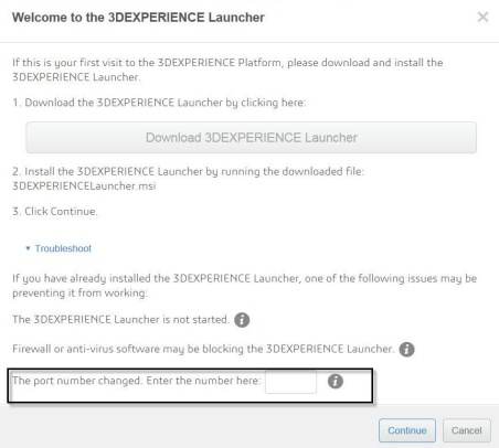

3DEXPERIENCE Launcher:
The 3DEXPERIENCE Launcher now supports the http protocol. The tree ports potentially used for http are: 20250, 33150, 44550
The Cloud Eligibility Checker Tool is modified to take into account these default http ports used by the 3DEXPERIENCE Launcher.
Note that a different port number can be added in the troubleshooting panel whenever the default ports are blocked or unavailable. You may refer to the "3DEXPERIENCE Launcher" paragraph in the Upgrade Guide for more details

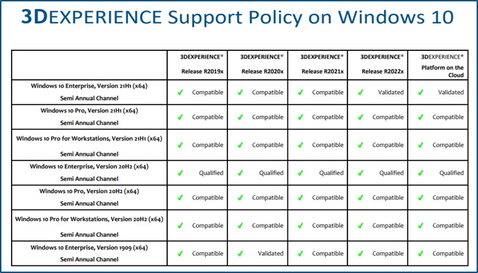

Support Policy for Windows 10:
A few changes have been implied in the Support Policy for Windows 10 for the 3DEXPERIENCE platform On Cloud.
The Windows 10 Version 21H1 (i.e. Version 2009) was added to the list of certified Windows 10 OS Versions. Older versions like 1803 and 1809 are no longer supported for the 3DEXPERIENCE platform On Cloud.
The Cloud Eligibility Checker Tool takes into consideration all these changes.
