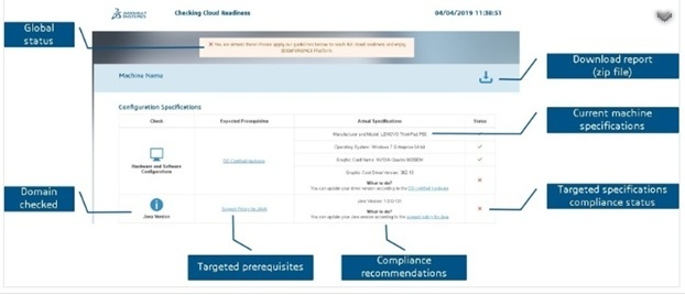

The 3DEXPERIENCE Cloud Eligibility Checker is a tool to automate DASSAULT Systèmes prerequisite checks on your machine in order to optimize your 3DEXPERIENCE platform on Cloud experience.

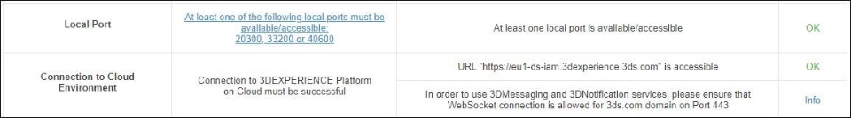

Port 443:
The Network Firewall check consisted of a sub-check wherein the availability of remote port 443 was being checked on basis of WebSocket connection. However, WebSocket connection in the context of the Cloud Connection URL was incorrect and has been resolved in the new version.
Secondly, https connection with Cloud Connection URL was already being confirmed in the check “Connection to Cloud Environment”. Thus, the Network Firewall check has been modified to just confirm the availability of local ports. (This check is accordingly renamed as Local Ports)
In addition to this, advice has been added to have WebSocket connection open on port 443 in case the user wants to use 3DMessaging and 3DNotification services.
