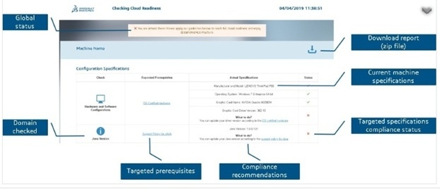

New Version of 3DEXPERIENCE Cloud Eligibility Checker (0.1.4.61) is available
The 3DEXPERIENCE Cloud Eligibility Checker is a tool to automate DASSAULT Systèmes prerequisite checks on your machine in order to optimize your 3DEXPERIENCE Platform on Cloud experience.
See this previous article for earlier improvement.
 Version 0.1.4.61 is available for download here
The 3DEXPERIENCE Platform on Cloud has been upgraded to the FD07 level. To keep up with this upgrade, the Cloud Eligibility Checker Tool is also refined. This new and updated version of the tool includes various new features and enhancements
A brief summary of all the alterations done during this upgrade can be found below:
Improvisations:
Integration of AVX extensions:
From the R2021x FD05 level, the Program Directories mention that AVX extensions are required on the CPU. Earlier, this prerequisite was added just as a note in the Cloud Eligibility Checker Tool.
The current version has been improvised to include a check confirming AVX extensions. This check is a part of the Hardware and Software Configurations check
SOLIDWORKS Connected:
The Cloud Eligibility Checker Tool is now capable of detecting the version of SOLIDWORKS Connected as well. This check is specifically targeted for customers working with XWC License role.Notice that in case 3DEXPERIENCE Native apps are not installed, we are displaying this second check. Please refer QA00000070322 for more details

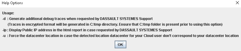

Command-Line Options:
Earlier, there was no command-line option for the tool. Now the behavior of the tool has been improvised to take into account the -h\\-help option and accordingly display the help for various command-line options.Also, a proper warning message occurs when any invalid command-line option is being used
Additional Features:
A couple of additional features have also been implemented in the tool.
Display of Public IP Address (governed by command-line option “-ip”):
The tool is now capable of displaying the “Public IP Address” in the html report. This feature is governed by command-line option”-ip”
