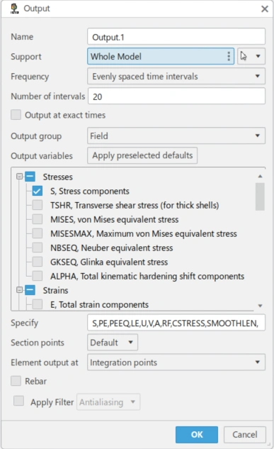

In both ABAQUS and 3DEXPERIENCE SIMULIA (platform), Field Outputs are quantities stored at every increment/time step over the spatial domain (nodes/elements/integration points/surfaces) of your model.
They are different from History Outputs, which are recorded at discrete locations (points, sets, or surfaces) and over time (like reaction forces, displacement at a node, etc.).
Common Field Outputs
U → Displacements at nodes
V → Velocities
A → Accelerations
S → Stresses at integration points
E → Strains
PEEQ → Equivalent plastic strain
LE → Logarithmic strain
TEMP → Temperature field
COORD → Deformed coordinates
RF → Reaction forces at constrained DOFs
CF → Contact forces
These are spatially distributed fields you can visualize as contour plots in Abaqus/CAE or 3DEXPERIENCE (SIMULIA Physics Results Explorer app).
