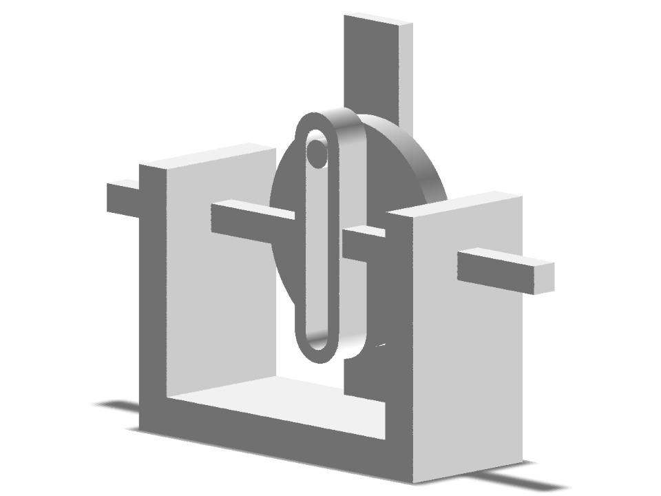

Hello everybody! I'd like to share a model on Scotch Yoke Mechanism that me and my team made  as a  project given for an internship.

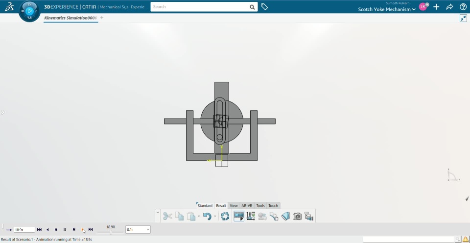

In that I came across 3DEXPERIENCE software and get to learn new things about software.

The Scotch Yoke also known as slotted link mechanism is a reciprocating motion mechanism, converting the linear motion of a slider into rotational motion, or vice versa. The piston or other reciprocating part is directly coupled to a sliding yoke with a slot that engages a pin on the rotating part. The location of the piston versus time is simple harmonic motion, i.e., a sine wave having constant amplitude and constant frequency, given a constant rotational speed.
