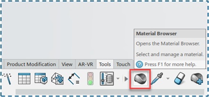

You can access the available materials in the Material Browser from Apps like Part Design, Assembly Design. (Bottom Bar> Tools Section> Material Browser.)
Your teacher, friends, team-mates may have already created or imported some materials.
If Materials exist in any Collaborative Space accessible to you, you will see them here.
Material Browser is a tool that allows you to quickly apply a core or covering material
or a material vector to a product in any app. (Formerly called materials palette).

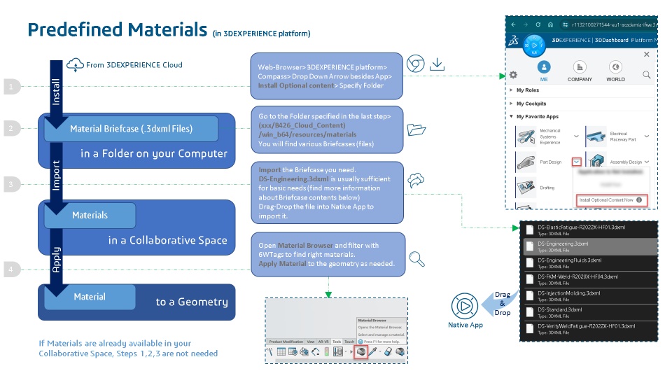

How to Avail the Predefined Materials?
Process involves 3 steps-
1) Install the Material Briefcase- (The required .3dxml files will get downloaded from the 3DEXPERIENCE Cloud Server to a folder on your computer)
Click the arrow next to your app icons, click "Install Optional Content Now"
(For example- arrow on the right side of Part Design App in Compass under My Apps),
Complete the Installation.
Optional Content includes the Material Briefcases. If you have already installed Optional Content, you will not see the "Install Optional Content Now" option. You can proceed to step 2.
2) Find the Material Briefcases in your folder-
Navigate to the folder on your computer where you have installed the Optional Content from previous step (xxx/B426_Cloud_Content), /win_b64/resources/materials
There are several .3dxml files containing material data.
3) Import the Material Briefcases you need-
Identify the Material Briefcases you need. Check the table at the end of this post to understand the contents.
Depending on your requirement, import one or more of these materials files into your Collaborative Space.
The DS-Engineering.3dxml file should be sufficient for most basic needs. Other files contain materials for performing specific types of simulations like fluid flow, metal fatigue etc.
Launch the 3DEXPERIENCE platform Native App (If you don't have a session running already 😄 !) Drag and Drop the .3dxml file into the 3DEXPERIENCE platform Native App window and complete the import.
4) You are now ready to Apply materials to your Products!
Wait for a short while for indexing to complete. Apply materials to your Products!
